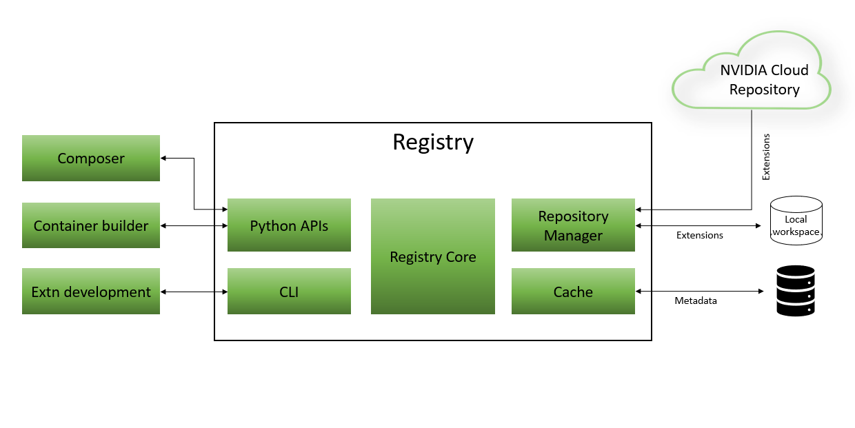

The Registry is an integral part of the Graph Composer ecosystem and is responsible for providing unified interface between the extensions and tools. Registry service can be accessed using registry CLI:
In the backend, Registry communicates with Nvidia Cloud repository and Local workspace for extension management while it uses local database as cache of extension metadata.
Repository Manager
Repository manager is responsible to communicating with NVIDIA Cloud repository or local workspace based on operation or arguments to operation.

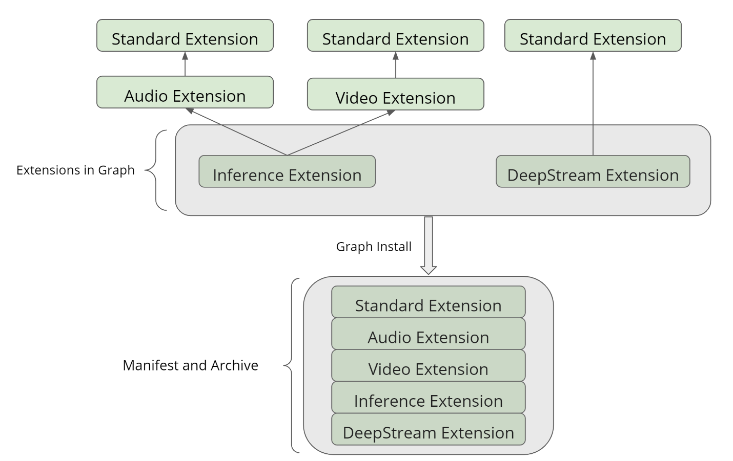

Installing graphs for deployment

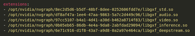

The registry can also be used to deploy graphs locally or containerize the graph using container builder. To execute a graph using gxe, the registry provides a functionality to prepare a manifest and a corresponding archive package containing all the extensions that are required.
An example manifest for the sample graph above is shown here:
An example archive for the sample graph above is shown here:

command in the CLI tool along with the target platform configuration that decides the variant of the extensions that should be used to for deployment. Registry will auto select the best matching variant for each extension based on the target platform.The output of the graph install command is a gxe manifest along with an archive which contains all the extension libraries and files that were packaged with the extension variant.

to view all the arguments that are supported.All the extensions used in the graph must be present in the registry’s local cache to install the graph successfully. The version of the extension used in the graph must also match the versions of the extension found in the registry cache.
Suppose an extension A is listed as a dependency for extension B and extension C. If a graph is created using extensions B and extension C, it needs to be ensured that both B and C are dependent on the same version of extension A and that version of extension A should be synchronized with the registry to install the graph. Using multiple versions of the same extension in a graph is not supported and is not advisable to create such dependencies.
The registry performs version management while installing graphs to ensure the latest versions of extensions are being deployed. Suppose a graph was created using version 1.0.0 of extension A, while there was a newer version of extension 1.1.0 available during
graph install
stage. It is ensured only the latest minor.patch version corresponding to the same major of the extension is added in the archive.
