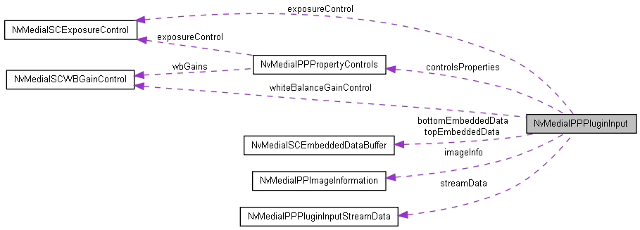

Holds Control Algorithm plugin input parameters.
Definition at line 785 of file nvmedia_ipp.h.
Data Fields | |
| NvMediaIPPImageInformation | imageInfo |
| Image information. More... | |
| NvMediaIPPPropertyControls * | controlsProperties |
| A pointer to properties that determine the operation mode of the Plugin Control Algorithm. More... | |
| NvMediaISCExposureControl | exposureControl |
| Holds exposure control values associated with the currently processed image. More... | |
| NvMediaISCWBGainControl | whiteBalanceGainControl [2] |
| Holds the two sets of white balance gain control values, one associated with sensor before hdr merge and other associated with ISP after hdr merge. More... | |
| NvMediaISCEmbeddedDataBuffer | topEmbeddedData |
| Holds top embedded data of current image. More... | |
| NvMediaISCEmbeddedDataBuffer | bottomEmbeddedData |
| Holds bottom embedded data of current image. More... | |
| NvMediaIPPPluginInputStreamData | streamData [NVMEDIA_IPP_STREAM_MAX_TYPES] |
| Holds an array of NvMediaIPPPluginInputStreamData. More... | |
| NvMediaBool | firstRun |
| Holds first run flag. More... | |
| float_t | brightness |
| Holds scene brightness. More... | |
