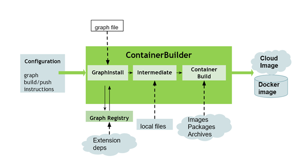

Container Builder (CB) is used to build docker images for AI Application graphs created using Composer. In addition to docker images, it can also push the final image into the cloud for deployment.
Container Builder interacts with Registry: to:
Download extensions and other related files into your local system.
Copy other required files specified in the config file to generate an intermediate work folder and an optimized dockerfile.
Convert archives/packages dependencies and instructions into docker and try to build a minimal sized local image. For optimization, you can easily configure container builder to support multi-stage docker build.
