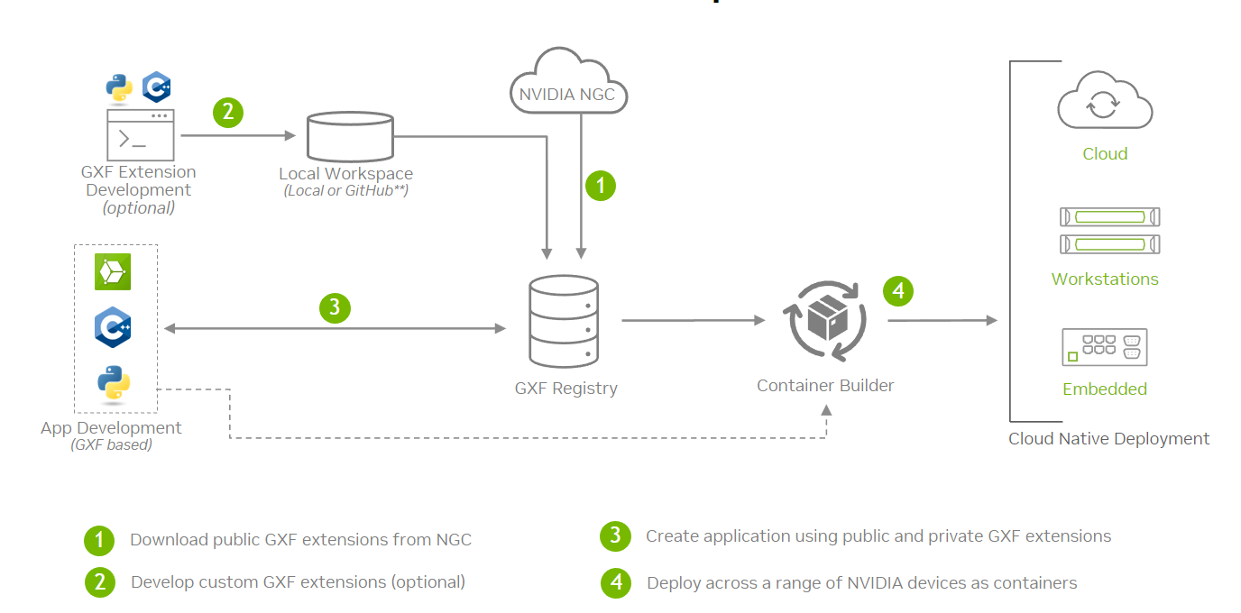

This workflow is for custom extension developers. It allows developers to implement new functionality and add business logic to applications through graph.
There are two options to for developing extensions and application graphs:
Native workstation
DeepStream SDK devel container image

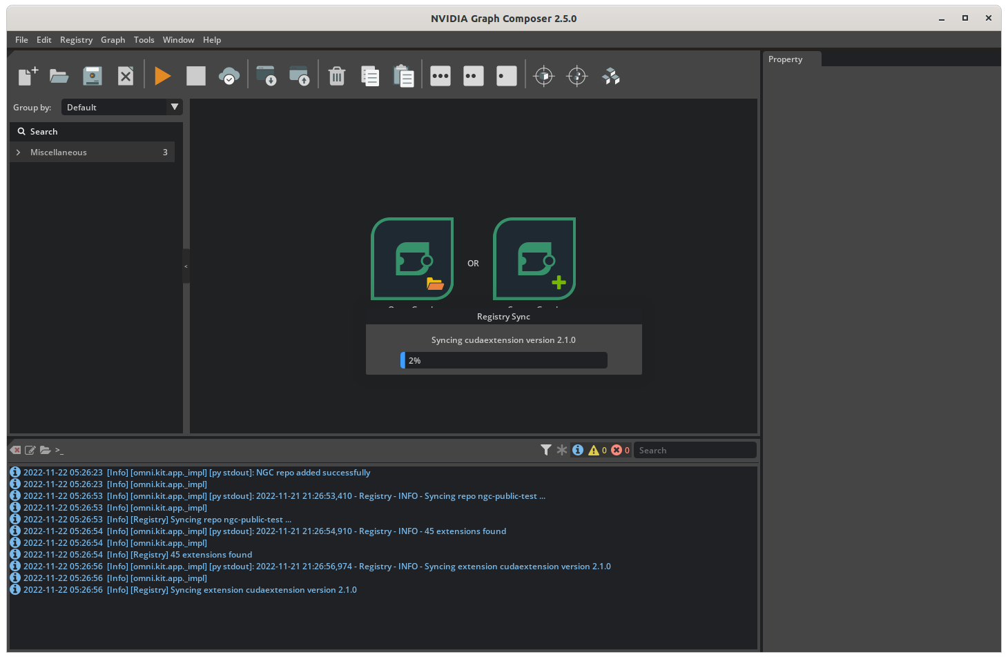

Using Composer UI¶

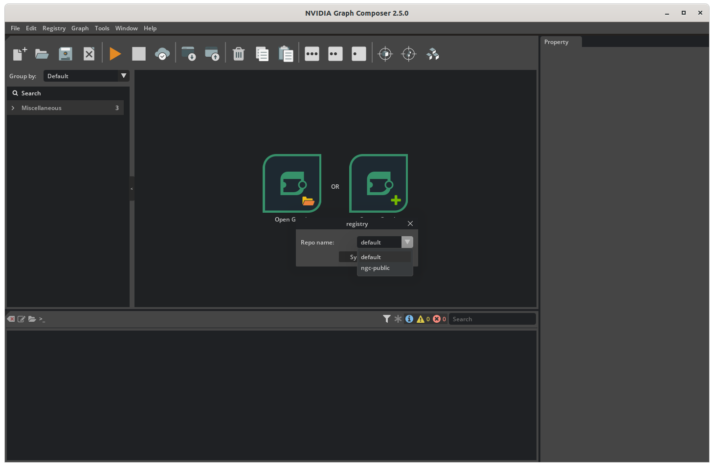

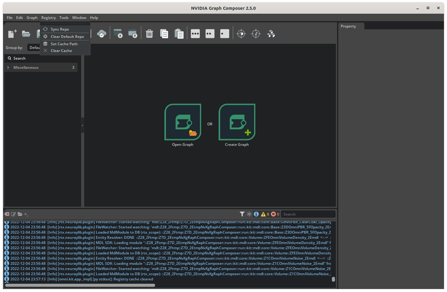

Open the Registry menu from the menubar at the top and click on Sync Repo
Select ngc-public from the drop-down list and click on Sync

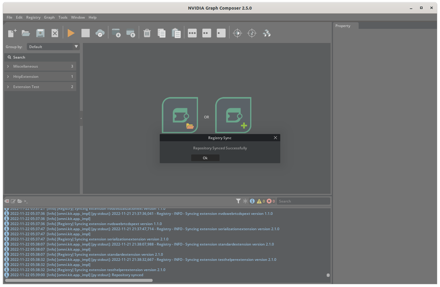

Composer will report the current status using a progress bar

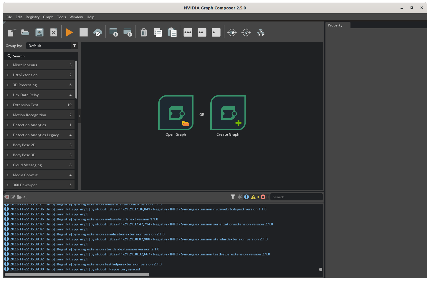

Once the extension sync is complete, composer will display a success message.
On clicking close, composer will automatically refresh component list and the refreshed list can be seen in the component list window on the right

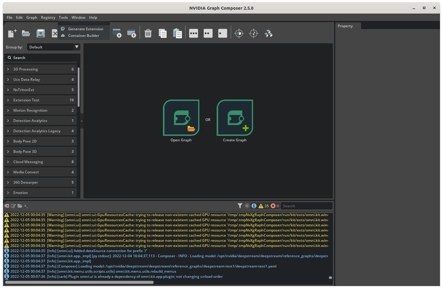

Using Composer UI¶
Composer UI currently supports generating DeepStream (GStreamer) based extensions only.
Note
If the Deepstream SDK package is not installed, Generate Extension button will be disabled.

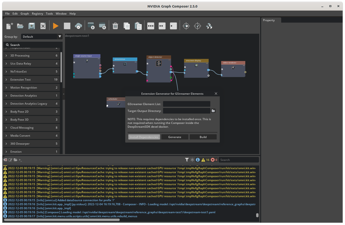

To start, open the Tools menu from the menubar at the top and select Generate Extension.
This will launch the Extension Generator dialog. The extension generator needs some dependencies to be installed.
This can be done by clicking on the Install Dependencies button. This only needs to be done once on a machine. This
is not required when running from the DeepStreamSDK development docker since the dependencies pre-installed.
Next, type in the comma-separated list of GStreamer elements for which corresponding extensions must be generated. Select the output directory using the file browser.
Click on Generate first to generate the extension source code at the selected directory and then
Build to build and register the extensions. The progress will be reported via logs in the console
window.

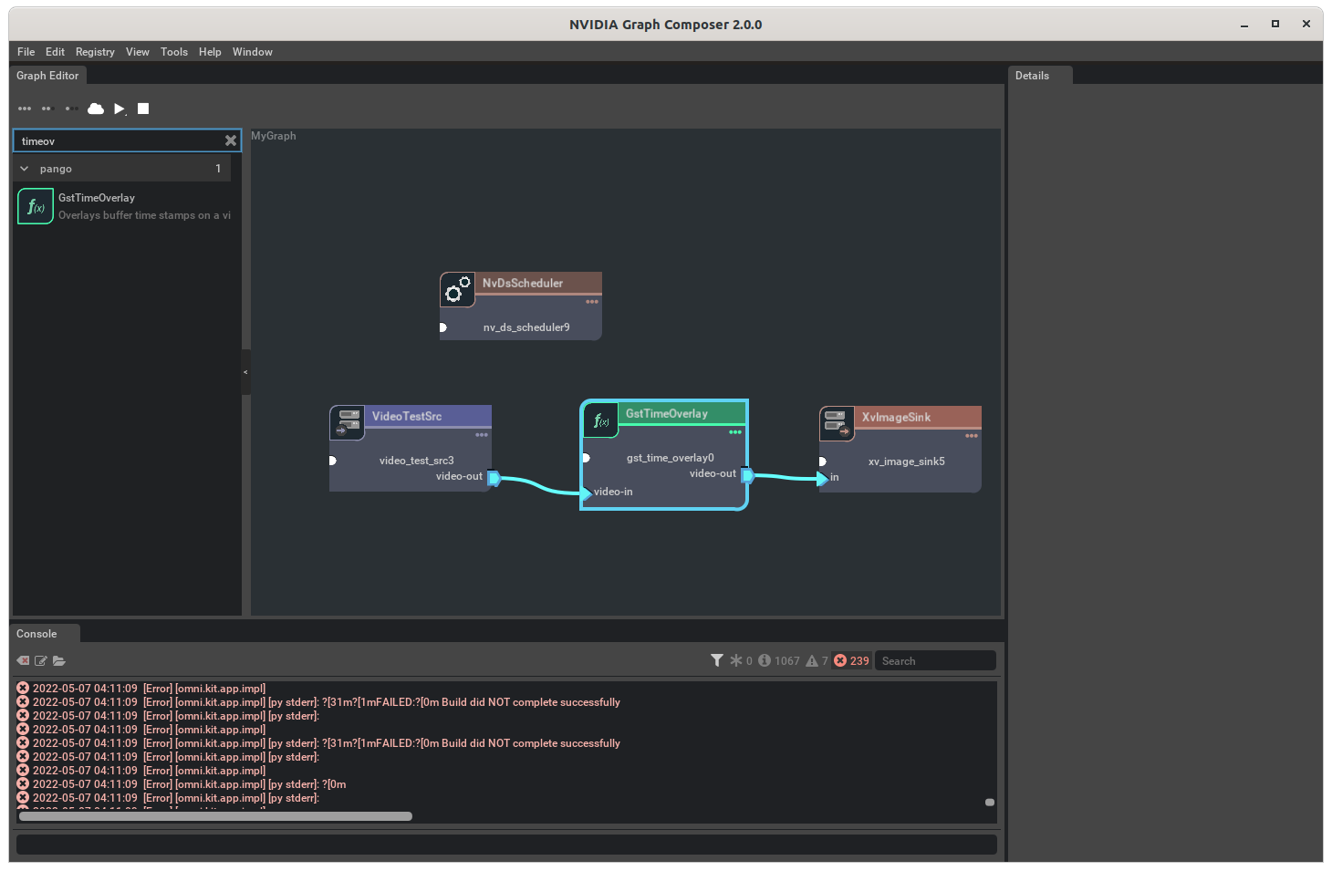

After extension build is done, newly added extensions will appear in the component list
Create and test graph¶
Drag and drop newly created components from the component list to the graph window and link to other components to create a complete application.
Save and execute the graph as demonstrated in Application Workflow
