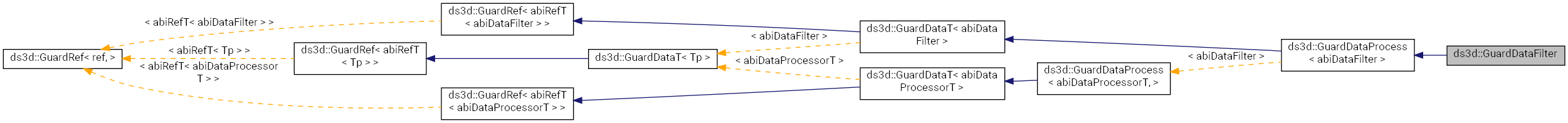

Inheritance diagram for ds3d::GuardDataFilter:
Collaboration diagram for ds3d::GuardDataFilter:
