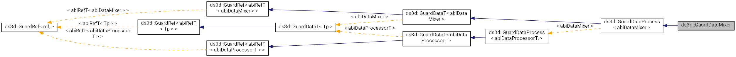

Inheritance diagram for ds3d::GuardDataMixer:
Collaboration diagram for ds3d::GuardDataMixer:
