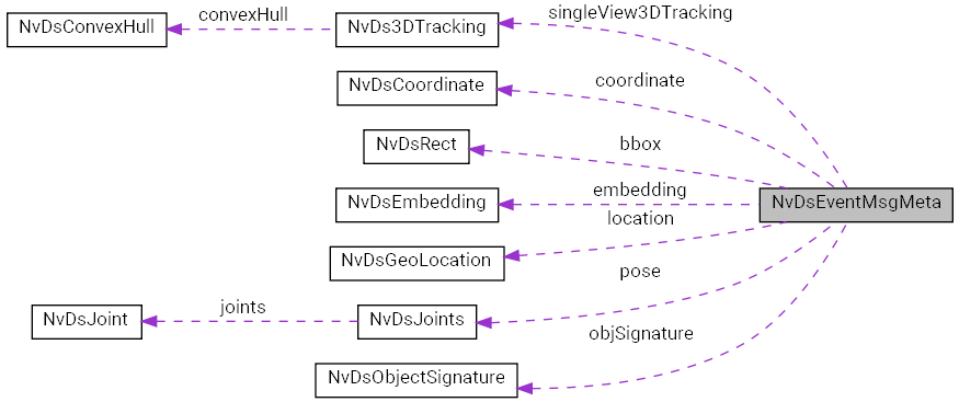

Collaboration diagram for NvDsEventMsgMeta:
