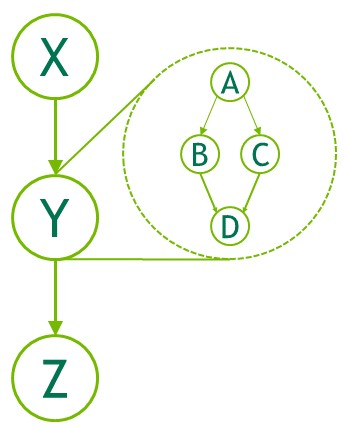

A graph node can be one of:
Child Graph Example
Figure 21 Child Graph Example#

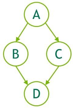

The following is an example (omitting declarations and other boilerplate code) of creating the below graph. Note the use of cudaGraphCreate() to create the graph and cudaGraphAddNode() to add the kernel nodes and their dependencies. The CUDA Runtime API documentation lists all the functions available for adding nodes and dependencies.
Creating a Graph Using Graph APIs Example
Figure 22 Creating a Graph Using Graph APIs Example#
// Create the graph - it starts out empty
cudaGraphCreate(&graph, 0);
// Create the nodes and their dependencies
cudaGraphNode_t nodes[4];
cudaGraphNodeParams kParams = { cudaGraphNodeTypeKernel };
kParams.kernel.func         = (void *)kernelName;
kParams.kernel.gridDim.x    = kParams.kernel.gridDim.y  = kParams.kernel.gridDim.z  = 1;
kParams.kernel.blockDim.x   = kParams.kernel.blockDim.y = kParams.kernel.blockDim.z = 1;
cudaGraphAddNode(&nodes[0], graph, NULL, NULL, 0, &kParams);
cudaGraphAddNode(&nodes[1], graph, &nodes[0], NULL, 1, &kParams);
cudaGraphAddNode(&nodes[2], graph, &nodes[0], NULL, 1, &kParams);
cudaGraphAddNode(&nodes[3], graph, &nodes[1], NULL, 2, &kParams);
The example above shows four kernel nodes with dependencies between them to illustrate the creation of a very simple graph. In a typical user application there would also need to be nodes added for memory operations, such as cudaGraphAddMemcpyNode() and the like. For full reference of all graph API functions to add nodes, see The CUDA Runtime API documentation .

// stream1 is the origin stream
cudaStreamBeginCapture(stream1);
kernel_A<<< ..., stream1 >>>(...);
// Fork into stream2
cudaEventRecord(event1, stream1);
cudaStreamWaitEvent(stream2, event1);
kernel_B<<< ..., stream1 >>>(...);
kernel_C<<< ..., stream2 >>>(...);
// Join stream2 back to origin stream (stream1)
cudaEventRecord(event2, stream2);
cudaStreamWaitEvent(stream1, event2);
kernel_D<<< ..., stream1 >>>(...);
// End capture in the origin stream
cudaStreamEndCapture(stream1, &graph);
// stream1 and stream2 no longer in capture mode
The graph returned by the above code is shown in Figure 22.

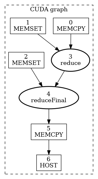

4.2.2.1.3. Putting It All Together#
The example in Figure 22 is a simplistic example intended to show a small graph conceptually. In an application that utilizes CUDA graphs, there is more complexity to using either the graph API or stream capture. The following code snippet shows a side by side comparison of the Graph API and Stream Capture to create a CUDA graph to execute a simple two stage reduction algorithm.
Figure 23 is an illustration of this CUDA graph and was generated using the cudaGraphDebugDotPrint function applied to the code below, with small adjustments for readability, and then rendered using Graphviz.
CUDA graph example using two stage reduction kernel
Figure 23 CUDA graph example using two stage reduction kernel#
void cudaGraphsManual(float  *inputVec_h,
                      float  *inputVec_d,
                      double *outputVec_d,
                      double *result_d,
                      size_t  inputSize,
                      size_t  numOfBlocks)
   cudaStream_t                 streamForGraph;
   cudaGraph_t                  graph;
   std::vector<cudaGraphNode_t> nodeDependencies;
   cudaGraphNode_t              memcpyNode, kernelNode, memsetNode;
   double                       result_h = 0.0;
   cudaStreamCreate(&streamForGraph));
   cudaKernelNodeParams kernelNodeParams = {0};
   cudaMemcpy3DParms    memcpyParams     = {0};
   cudaMemsetParams     memsetParams     = {0};
   memcpyParams.srcArray = NULL;
   memcpyParams.srcPos   = make_cudaPos(0, 0, 0);
   memcpyParams.srcPtr   = make_cudaPitchedPtr(inputVec_h, sizeof(float) * inputSize, inputSize, 1);
   memcpyParams.dstArray = NULL;
   memcpyParams.dstPos   = make_cudaPos(0, 0, 0);
   memcpyParams.dstPtr   = make_cudaPitchedPtr(inputVec_d, sizeof(float) * inputSize, inputSize, 1);
   memcpyParams.extent   = make_cudaExtent(sizeof(float) * inputSize, 1, 1);
   memcpyParams.kind     = cudaMemcpyHostToDevice;
   memsetParams.dst         = (void *)outputVec_d;
   memsetParams.value       = 0;
   memsetParams.pitch       = 0;
   memsetParams.elementSize = sizeof(float); // elementSize can be max 4 bytes
   memsetParams.width       = numOfBlocks * 2;
   memsetParams.height      = 1;
   cudaGraphAddMemcpyNode(&memcpyNode, graph, NULL, 0, &memcpyParams);
   cudaGraphAddMemsetNode(&memsetNode, graph, NULL, 0, &memsetParams);
   nodeDependencies.push_back(memsetNode);
   nodeDependencies.push_back(memcpyNode);
   void *kernelArgs[4] = {(void *)&inputVec_d, (void *)&outputVec_d, &inputSize, &numOfBlocks};
   kernelNodeParams.func           = (void *)reduce;
   kernelNodeParams.gridDim        = dim3(numOfBlocks, 1, 1);
   kernelNodeParams.blockDim       = dim3(THREADS_PER_BLOCK, 1, 1);
   kernelNodeParams.sharedMemBytes = 0;
   kernelNodeParams.kernelParams   = (void **)kernelArgs;
   kernelNodeParams.extra          = NULL;
   cudaGraphAddKernelNode(
      &kernelNode, graph, nodeDependencies.data(), nodeDependencies.size(), &kernelNodeParams);
   nodeDependencies.clear();
   nodeDependencies.push_back(kernelNode);
   memset(&memsetParams, 0, sizeof(memsetParams));
   memsetParams.dst         = result_d;
   memsetParams.width       = 2;
   memset(&kernelNodeParams, 0, sizeof(kernelNodeParams));
   kernelNodeParams.func           = (void *)reduceFinal;
   kernelNodeParams.gridDim        = dim3(1, 1, 1);
   void *kernelArgs2[3]            = {(void *)&outputVec_d, (void *)&result_d, &numOfBlocks};
   kernelNodeParams.kernelParams   = kernelArgs2;
   memset(&memcpyParams, 0, sizeof(memcpyParams));
   memcpyParams.srcPtr   = make_cudaPitchedPtr(result_d, sizeof(double), 1, 1);
   memcpyParams.dstPtr   = make_cudaPitchedPtr(&result_h, sizeof(double), 1, 1);
   memcpyParams.extent   = make_cudaExtent(sizeof(double), 1, 1);
   memcpyParams.kind     = cudaMemcpyDeviceToHost;
   cudaGraphAddMemcpyNode(&memcpyNode, graph, nodeDependencies.data(), nodeDependencies.size(), &memcpyParams);
   cudaGraphNode_t    hostNode;
   cudaHostNodeParams hostParams = {0};
   hostParams.fn                 = myHostNodeCallback;
   callBackData_t hostFnData;
   hostFnData.data     = &result_h;
   hostFnData.fn_name  = "cudaGraphsManual";
   hostParams.userData = &hostFnData;
   cudaGraphAddHostNode(&hostNode, graph, nodeDependencies.data(), nodeDependencies.size(), &hostParams);

   cudaMemsetAsync(outputVec_d, 0, sizeof(double) * numOfBlocks, stream2);
   cudaEventRecord(memsetEvent1, stream2);
   cudaMemsetAsync(result_d, 0, sizeof(double), stream3);
   cudaEventRecord(memsetEvent2, stream3);
   cudaStreamWaitEvent(stream1, memsetEvent1, 0);
   reduce<<<numOfBlocks, THREADS_PER_BLOCK, 0, stream1>>>(inputVec_d, outputVec_d, inputSize, numOfBlocks);
   cudaStreamWaitEvent(stream1, memsetEvent2, 0);
   reduceFinal<<<1, THREADS_PER_BLOCK, 0, stream1>>>(outputVec_d, result_d, numOfBlocks);
   cudaMemcpyAsync(&result_h, result_d, sizeof(double), cudaMemcpyDefault, stream1);
   callBackData_t hostFnData = {0};
   hostFnData.fn_name        = "cudaGraphsUsingStreamCapture";
   cudaHostFn_t fn           = myHostNodeCallback;
   cudaLaunchHostFunc(stream1, fn, &hostFnData);

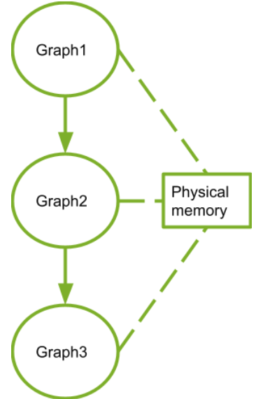

Graph memory nodes allow graphs to create and own memory allocations. Graph memory nodes have GPU ordered lifetime semantics, which dictate when memory is allowed to be accessed on the device. These GPU ordered lifetime semantics enable driver-managed memory reuse, and match those of the stream ordered allocation APIs cudaMallocAsync and cudaFreeAsync, which may be captured when creating a graph.
Graph allocations have fixed addresses over the life of a graph including repeated instantiations and launches. This allows the memory to be directly referenced by other operations within the graph without the need of a graph update, even when CUDA changes the backing physical memory. Within a graph, allocations whose graph ordered lifetimes do not overlap may use the same underlying physical memory.
CUDA may reuse the same physical memory for allocations across multiple graphs, aliasing virtual address mappings according to the GPU ordered lifetime semantics. For example when different graphs are launched into the same stream, CUDA may virtually alias the same physical memory to satisfy the needs of allocations which have single-graph lifetimes.

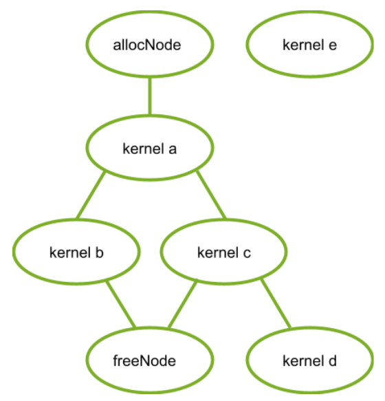

In the following figure, there is an example graph with an alloc and a free node. Kernel nodes a, b, and c are ordered after the allocation node and before the free node such that the kernels can access the allocation. Kernel node e is not ordered after the alloc node and therefore cannot safely access the memory. Kernel node d is not ordered before the free node, therefore it cannot safely access the memory.
Kernel Nodes
Figure 27 Kernel Nodes#
The following code snippet establishes the graph in this figure:
// parameters for a basic allocation
cudaGraphNodeParams params = { cudaGraphNodeTypeMemAlloc };
params.alloc.poolProps.allocType = cudaMemAllocationTypePinned;
params.alloc.poolProps.location.type = cudaMemLocationTypeDevice;
// specify device 0 as the resident device
params.alloc.poolProps.location.id = 0;
params.alloc.bytesize = size;
cudaGraphAddNode(&allocNode, graph, NULL, NULL, 0, &params);
// create a kernel node that uses the graph allocation
cudaGraphNodeParams nodeParams = { cudaGraphNodeTypeKernel };
nodeParams.kernel.kernelParams[0] = params.alloc.dptr;
// ...set other kernel node parameters...
// add the kernel node to the graph
cudaGraphAddNode(&a, graph, &allocNode, 1, NULL, &nodeParams);
cudaGraphAddNode(&b, graph, &a, 1, NULL, &nodeParams);
cudaGraphAddNode(&c, graph, &a, 1, NULL, &nodeParams);
cudaGraphNode_t dependencies[2];
// kernel nodes b and c are using the graph allocation, so the freeing node must depend on them.  Since the dependency of node b on node a establishes an indirect dependency, the free node does not need to explicitly depend on node a.
dependencies[0] = b;
dependencies[1] = c;
cudaGraphNodeParams freeNodeParams = { cudaGraphNodeTypeMemFree };
freeNodeParams.free.dptr = params.alloc.dptr;
cudaGraphAddNode(&freeNode, graph, dependencies, NULL, 2, freeNodeParams);
// free node does not depend on kernel node d, so it must not access the freed graph allocation.
cudaGraphAddNode(&d, graph, &c, NULL, 1, &nodeParams);
// node e does not depend on the allocation node, so it must not access the allocation.  This would be true even if the freeNode depended on kernel node e.
cudaGraphAddNode(&e, graph, NULL, NULL, 0, &nodeParams);

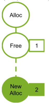

4.2.5.3.1. Address Reuse within a Graph#
CUDA may reuse memory within a graph by assigning the same virtual address ranges to different allocations whose lifetimes do not overlap. Since virtual addresses may be reused, pointers to different allocations with disjoint lifetimes are not guaranteed to be unique.
The following figure shows adding a new allocation node (2) that can reuse the address freed by a dependent node (1).
Adding New Alloc Node 2
Figure 28 Adding New Alloc Node 2#

4.2.5.3.2. Physical Memory Management and Sharing#
CUDA is responsible for mapping physical memory to the virtual address before the allocating node is reached in GPU order. As an optimization for memory footprint and mapping overhead, multiple graphs may use the same physical memory for distinct allocations if they will not run simultaneously; however, physical pages cannot be reused if they are bound to more than one executing graph at the same time, or to a graph allocation which remains unfreed.
CUDA may update physical memory mappings at any time during graph instantiation, launch, or execution. CUDA may also introduce synchronization between future graph launches in order to prevent live graph allocations from referring to the same physical memory. As for any allocate-free-allocate pattern, if a program accesses a pointer outside of an allocation’s lifetime, the erroneous access may silently read or write live data owned by another allocation (even if the virtual address of the allocation is unique). Use of compute sanitizer tools can catch this error.
The following figure shows graphs sequentially launched in the same stream. In this example, each graph frees all the memory it allocates. Since the graphs in the same stream never run concurrently, CUDA can and should use the same physical memory to satisfy all the allocations.
Sequentially Launched Graphs
Figure 30 Sequentially Launched Graphs#

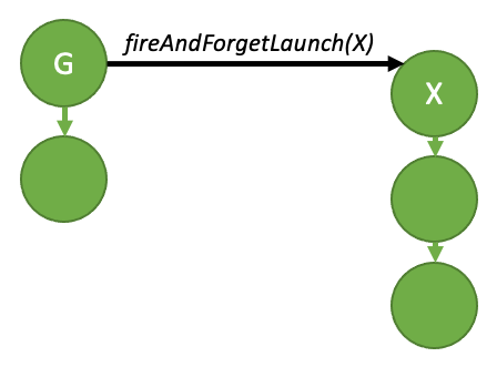

4.2.6.2.1. Fire and Forget Launch#
As the name suggests, a fire and forget launch is submitted to the GPU immediately, and it runs independently of the launching graph. In a fire-and-forget scenario, the launching graph is the parent, and the launched graph is the child.
../_images/fire-and-forget-simple.png
Figure 31 Fire and forget launch#
The above diagram can be generated by the sample code below:
__global__ void launchFireAndForgetGraph(cudaGraphExec_t graph) {
    cudaGraphLaunch(graph, cudaStreamGraphFireAndForget);
void graphSetup() {
    cudaGraphExec_t gExec1, gExec2;
    cudaGraph_t g1, g2;
    // Create, instantiate, and upload the device graph.
    create_graph(&g2);
    cudaGraphInstantiate(&gExec2, g2, cudaGraphInstantiateFlagDeviceLaunch);
    cudaGraphUpload(gExec2, stream);
    // Create and instantiate the launching graph.
    cudaStreamBeginCapture(stream, cudaStreamCaptureModeGlobal);
    launchFireAndForgetGraph<<<1, 1, 0, stream>>>(gExec2);
    cudaStreamEndCapture(stream, &g1);
    cudaGraphInstantiate(&gExec1, g1);
    // Launch the host graph, which will in turn launch the device graph.
    cudaGraphLaunch(gExec1, stream);
A graph can have up to 120 total fire-and-forget graphs during the course of its execution. This total resets between launches of the same parent graph.

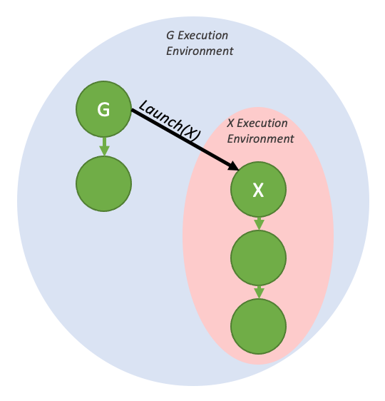

4.2.6.2.1.1. Graph Execution Environments#
In order to fully understand the device-side synchronization model, it is first necessary to understand the concept of an execution environment.
When a graph is launched from the device, it is launched into its own execution environment. The execution environment of a given graph encapsulates all work in the graph as well as all generated fire and forget work. The graph can be considered complete when it has completed execution and when all generated child work is complete.
The below diagram shows the environment encapsulation that would be generated by the fire-and-forget sample code in the previous section.
../_images/fire-and-forget-environments.png
Figure 32 Fire and forget launch, with execution environments#

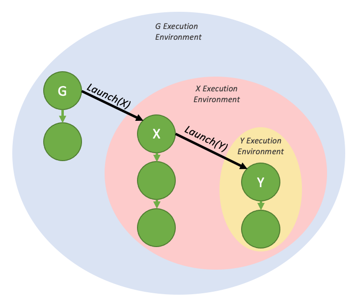

These environments are also hierarchical, so a graph environment can include multiple levels of child-environments from fire and forget launches.
../_images/fire-and-forget-nested-environments.png
Figure 33 Nested fire and forget environments#

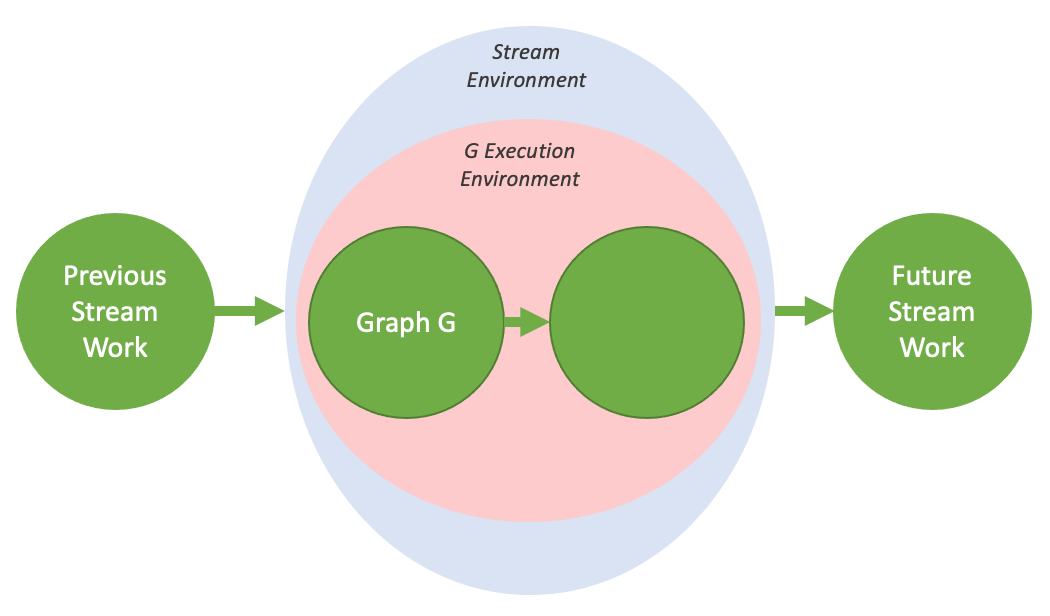

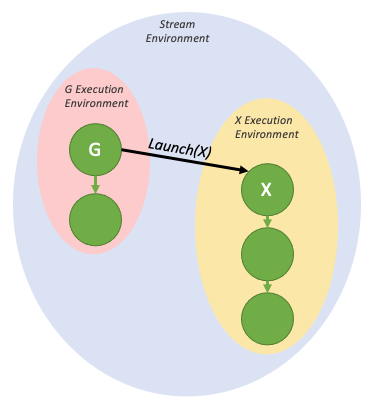

When a graph is launched from the host, there exists a stream environment that parents the execution environment of the launched graph. The stream environment encapsulates all work generated as part of the overall launch. The stream launch is complete (i.e. downstream dependent work may now run) when the overall stream environment is marked as complete.
../_images/device-graph-stream-environment.png
Figure 34 The stream environment, visualized#

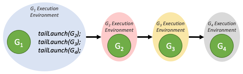

Tail launches enqueued by a given graph will execute one at a time, in order of when they were enqueued. So the first enqueued graph will run first, and then the second, and so on.
../_images/tail-launch-ordering-simple.png
Figure 36 Tail launch ordering#

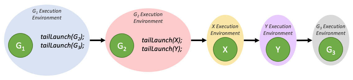

Tail launches enqueued by a tail graph will execute before tail launches enqueued by previous graphs in the tail launch list. These new tail launches will execute in the order they are enqueued.
../_images/tail-launch-ordering-complex.png
Figure 37 Tail launch ordering when enqueued from multiple graphs#

4.2.6.2.3. Sibling Launch#
Sibling launch is a variation of fire-and-forget launch in which the graph is launched not as a child of the launching graph’s execution environment, but rather as a child of the launching graph’s parent environment. Sibling launch is equivalent to a fire-and-forget launch from the launching graph’s parent environment.
../_images/sibling-launch-simple.png
Figure 38 A simple sibling launch#
__global__ void launchSiblingGraph(cudaGraphExec_t graph) {
    cudaGraphLaunch(graph, cudaStreamGraphFireAndForgetAsSibling);
void graphSetup() {
    cudaGraph_t g1, g2;
    create_graph(&g2);
    launchSiblingGraph<<<1, 1, 0, stream>>>(gExec2);
Since sibling launches are not launched into the launching graph’s execution environment, they will not gate tail launches enqueued by the launching graph.
