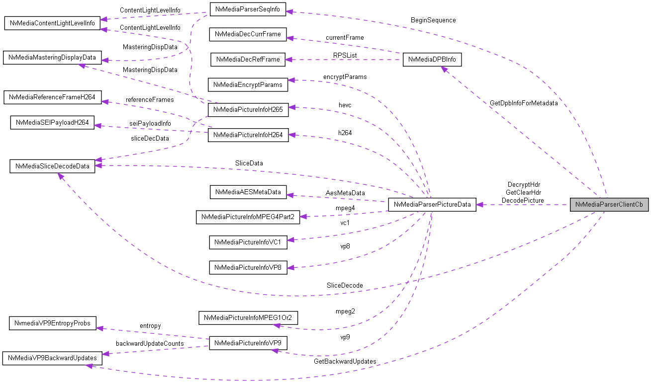

Definition at line 527 of file nvmedia_parser.h.
Data Fields | |
| pfnCbNvMediaBeginSequence | BeginSequence |
| callback to provide sequence level information to client Client will use this to create NvMediaVideoDecoder based on codec type. More... | |
| pfnCbNvMediaDecodePicture | DecodePicture |
| callback to provide one frame/field worth of data required to achieve decoding using NvMediaVideoDecoder component. More... | |
| pfnCbNvMediaDisplayPicture | DisplayPicture |
| Callback to pass frame-buffer with its timestamp in display order for display. More... | |
| pfnCbNvMediaUnhandledNALU | UnhandledNALU |
| Callback to report unhandled NALU. More... | |
| pfnCbNvMediaAllocPictureBuffer | AllocPictureBuffer |
| callback to get one free frame-buffer to do current frame decoding. More... | |
| pfnCbNvMediaRelease | Release |
| Callback to tell client to decrement the buffer reference count by 1. More... | |
| pfnCbNvMediaAddRef | AddRef |
| Callback to increase ref counting of buffer by 1 when surface is used as reference. More... | |
| pfnCbNvMediaCreateDecrypter | CreateDecrypter |
| Callback to create NvMediaVideoDecrypter component to handle encrypted contents. More... | |
| pfnCbNvMediaDecryptHdr | DecryptHdr |
| Callback to pass encrypted data for decryption of frame-headers. More... | |
| pfnCbNvMediaSliceDecode | SliceDecode |
| Callback to pass slice level data for the slice level decoding use case. More... | |
| pfnCbNvMediaGetClearHdr | GetClearHdr |
| callback to get clear header data from NvMediaVideoDecrypter. More... | |
| pfnCbNvMediaGetBackwardUpdates | GetBackwardUpdates |
| callback to get backward prabability data for VP9 codec. More... | |
| pfnCbNvMediaGetDpbInfoForMetadata | GetDpbInfoForMetadata |
| callback to pass internal DPB information to the client. More... | |
