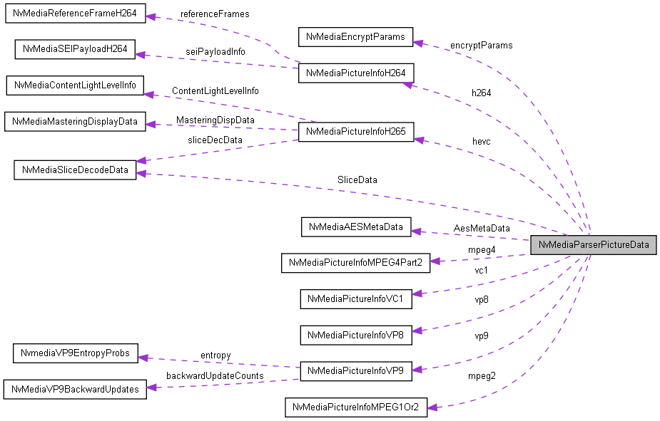

Holds picture information for the current frame decode operation.
Definition at line 421 of file nvmedia_parser.h.
Data Fields | |
| uint16_t | uDARWidth |
| Display Aspect Ratio = uDARWidth. More... | |
| uint16_t | uDARHeight |
| Display Aspect Ratio = uDARHeight. More... | |
| uint16_t | uDisplayLeftOffset |
| Left offset for display. More... | |
| uint16_t | uDisplayTopOffset |
| Top offset for display. More... | |
| uint16_t | uDisplayWidth |
| Display Width. More... | |
| uint16_t | uDisplayHeight |
| Display Height. More... | |
| int64_t | llFrameTime |
| Frame time in time_base units if NvMParseAttr_UseFrameTimingInfo is enabled. More... | |
| int64_t | llTimeBase |
| Base time units per second if NvMParseAttr_UseFrameTimingInfo is enabled. More... | |
| NvMediaRefSurface * | pCurrPic |
| Current picture (output) More... | |
| int32_t | field_pic_flag |
| 0=frame picture, 1=field picture More... | |
| int32_t | bottom_field_flag |
| 0=top field, 1=bottom field (ignored if field_pic_flag=0) More... | |
| int32_t | second_field |
| Second field of a complementary field pair. More... | |
| int32_t | progressive_frame |
| Frame is progressive or not. More... | |
| int32_t | top_field_first |
| Frame pictures only. More... | |
| int32_t | repeat_first_field |
| For 3:2 pulldown (number of additional fields, 2=frame doubling, 4=frame tripling) More... | |
| int32_t | ref_pic_flag |
| Frame is a reference frame. More... | |
| int32_t | intra_pic_flag |
| Frame is entirely intra coded (no temporal dependencies) More... | |
| int32_t | chroma_format |
| Chroma Format (should match sequence info) More... | |
| int32_t | picture_order_count |
| picture order count (if known) More... | |
| uint32_t | uBitstreamDataLen |
| Bitstream data. More... | |
| uint8_t * | pBitstreamData |
| Pointer to the bitstream data for this picture (slice-layer) More... | |
| uint32_t | uNumSlices |
| Number of slices in this picture. More... | |
| uint32_t * | pSliceDataOffsets |
| nNumSlices entries, contains offset of each slice within the bitstream data buffer More... | |
| uint32_t | nal_ref_idc |
| Required only for encrypted h264 bitstreams. More... | |
| NvMediaBool | bSliceDecode |
| Flag to indicate that slice level decoding is enabled. More... | |
| union { | |
| NvMediaPictureInfoMPEG1Or2 mpeg2 | |
| picture parameter information for mpeg1/2 NvMediaPictureInfoMPEG1Or2 More... | |
| NvMediaPictureInfoMPEG4Part2 mpeg4 | |
| picture parameter information for mpeg4 NvMediaPictureInfoMPEG4Part2 More... | |
| NvMediaPictureInfoH264 h264 | |
| picture parameter information for h264 NvMediaPictureInfoH264 More... | |
| NvMediaPictureInfoVC1 vc1 | |
| picture parameter information for vc1 NvMediaPictureInfoVC1 More... | |
| NvMediaPictureInfoVP8 vp8 | |
| picture parameter information for VP8 NvMediaPictureInfoVP8 More... | |
| NvMediaPictureInfoH265 hevc | |
| picture parameter information for h265 NvMediaPictureInfoH265 More... | |
| NvMediaPictureInfoVP9 vp9 | |
| picture parameter information for vp9 NvMediaPictureInfoVP9 More... | |
| } | CodecSpecificInfo |
| NvMedia Picture Info. More... | |
| NvMediaSliceDecodeData | SliceData |
| Pass slice level data if slice level decoding enabled. More... | |
| NvMediaAESMetaData | AesMetaData |
| Encrypted content decoding specific parameters. More... | |
| NvMediaEncryptParams | encryptParams |
| contains encrypted metadata for pass1 More... | |
