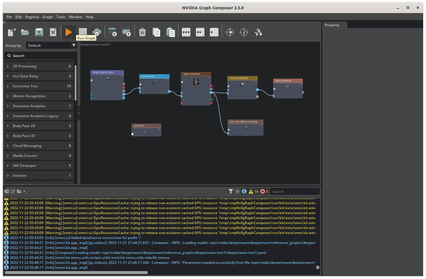

Load Graph¶
Open the
Filemenu from the menubar at the top and click onOpen Graphto launch the file browser. You may alternatively use theCtrl + Okey combination.
Browse to a valid graph file, select it and click on
Okayto open the graph.
Composer should now show the application graph.
To load component parameters from a separate file, right-click on the graph and select
Load parametersfrom the context menu to launch the file browser.
Browse to an appropriate parameters file for the currently open and visible graph, select it and click on
Okayto load parameter values from the file.

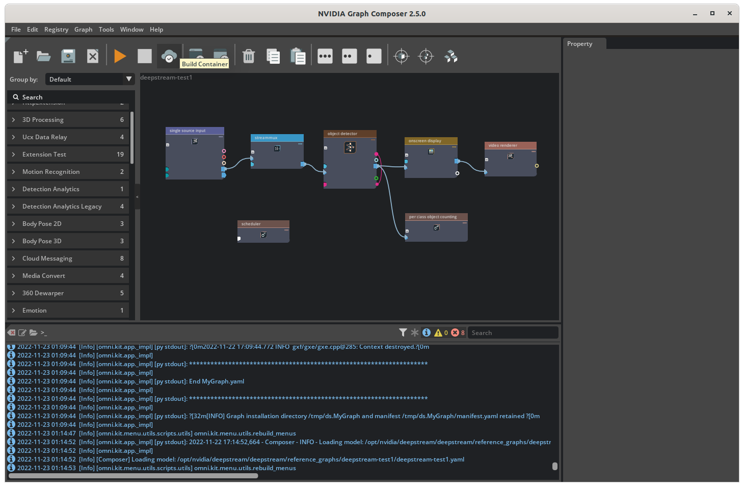

Build Container Image
1. To build a container, first click on the Build Container button from the
toolbar on the top.

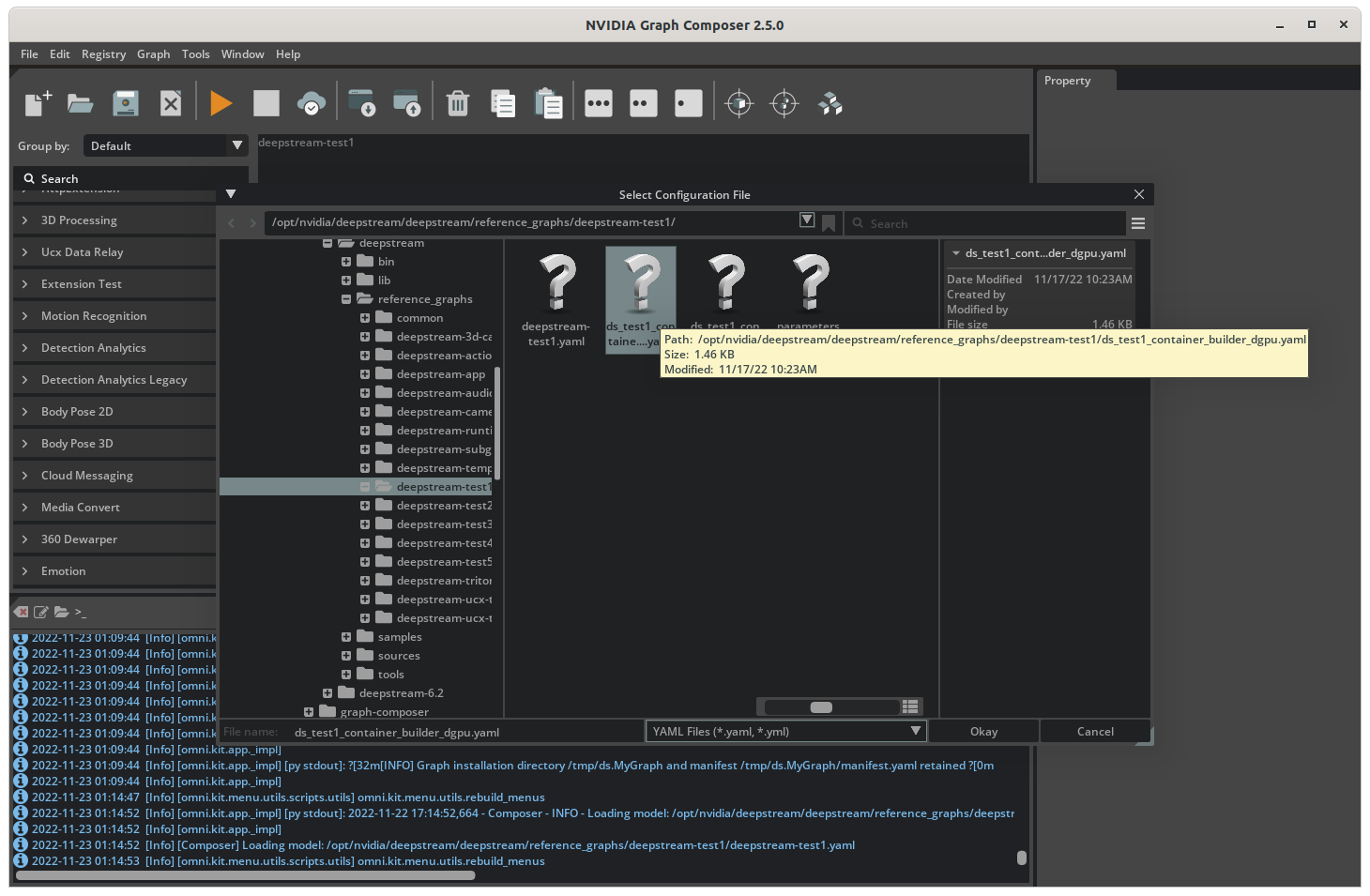

This will open the
Build Containerdialog. Launch the file browser using the button next to theConfiguration Fileinput.
Select a container builder configuration file and open it.

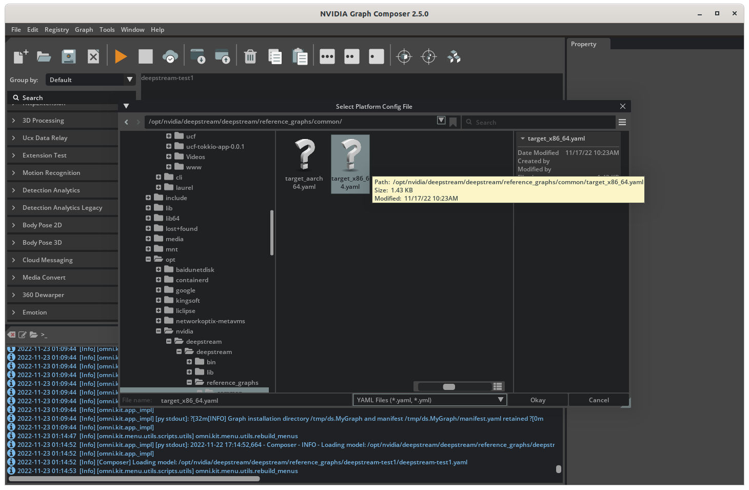

Click the button next to the
Platform config Fileinput to launch the file browser. Select a platform config file and open it.

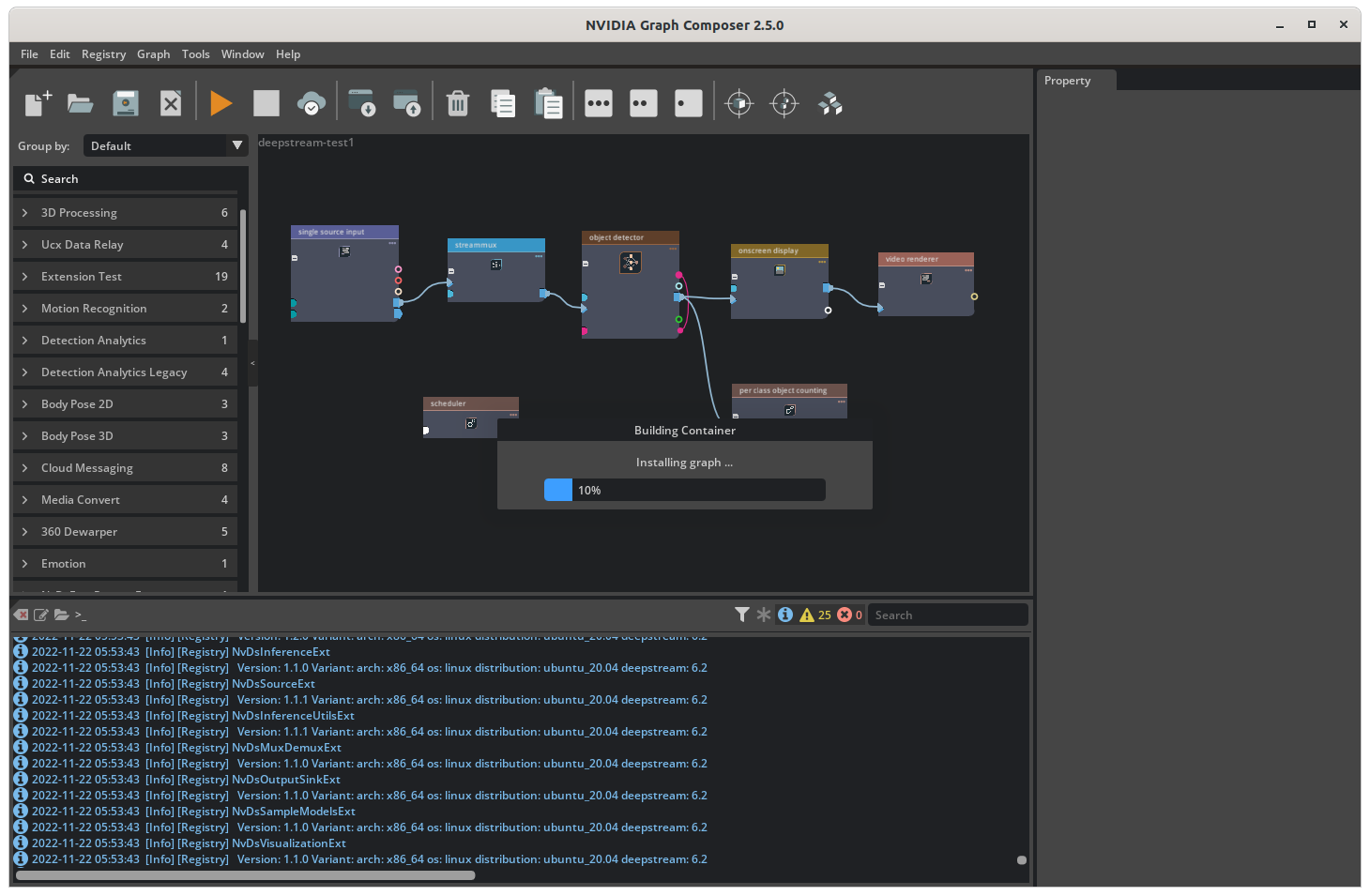

Click on

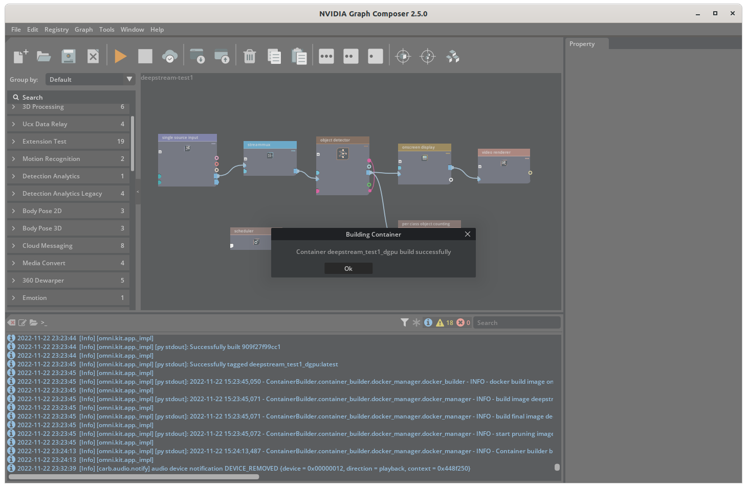

Buildto start the build process. Composer reports the container build status using a progress bar.
On successful completion, composer will show a success message.
