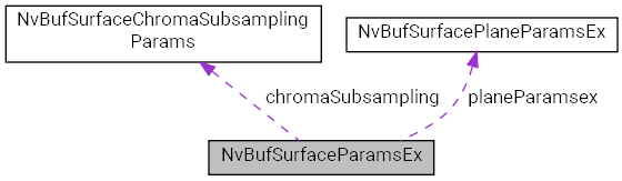

Hold the information(extended) of single buffer in the batch.
Definition at line 495 of file nvbufsurface.h.
Data Fields | |
| int32_t | startofvaliddata |
| offset in bytes from the start of the buffer to the first valid byte. More... | |
| int32_t | sizeofvaliddatainbytes |
| size of the valid data from the first to the last valid byte. More... | |
| NvBufSurfaceChromaSubsamplingParams | chromaSubsampling |
| chroma subsampling parameters. More... | |
| bool | is_protected |
| get buffer vpr information. More... | |
| NvBufSurfacePlaneParamsEx | planeParamsex |
| plane wise extended info More... | |
| void * | _reserved [STRUCTURE_PADDING] |
