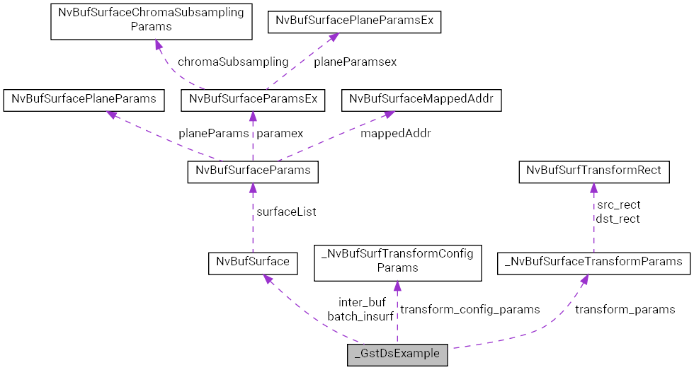

Data Fields | |
| GstBaseTransform | base_trans |
| DsExampleCtx * | dsexamplelib_ctx |
| Context of the custom algorithm library. More... | |
| guint | unique_id |
| Unique ID of the element. More... | |
| guint64 | frame_num |
| Frame number of the current input buffer. More... | |
| cudaStream_t | cuda_stream |
| CUDA Stream used for allocating the CUDA task. More... | |
| void * | host_rgb_buf |
| NvBufSurface * | inter_buf |
| the intermediate scratch buffer for conversions RGBA More... | |
| GstVideoInfo | video_info |
| Input video info (resolution, color format, framerate, etc) More... | |
| gint | processing_width |
| Resolution at which frames/objects should be processed. More... | |
| gint | processing_height |
| guint | is_integrated |
| guint | max_batch_size |
| Maximum batch size. More... | |
| guint | gpu_id |
| GPU ID on which we expect to execute the task. More... | |
| gboolean | process_full_frame |
| Boolean indicating if entire frame or cropped objects should be processed. More... | |
| gboolean | blur_objects |
| NvBufSurfTransformConfigParams | transform_config_params |
| Config params required by NvBufSurfTransform API. More... | |
| GMutex | process_lock |
| Processing Queue and related synchronization structures. More... | |
| GQueue * | process_queue |
| Queue to send data to output thread for processing. More... | |
| GCond | process_cond |
| Gcondition for process queue. More... | |
| GQueue * | buf_queue |
| Queue to receive processed data from output thread. More... | |
| GCond | buf_cond |
| Gcondition for buf queue. More... | |
| GThread * | process_thread |
| Output thread. More... | |
| gboolean | stop |
| Boolean to signal output thread to stop. More... | |
| NvBufSurface | batch_insurf |
| Temporary NvBufSurface for batched transformations. More... | |
| gulong | current_batch_num |
| Current batch number of the input batch. More... | |
| GstFlowReturn | last_flow_ret |
| GstFlowReturn returned by the latest buffer pad push. More... | |
| NvBufSurfTransformParams | transform_params |
| Parameters to use for transforming buffers. More... | |
| nvtxDomainHandle_t | nvtx_domain |
| NVTX Domain. More... | |
| void * | device_rgb_buf |
