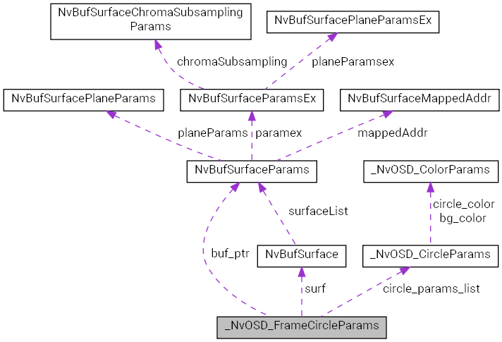

Collaboration diagram for _NvOSD_FrameCircleParams:
Data Fields
NvBufSurfaceParamsbuf_ptr
 Holds a pointer to the buffer containing the frame. More...
NvOSD_Mode mode
 Holds the OSD mode to be used for processing. More...
int num_circles
 Holds the number of circles. More...
NvOSD_CircleParamscircle_params_list
 Holds the parameters of the circles. More...
NvBufSurfacesurf
 Holds information about batched buffers. More...
