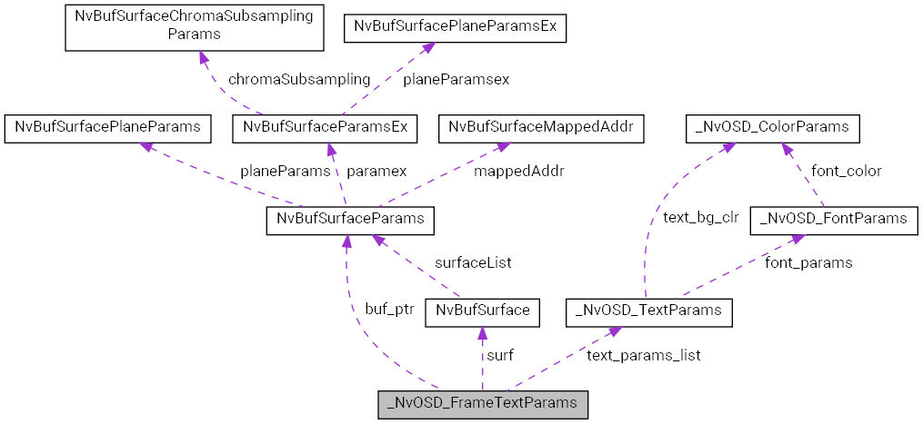

Collaboration diagram for _NvOSD_FrameTextParams:
