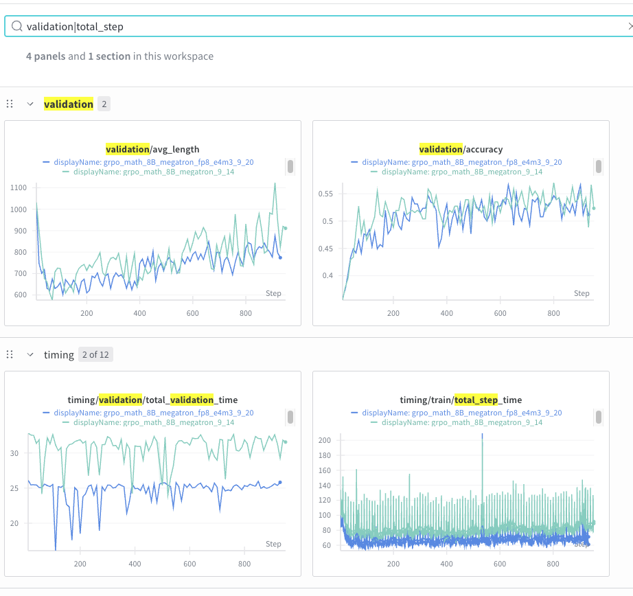

Llama-3.1-8B-Instruct GRPO Curve BF16 vs FP8
The above results are from Llama-3.1-8B-Instruct GRPO experiments. You can run them with the following example configs:
  • For BF16: examples/configs/grpo_math_8B_megatron.yaml
  • For FP8: examples/configs/grpo_math_8B_megatron_fp8.yaml
In the experiment in this figure, enabling FP8 rollout and training gives 15%-25% decrease in step time, and the validation accuracy curves match up to 1000 steps. Efforts are ongoing to performs longer runs and further optimize performance.
