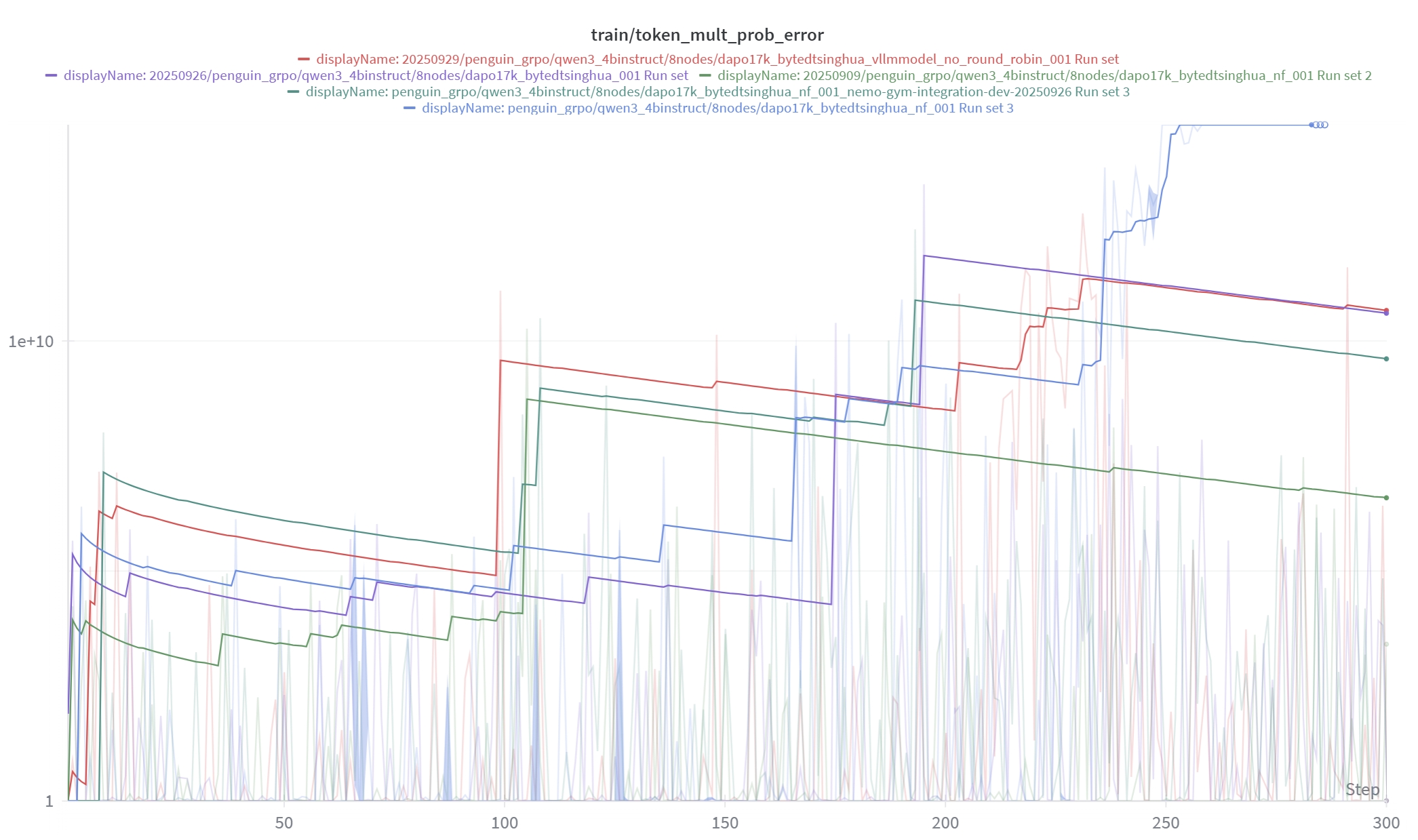

Using Qwen/Qwen3-4B-Instruct-2507 as an example, Figure 1 illustrates the token_mult_prob_error observed during training. We applied a time-weighted exponential moving average (EMA) smoothing method and used a logarithmic scale on the Y-axis for better visualization.
The token_mult_prob_error metric measures the discrepancy between the inference engine and the training engine when processing the same sample. It is defined as follows:
\[\begin{split} \begin{aligned} g_i & : \text{the } i^{th} \text{ item in } \text{generation-logprobs}, \\ p_i & : \text{the } i^{th} \text{ item in } \text{policy-logprobs}, \\ m_i & : \text{mask the } i^{th} \text{ token , whether 1 or 0} \\ &\text{global-valid-toks} = \sum_i m_i \, . \\ & \text{token-mult-prob-error}= \frac{1}{\text{global-valid-toks}}\sum_{i} m_i \exp\left(\left|g_i - p_i\right|\right) \end{aligned} \end{split}\]
In general, generation logprobs and policy logprobs should align closely, resulting in a token_mult_prob_error value near 1.0. In our development, when this metric exceeds 1.05, we consider it indicative of a potential framework issue that warrants further investigation.
As shown in Figure 1, numerous spikes can be observed during training. Occasional spikes are acceptable if the token_mult_prob_error quickly returns to around 1.0. However, in this case, even with EMA smoothing applied, the figure reveals an overall upward trend, which is unacceptable and indicates a persistent misalignment between the training and inference behaviors.
Fig 1: The token_mult_prob_error of Qwen3-4B

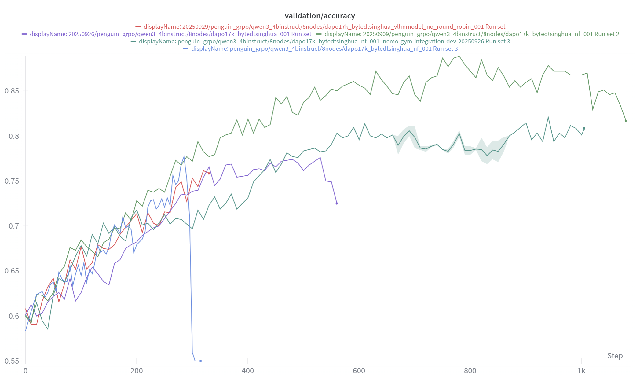

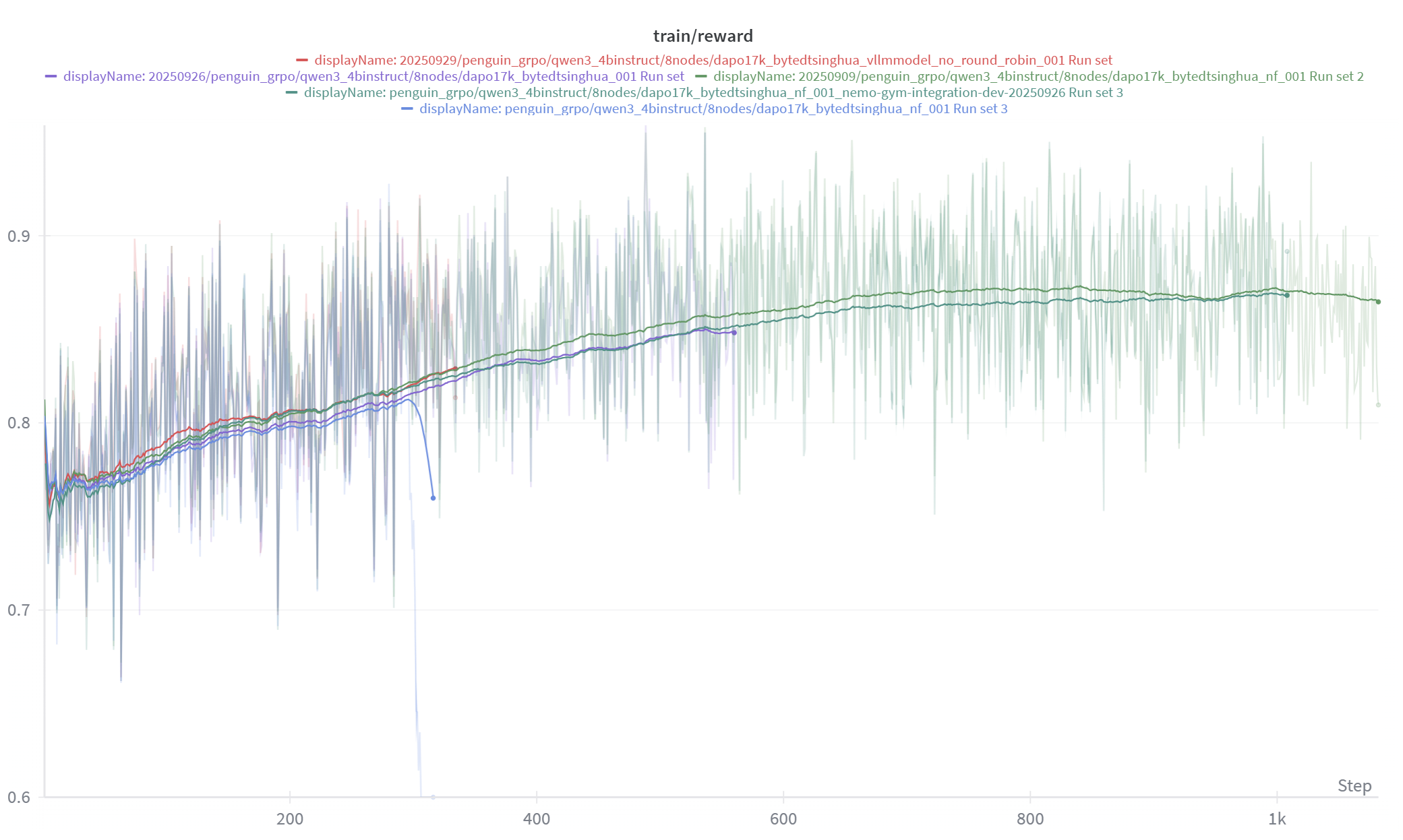

Figure 2 and Figure 3 present the reward curves and validation accuracy curves for multiple runs under different tensor parallel (TP) configurations. We also apply EMA smoothing for better visualization. The mismatch between the policy engine and the generation engine can lead to degraded downstream accuracy. This issue is most evident in the blue and purple curves, whose corresponding experiments are also the most abnormal cases observed in Figure 1.
Combining the three images for observation, it is not necessarily true that abnormal token_mult_prob_error leads to abnormal reward and validation accuracy. This occurs for several reasons:

Fig 2: The reward of Qwen3-4B
Fig 3: The validation accuracy of Qwen3-4B

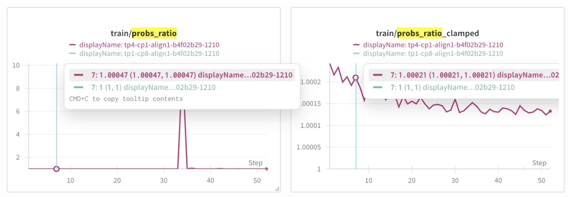

In RL training, log probabilities are typically computed for samples drawn from the old policy, denoted as prev_logprobs. The same samples are then evaluated under the current policy being optimized, yielding current_logprobs. Using these two quantities, we compute the ratio between the current and previous policies as follows:
\[\begin{split} \begin{aligned} \text{ratio} &= \exp\left(\text{current-logprobs} - \text{prev-logprobs}\right) \\ &= \exp\left(\log\left(\frac{\text{current-probs}}{\text{prev-probs}}\right)\right) \\ &= \frac{\text{current-probs}}{\text{prev-probs}} \end{aligned} \end{split}\]
This ratio is the standard importance ratio used in off-policy RL to reweight returns when the data are collected under an older behavior policy. In on-policy training, this ratio should be exactly 1. However, in our experiments, we observed cases where the ratio deviates from 1, indicating a mismatch between the intended on-policy setting and the actual behavior of the system. Figure 4 and Figure 5 illustrate this phenomenon by showing the mismatch between prev_logprobs and current_logprobs under TP=4, as well as the reward curves under TP=4 and TP=1 for the deepseek-ai/DeepSeek-R1-Distill-Qwen-7B model.

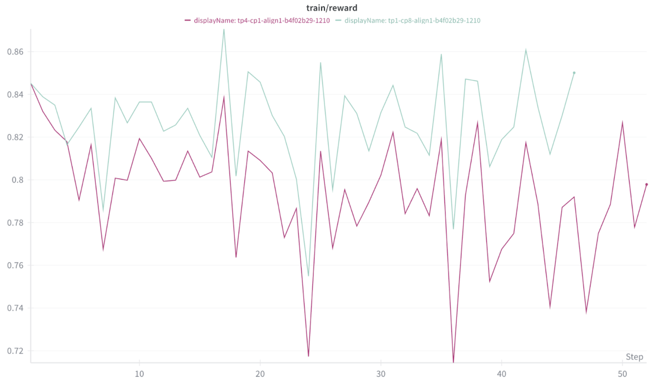

Fig 4: The mismatch of prev_logprobs and current_logprobs under TP=4
Fig 5: The reward of deepseek-ai/DeepSeek-R1-Distill-Qwen-7B under TP=4 and TP=1

Upon further investigation, the discrepancy between current_logprobs and prev_logprobs was traced to a mismatch between train_micro_batch_size and logprob_batch_size, which caused the model to behave differently for the same logical samples under different effective batch sizes. This behavior is a typical manifestation of batch-variant kernels, where the numerical outputs of certain operators depend not only on the input tensors themselves but also on how those tensors are grouped into batches or microbatches.
In batch-variant kernels, low-level implementation details—such as parallel reduction order, tiling strategy, fused-kernel heuristics, or algorithm selection conditioned on batch size or sequence layout—can change when the batch size changes, leading to small but systematic numerical differences in the computed logprobs. When train_micro_batch_size and logprob_batch_size are inconsistent, the same token sequence may traverse slightly different computational paths during training and logprob evaluation, resulting in current_logprobs != prev_logprobs and importance-sampling ratios that deviate from 1, even in nominally on-policy settings.
After aligning train_micro_batch_size and logprob_batch_size so that the same samples are processed with identical effective batch configurations, the importance-sampling ratio (probs_ratio) becomes 1 as expected, and the observed accuracy issues disappear. This confirms that the mismatch was caused by batch-dependent numerical variation rather than a conceptual error in the RL objective or data pipeline.

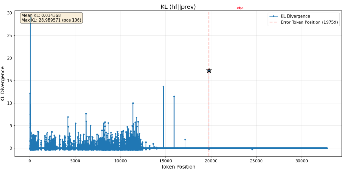

Figure 6 reports the KL divergence between the logits produced by the Hugging Face stack and those produced by NeMo‑RL for the same input sequence. The plot shows that, even with identical data and model weights, the resulting logit distributions differ noticeably across the two execution engines. In our experiments, similar behavior appeared when varying attention implementations and hardware configurations, where we consistently observed measurable numerical discrepancies, although we did not attempt to systematically eliminate every such source of variation.
Fig 6: The KL divergence between hugging face and nemorl
