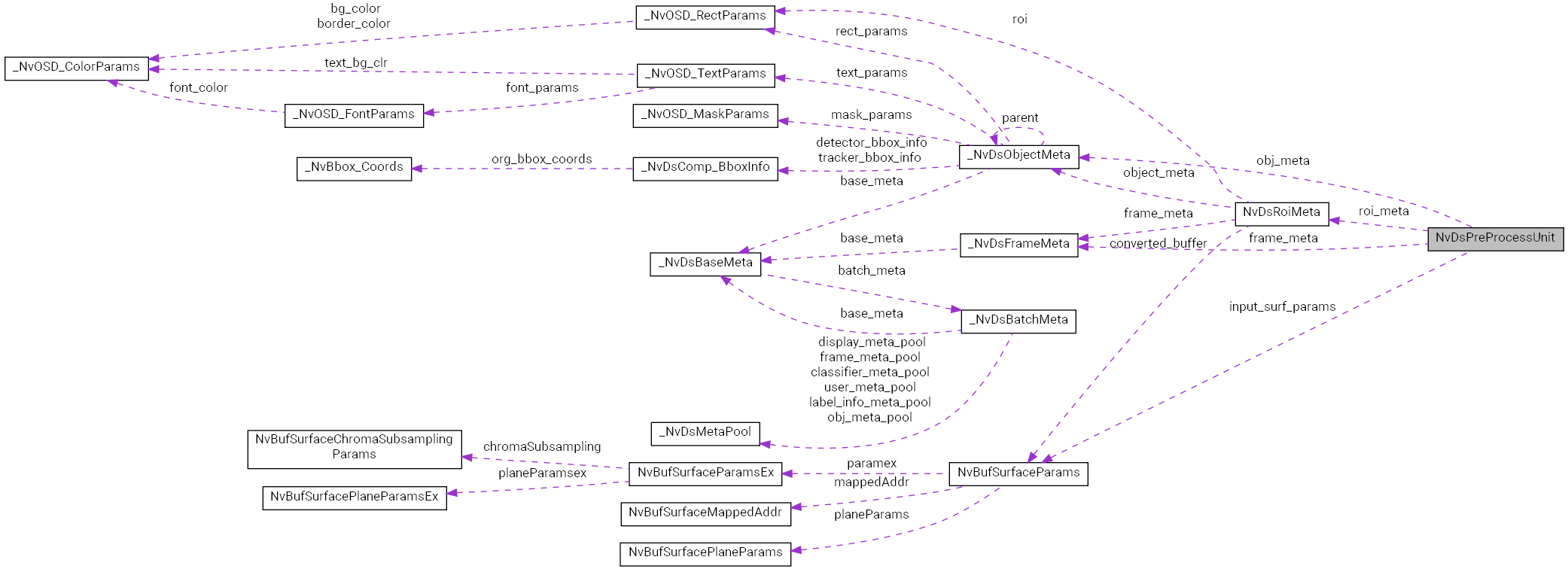

Collaboration diagram for NvDsPreProcessUnit:
Data Fields
NvDsObjectMetaobj_meta = nullptr
 NvDsObjectParams belonging to the object to be classified. More...
NvDsFrameMetaframe_meta = nullptr
 NvDsFrameMeta of the frame being preprocessed. More...
guint batch_index = 0
 Index of the frame in the batched input GstBuffer. More...
gulong frame_num = 0
 Frame number of the frame from the source. More...
NvBufSurfaceParamsinput_surf_params = nullptr
 The buffer structure the object / frame was converted from. More...
gpointer converted_frame_ptr = nullptr
 Pointer to the converted frame memory. More...
NvDsRoiMeta roi_meta
 New meta for rois provided. More...
