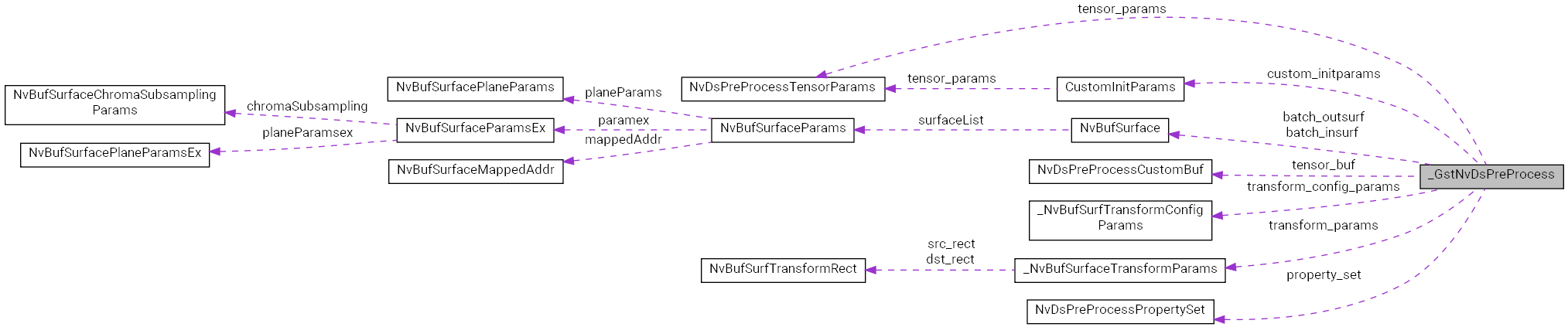

Strucuture containing Preprocess info.
Definition at line 198 of file gstnvdspreprocess.h.
