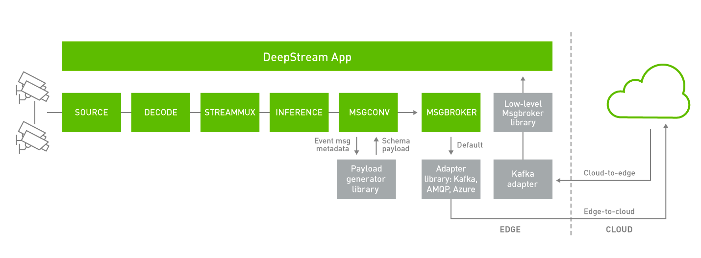

Bidirectional Messaging¶
DeepStream 5.0 now supports bi-directional communication to send and receive cloud-to-device messages along with publishing device-to-cloud messages. This is particularly important for various use cases, such as triggering the application to record an important event, changing operating parameters and app configurations, over-the-air (OTA) updates, or requesting system logs and other vital information. DeepStream 5.0 supports several other IoT features that can be used in conjunction with bi-directional messaging. DeepStream now offers an API to do a smart record based on an anomaly or could-to-device message. In addition, DeepStream also supports OTA updates of AI models while the application is running. The figure below shows the bi-directional messaging architecture:
Message subscribers can be enabled in test5 application by adding the following group in the configuration file.
[message-consumerX]
enable=1
proto-lib=/opt/nvidia/deepstream/deepstream-5.0/lib/libnvds_kafka_proto.so
conn-str= <connection string as host;port >
config-file=../cfg_kafka.txt
subscribe-topic-list=<topic1>;<topic2>;<topicN>
Here X should be replaced with integer value e.g., 0,1,2 etc.
Edge-to-Cloud¶
Device-to-cloud messaging currently happens through the Gst-nvmsgbroker (MSGBROKER) plugin. The Gstnvmsgbroker plugin by default calls the lower-level adapter library with the appropriate protocol API’s. You can choose between Kafka, AMQP, Azure IoT, Redis or you can even create a custom adapter. DeepStream 5.0 introduces a new low-level nvmsgbroker library to present a unified interface for bi-directional messaging across the various protocols. The Gst-nvmsgbroker plugin has the option of interfacing with this new library instead of directly calling the protocol adaptor libraries, as controlled via a configuration option.
For detailed information on Gst-nvmsgbroker plugin, please refer to the DeepStream Plugins Development Guide.
Cloud-to-Edge¶
DeepStream applications can subscribe to Apache Kafka topics or Redis streams to receive the messages from the cloud. DeepStream 5.0 introduces a new low-level nvmsgbroker library. The Cloud-to-device messaging currently happens through this library. The nvmsgbroker library calls into the lower-level adapter library with the appropriate protocol API’s. You can choose between Kafka, Redis, or you can even create a custom adapter.
Implementation of the receiving and processing of cloud messages can be found in the following files:
$DEEPSTREAM_DIR/sources/apps/apps-common/src/deepstream_c2d_msg.c
$DEEPSTREAM_DIR/sources/apps/apps-common/src/deepstream_c2d_msg_util.c
