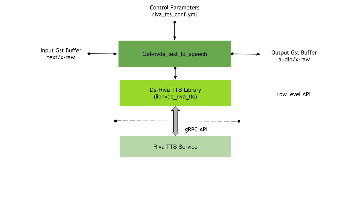

The Gst-nvds_text_to_speech plugin performs speech synthesis on the input text. Currently it supports only x86 platform. By default, the plugin loads DS-Riva Text To Speech library (libnvds_riva_tts.so) to perform speech synthesis.
The plugin provides a mechanism to load custom TTS low level library at runtime.
Note
The Gst-nvds_text_to_speech plugin is being released as an alpha feature.
DS-Riva Text To Speech library uses gRPC API to access the Riva TTS service. The Riva TTS service should be started before using this plugin. And the gRPC C++ installation is required on the client side.
The plugin accepts text (UTF8) Gst Buffers from upstream component. It transforms the text into audio Gst Buffer output.
The DS-Riva TTS library (libnvds_riva_tts.so) generates raw audio data with F32LE format (float 32 bit Little Endian) at 22050 Hz sample rate. Library settings can be configured via YAML format file (by setting a property on nvds_text_to_speech gst plugin) which has multi-part settings for plugin control, Riva TTS service configurations.
As shown in the diagram below, input text is send to Riva TTS service for speech synthesis. The final output is available as F32LE PCM audio at 22050 Hz.
