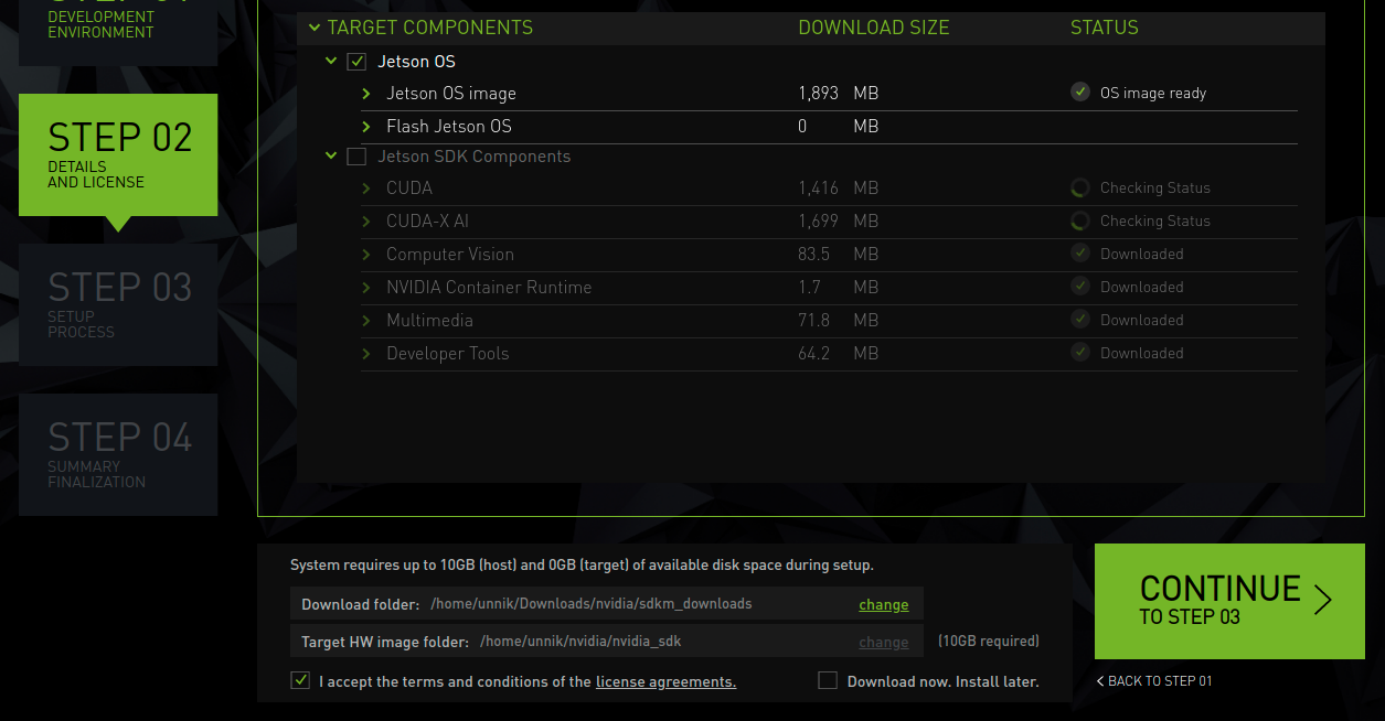

Recommended Minimal L4T Setup necessary to run the new docker images on Jetson¶
Users are encouraged to install the L4T BSP alone from Jetpack and later use command line to install NVIDIA Container runtime from debian repo to save space on the Jetson device.
1) In Step 02 of sdkmanager Jetpack setup, select “Jetson OS” and de-select “Jetson SDK Components” to flash just the BSP. Refer to the screenshot below for reference.
Instructions for installing nvidia-container from command line:
Flash BSP from Jetpack and boot Run "sudo apt update" Run "sudo apt install nvidia-container" Run "sudo service docker restart"
