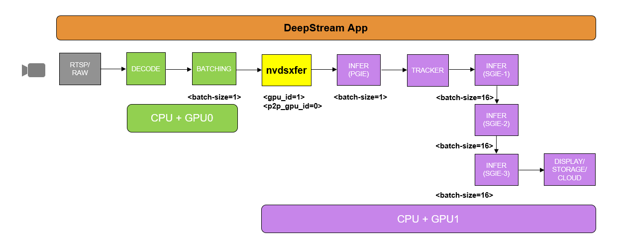

Running “Decode + StreamMux + PGIE” and “Tracker + SGIE (Multiple)” on separate dGPUs
gst-launch-1.0 multifilesrc location=samples/streams/sample_1080p.h265 loop=true ! h265parse ! queue ! \
nvv4l2decoder gpu-id=0 cudadec-memtype=0 ! queue ! m.sink_0 nvstreammux name=m batch-size=1 gpu-id=0 \
width=1920 height=1080 nvbuf-memory-type=2 ! queue ! nvinfer gpu-id=0 batch-size=1 \
config-file-path=samples/configs/deepstream-app/config_infer_primary.txt ! queue ! \
nvdsxfer gpu-id=1 p2p_gpu_id=0 ! queue ! nvtracker gpu-id=1 enable-batch-process=1 \
ll-lib-file=lib/libnvds_nvmultiobjecttracker.so ll-config-file=samples/configs/deepstream-app/config_tracker_NvDCF_perf.yml ! \
queue ! nvinfer gpu-id=1 batch-size=16 unique-id=2 config-file-path=samples/configs/deepstream-app/config_infer_secondary_carcolor.txt ! \
queue ! nvinfer gpu-id=1 batch-size=16 unique-id=3 config-file-path=samples/configs/deepstream-app/config_infer_secondary_carmake.txt ! \
queue ! nvinfer gpu-id=1 batch-size=16 unique-id=4 config-file-path=samples/configs/deepstream-app/config_infer_secondary_vehicletypes.txt ! \
queue ! fpsdisplaysink video-sink=fakesink sync=0 -e -v

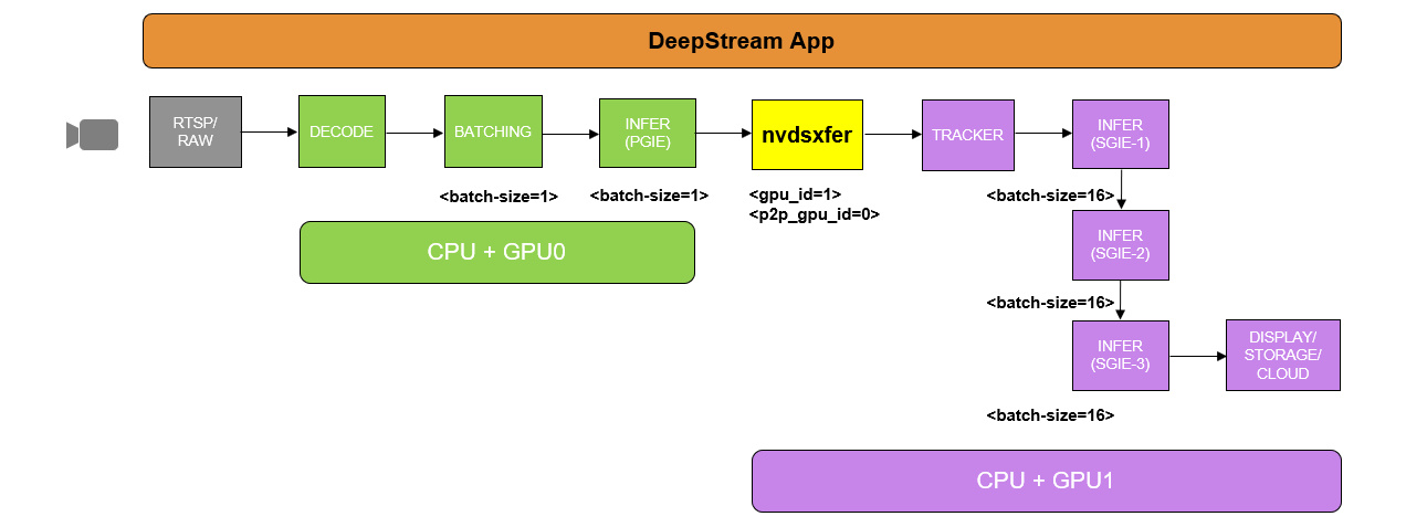

Running “Decode + StreamMux” and “PGIE + Tracker + SGIE (Multiple)” on separate dGPUs
gst-launch-1.0 multifilesrc location=samples/streams/sample_1080p.h265 loop=true ! h265parse ! queue ! \ nvv4l2decoder gpu-id=0 cudadec-memtype=0 ! queue ! m.sink_0 nvstreammux name=m batch-size=1 gpu-id=0 \ width=1920 height=1080 nvbuf-memory-type=2 ! queue ! nvdsxfer gpu-id=1 p2p_gpu_id=0 ! queue ! \ nvinfer gpu-id=1 batch-size=1 config-file-path= samples/configs/deepstream-app/config_infer_primary.txt ! queue ! \ nvtracker gpu-id=1 enable-batch-process=1 ll-lib-file=lib/libnvds_nvmultiobjecttracker.so \ ll-config-file=samples/configs/deepstream-app/config_tracker_NvDCF_perf.yml ! queue ! nvinfer gpu-id=1 batch-size=16 unique-id=2 \ config-file-path= samples/configs/deepstream-app/config_infer_secondary_carcolor.txt ! queue ! nvinfer gpu-id=1 batch-size=16 unique-id=3 \ config-file-path=samples/configs/deepstream-app/config_infer_secondary_carmake.txt ! queue ! nvinfer gpu-id=1 batch-size=16 unique-id=4 \ config-file-path=samples/configs/deepstream-app/config_infer_secondary_vehicletypes.txt ! queue ! fpsdisplaysink video-sink=fakesink sync=0 -e -v

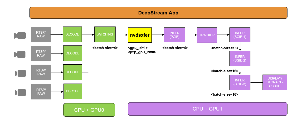

Running “Multi-instance(4) decode + Streammux + PGIE” on single dGPU and ” tracker + SGIE - multiple models” on separate dGPU
gst-launch-1.0 nvstreammux name=m batch-size=4 gpu-id=0 width=1920 height=1080 nvbuf-memory-type=2 ! queue ! \
nvinfer gpu-id=0 batch-size=4 config-file-path=samples/configs/deepstream-app/config_infer_primary.txt ! queue ! \
ll-lib-file=lib/libnvds_nvmultiobjecttracker.so ll-config-file=samples/configs/deepstream-app/config_tracker_NvDCF_perf.yml ! queue ! \
nvinfer gpu-id=1 batch-size=16 unique-id=2 config-file-path=samples/configs/deepstream-app/config_infer_secondary_carcolor.txt ! queue ! \
nvinfer gpu-id=1 batch-size=16 unique-id=3 config-file-path=samples/configs/deepstream-app/config_infer_secondary_carmake.txt ! queue ! \
nvinfer gpu-id=1 batch-size=16 unique-id=4 config-file-path=samples/configs/deepstream-app/config_infer_secondary_vehicletypes.txt ! queue ! \
fpsdisplaysink video-sink=fakesink sync=0 multifilesrc location=samples/streams/sample_1080p.h265 loop=true ! h265parse ! queue ! \
nvv4l2decoder gpu-id=0 cudadec-memtype=0 ! queue ! m.sink_0 multifilesrc location=samples/streams/sample_1080p.h265 loop=true ! h265parse ! queue ! \
nvv4l2decoder gpu-id=0 cudadec-memtype=0 ! queue ! m.sink_1 multifilesrc location=samples/streams/sample_1080p.h265 loop=true ! h265parse ! queue ! \
nvv4l2decoder gpu-id=0 cudadec-memtype=0 ! queue ! m.sink_2 multifilesrc location=samples/streams/sample_1080p.h265 loop=true ! h265parse ! queue ! \
nvv4l2decoder gpu-id=0 cudadec-memtype=0 ! queue ! m.sink_3 -e -v

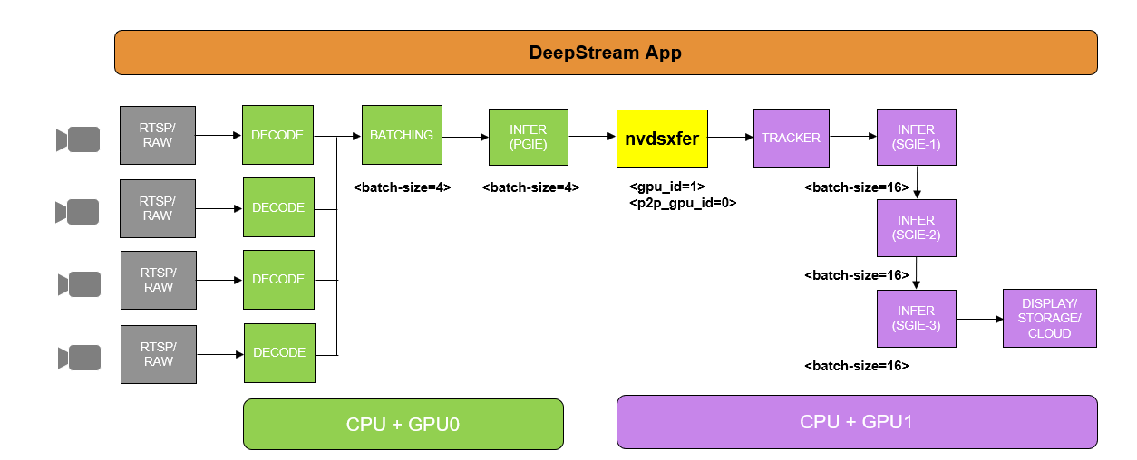

Running “Multi-instance(4) decode + StreamMux” on single-dGPU and “PGIE + Tracker + SGIE(Multiple)” on separate dGPU
nvdsxfer gpu-id=1 p2p_gpu_id=0 ! queue ! nvinfer gpu-id=1 batch-size=4 config-file-path=samples/configs/deepstream-app/config_infer_primary.txt ! queue ! \
config-file-path=samples/configs/deepstream-app/config_infer_secondary_carcolor.txt ! queue ! nvinfer gpu-id=1 batch-size=16 unique-id=3 \
config-file-path=samples/configs/deepstream-app/config_infer_secondary_vehicletypes.txt ! queue ! fpsdisplaysink video-sink=fakesink sync=0 \
multifilesrc location=samples/streams/sample_1080p.h265 loop=true ! h265parse ! queue ! nvv4l2decoder gpu-id=0 cudadec-memtype=0 ! queue ! m.sink_0 \
multifilesrc location=samples/streams/sample_1080p.h265 loop=true ! h265parse ! queue ! nvv4l2decoder gpu-id=0 cudadec-memtype=0 ! queue ! m.sink_1 \
multifilesrc location=samples/streams/sample_1080p.h265 loop=true ! h265parse ! queue ! nvv4l2decoder gpu-id=0 cudadec-memtype=0 ! queue ! m.sink_2 \
multifilesrc location=samples/streams/sample_1080p.h265 loop=true ! h265parse ! queue ! nvv4l2decoder gpu-id=0 cudadec-memtype=0 ! queue ! m.sink_3 -e -v

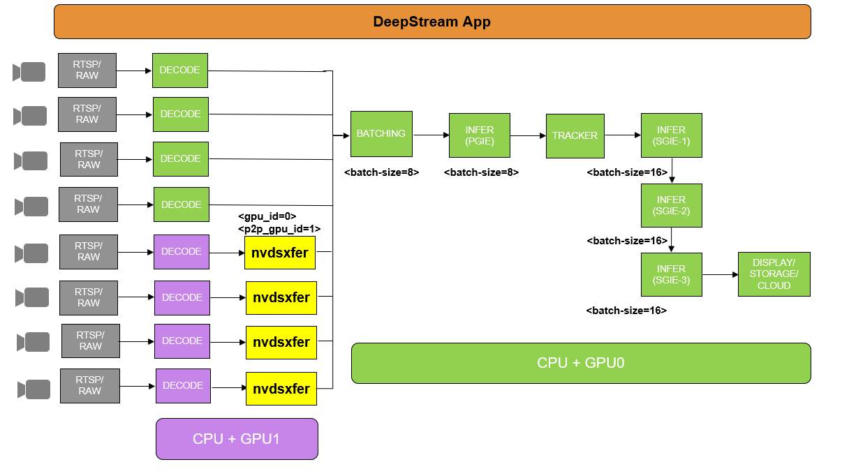

Running “Multi-instance(8) decode” on multi-dGPU and “StreamMux + PGIE + Tracker + SGIE(Multiple)” on any one of the dGPU
gst-launch-1.0 nvstreammux name=m batch-size=8 gpu-id=0 width=1920 height=1080 nvbuf-memory-type=2 ! queue ! nvinfer gpu-id=0 batch-size=8 \
config-file-path=samples/configs/deepstream-app/config_infer_primary.txt ! queue ! nvtracker gpu-id=0 enable-batch-process=1 \
nvinfer gpu-id=0 batch-size=16 unique-id=2 config-file-path= samples/configs/deepstream-app/config_infer_secondary_carcolor.txt ! queue ! \
nvinfer gpu-id=0 batch-size=16 unique-id=3 config-file-path=samples/configs/deepstream-app/config_infer_secondary_carmake.txt ! queue ! \
nvinfer gpu-id=0 batch-size=16 unique-id=4 config-file-path=samples/configs/deepstream-app/config_infer_secondary_vehicletypes.txt ! queue ! \
nvv4l2decoder gpu-id=0 cudadec-memtype=0 ! queue ! m.sink_3 multifilesrc location=samples/streams/sample_1080p.h265 loop=true ! h265parse ! queue ! \
nvv4l2decoder gpu-id=1 cudadec-memtype=0 ! queue ! nvdsxfer gpu-id=0 p2p_gpu_id=1 ! queue ! m.sink_4 multifilesrc \
location=samples/streams/sample_1080p.h265 loop=true ! h265parse ! queue ! nvv4l2decoder gpu-id=1 cudadec-memtype=0 ! queue ! \
nvdsxfer gpu-id=0 p2p_gpu_id=1 ! queue ! m.sink_5 multifilesrc location=samples/streams/sample_1080p.h265 loop=true ! h265parse ! queue ! \
nvv4l2decoder gpu-id=1 cudadec-memtype=0 ! queue ! nvdsxfer gpu-id=0 p2p_gpu_id=1 ! queue ! m.sink_6 multifilesrc \
nvdsxfer gpu-id=0 p2p_gpu_id=1 ! queue ! m.sink_7 -e -v

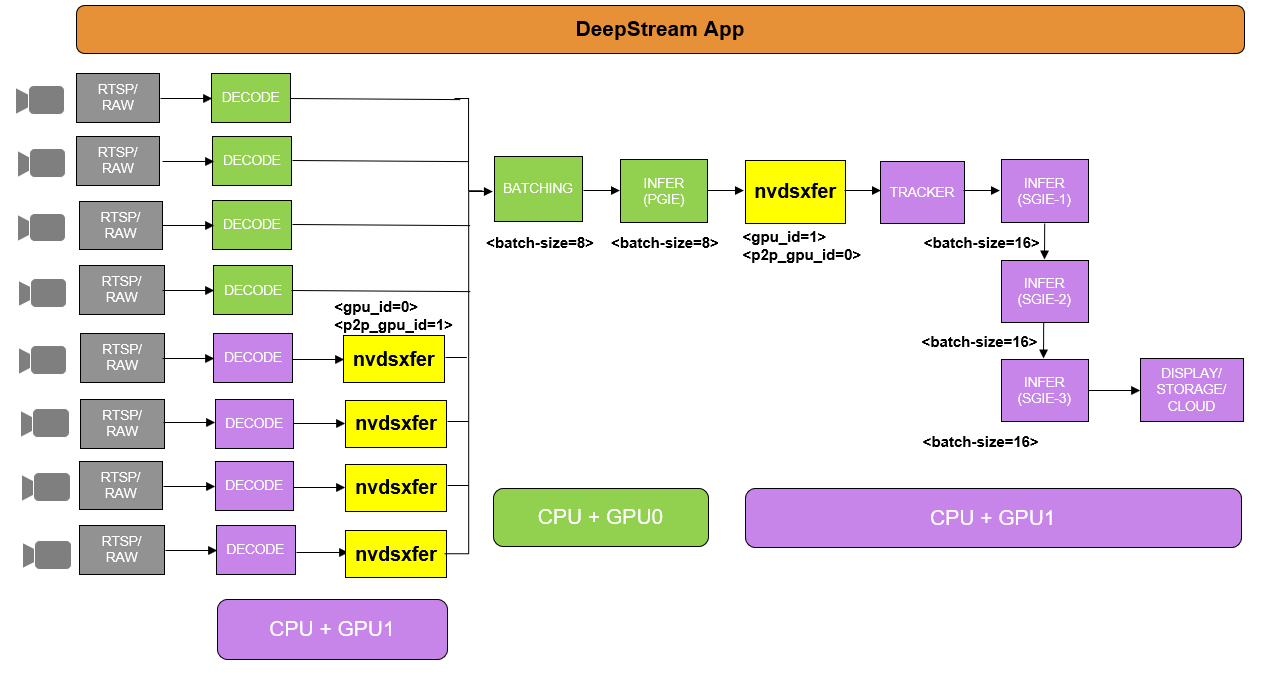

Running “Multi-instance(8) decode” on multi-dGPU, “StreamMux + PGIE” and “Tracker + SGIE(Multiple)” on separate dGPU
config-file-path=samples/configs/deepstream-app/config_infer_primary.txt ! queue ! nvdsxfer gpu-id=1 p2p_gpu_id=0 ! queue ! nvtracker gpu-id=1 \
enable-batch-process=1 ll-lib-file=lib/libnvds_nvmultiobjecttracker.so ll-config-file=samples/configs/deepstream-app/config_tracker_NvDCF_perf.yml ! \
queue ! nvinfer gpu-id=1 batch-size=16 unique-id=2 config-file-path= samples/configs/deepstream-app/config_infer_secondary_carcolor.txt ! \
queue ! fpsdisplaysink video-sink=fakesink sync=0 multifilesrc location=samples/streams/sample_1080p.h265 loop=true ! h265parse ! \
queue ! nvv4l2decoder gpu-id=0 cudadec-memtype=0 ! queue ! m.sink_0 multifilesrc location=samples/streams/sample_1080p.h265 loop=true ! h265parse ! \
queue ! nvv4l2decoder gpu-id=0 cudadec-memtype=0 ! queue ! m.sink_1 multifilesrc location=samples/streams/sample_1080p.h265 loop=true ! h265parse ! \
queue ! nvv4l2decoder gpu-id=0 cudadec-memtype=0 ! queue ! m.sink_2 multifilesrc location=samples/streams/sample_1080p.h265 loop=true ! h265parse ! \
queue ! nvv4l2decoder gpu-id=0 cudadec-memtype=0 ! queue ! m.sink_3 multifilesrc location=samples/streams/sample_1080p.h265 loop=true ! h265parse ! \
queue ! nvv4l2decoder gpu-id=1 cudadec-memtype=0 ! queue ! nvdsxfer gpu-id=0 p2p_gpu_id=1 ! queue ! m.sink_4 multifilesrc \
