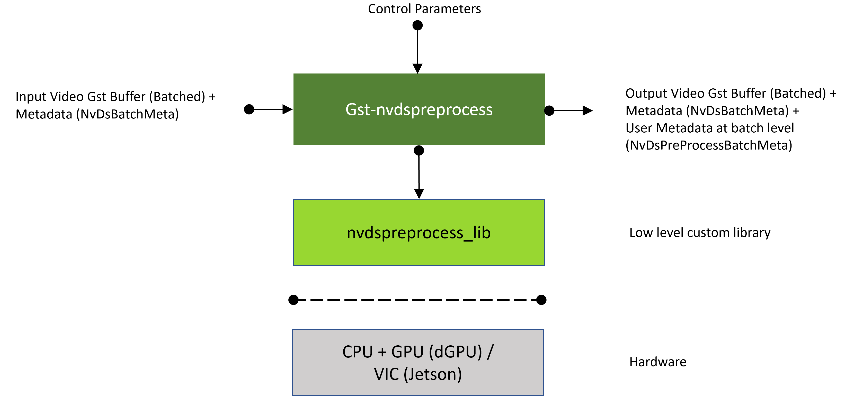

The Gst-nvdspreprocess plugin is a customizable plugin which provides a custom library interface for preprocessing on input streams. Each stream can have its own preprocessing requirements. (e.g. per stream ROIs - Region of Interests processing) Streams with same preprocessing requirements are grouped and processed together. These requirements can be specified via a config file. Refer to section Gst-nvdspreprocess File Configuration Specifications below for more details.
Default plugin implementation provides two functionalities.
Streams with predefined ROIs (Region of Interests) are scaled and format converted as per the network requirements for inference. Per stream ROIs are specified in the config file.
It prepares a raw tensor from the scaled & converted ROIs. It is passed to the downstream plugins via user metadata. Downstream plugins can access this tensor for inference.
The default custom library (nvdspreprocess_lib) provided with the plugin implements these functionalities. It contains the group transformation (scaling and conversion functionality per group) and tensor preparation functions for 2d convolution NCHW/NHWC models. User can implement its own library with group transformation functions and tensor preparation function as per the requirements.
This plugin can operate in two modes PGIE and SGIE. Preprocess with PGIE mode is used to process the given ROI/Frame on which we want to perform primary inferencing. Preprocess with SGIE mode is used to process the detected objects within the given ROI/Frame on which we want to perform secondary inferencing.
Inputs and Outputs¶
Inputs
Input Video Gst Buffers
Metadata (NvDsBatchMeta)
Control parameters
config-file
Output
Output Video Gst Buffers
Metadata (NvDsBatchMeta) + User Metadata at batch level (NvDsPreProcessBatchMeta)
