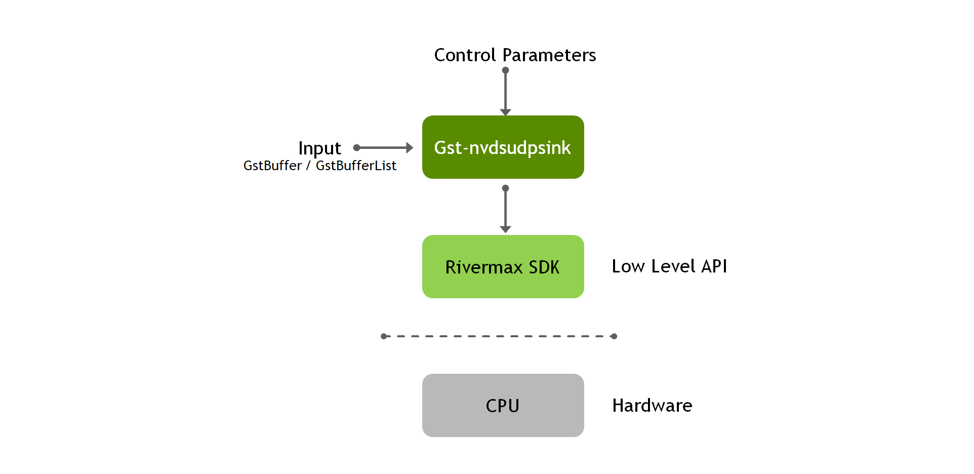

The Gst-nvdsudpsink plugin is a sink type component which can be used to transmit the RTP packets over IP network. Internally, the plugin uses Rivermax SDK APIs for network communications. NVIDIA Rivermax® offers a unique IP-based solution for any media and data streaming use case. For more details see the Rivermax Product Page.

Inputs and Outputs¶
Inputs
GstBufferList having RTP packets as buffer content.
GstBuffer having uncompressed audio or video frame.
Control parameters
LOCAL_IFACE_IP ENV flag or local-iface-ip property
host
port
chunk-size
packets-per-chunk
payload-size
sdp-file
packets-per-line
internal-thread-core
ptp-src
render-thread-core
Output
None
