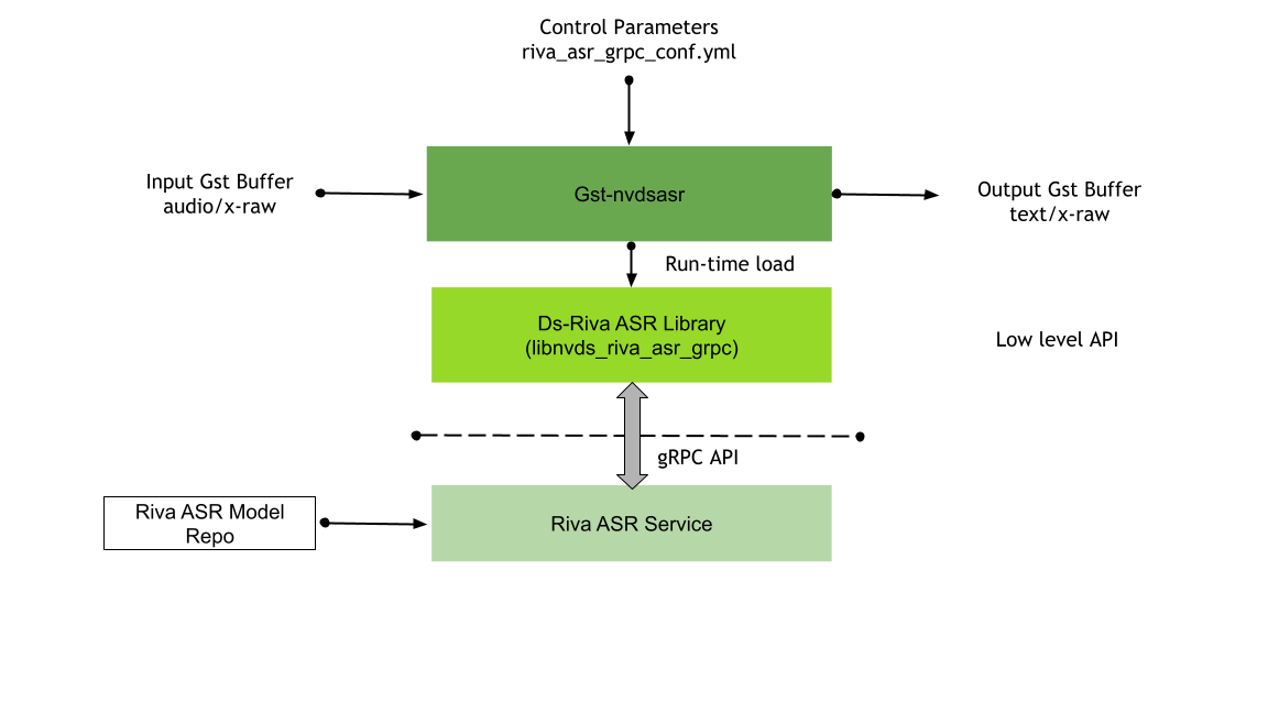

The plugin accepts raw PCM audio Gst
Buffers from upstream component. It transforms audio into generic text Gst
Buffer output.
Model needs raw audio data input with S16LE (Signed 16bit Little Endian). Library settings can be configured via YAML format file (by setting a property on Gst-nvdsasr
plugin) which has multi-part settings for plugin.
As shown in the diagram below input S16LE raw audio data is preprocessed and inferred by the Riva ASR service . The final output is available in UTF8 text.
Inputs and Outputs¶
This section summarizes the inputs, outputs, and communication facilities of the Gst-nvdsasr
plugin with ASR library (gRPC based).
