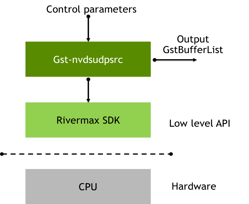

Gst-nvdsudpsrc¶
The Gst-nvdsudpsrc plugin is a source type component which is used to receive the UDP-RTP packets from the network. Internally, the plugin uses Rivermax SDK APIs for network communications. NVIDIA Mellanox Rivermax® offers a unique IP-based solution for any media and data streaming use case. For more details, see the Rivermax Product Page..
Rivermax utilizes the kernel bypass technology and RDMA capabilities to achieve better CPU performance, low latency, and higher bandwidth. On top of Rivermax based enhancements, some of memory and buffer management optimization have been implemented to further reduce the CPU utilization in case of high packet rate use cases.
This component also supports RTP header and payload separation. RTP header and payloads can be received in separate memories. Header will always be in system memory while payload can directly be copied to GPU (Pinned) memory. This can avoid memory copies in cases when GPU processing is performed on the RTP payloads. Header and payload separation will happen only if “header-size” property is set to non-zero value and for fixed header size.
