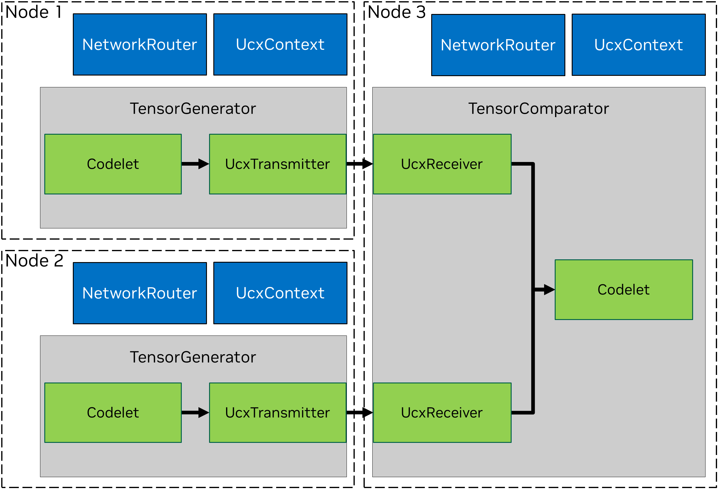

The UCX extension leverages the Unified Communication X (UCX) library to disaggregate a graph in the GXF framework. This extension facilitates graph distribution across multiple hosts, enabling the utilization of distributed GPU resources. UCX, an open-source library, is known for its capability to speed up data across high-performance networks. It can tap into GPUDirect RDMA technology to optimize network latencies and maximize distributed GPU traffic throughput. As a result, users of this extension can harness the combined processing power of multiple GPUs across diverse hosts. This can lead to substantial improvements in the speed and efficiency of workflows. For more UCX details, visit https://openucx.org.
For Example
The subsequent diagram illustrates a disaggregated graph, composed of two tensor generators and a tensor comparator. This tensor comparator assesses the outputs produced by these tensor generators. The UcxExtension offers the capability to execute each entity on a distinct host.
For this, every graph that uses the UCX extension needs a UcxContext component. This component hosts the UCP context and takes care of all connections, manages the data, and ensures that all operations close properly at deinitialization. When you’re setting up your graph, replace your entity’s standard transmitter and receiver with the UcxTransmitter and UcxReceiver components. Be sure to configure all the parameters, including the IP, port, and others, to establish the connection properly.
