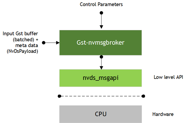

Gst-nvmsgbroker¶
This plugin sends payload messages to the server using a specified communication protocol. It accepts any buffer that has NvDsPayload metadata attached and uses the nvds_msgapi_* interface to send the messages to the server. You must implement the nvds_msgapi_* interface for the protocol to be used and specify the implementing library in the proto-lib property.
Inputs and Outputs¶
Inputs
Gst Buffer with NvDsPayload
Control parameters
Config
conn-str
proto-lib
comp-id
topic
new-api
Output
None, as this is a sink component

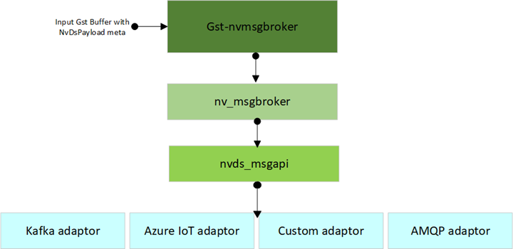

new-api |
To use protocol adapter library apis directly or use new msgbroker library wrapper apis |
Integer 0 : Use adapter api’s directly 1 : msgbroker lib wrapper api’s (Refer to nv_msgbroker: Message Broker interface) |
new-api = 0 |
dGPU Jetson |

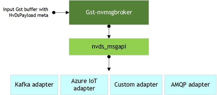

nvds_msgapi: Protocol Adapter Interface¶
You can use the DeepStream messaging interface, nvds_msgapi, to implement a custom protocol message handler and integrate it with DeepStream applications. Such a message handler, known as a protocol adapter, enables you to integrate DeepStream applications with backend data sources, such as data stored in the cloud.
The Gst-nvmsgbroker plugin calls the functions in your protocol adapter as shown in the figure above. These functions support:
Creating a connection
Sending messages by synchronous or asynchronous means
Terminating the connection
Coordinating the client’s and protocol adapter’s use of CPU resources and threads
Getting the protocol adapter’s version number
The nvds_msgapi interface is defined in the header file source/includes/nvds_msgapi.h. This header file defines a set of function pointers which provide an interface analogous to an interface in C++.
The following sections describe the methods defined by the nvds_msgapi interface.

The nvmsgbroker interface is defined in the header file source/includes/nvmsgbroker.h. This header file defines a set of function pointers which provide an interface analogous to an interface in C++.
The following sections describe the methods defined by the nvmsgbroker interface.
nv_msgbroker_connect(): Create a Connection¶
NvMsgBrokerClientHandle nv_msgbroker_connect(char *broker_conn_str, char *broker_proto_lib, nv_msgbroker_connect_cb_t connect_cb, char *cfg);
The function accepts a connection string and configures a connection. The broker adapter proto lib implementation can choose whether the function makes a connection to accommodate connectionless protocols such as HTTP.
Parameters
broker_conn_str: A connection string with format specific for protocol adapterbroker_proto_lib: Full Path to Message protocol adapter libraryconnect_cb: A pointer to a callback function for events associated with the connection.Cfg: Pathname of a configuration file passed to be passed to the protocol adapterConnect callback
typedef void (*nv_msgbroker_connect_cb_t)(NvMsgBrokerClientHandle h_ptr, NvMsgBrokerErrorType status ); Where the callback’s parameters are: * ``h_ptr`` : The connection handle to identify the initiating call. * ``status``: A code that indicates the status of the connection.
Return Value
A connection handle for use in subsequent interface calls if successful, or NULL otherwise.
nv_msgbroker_send_async(): Send an event asynchronously¶
NvMsgBrokerErrorType nv_msgbroker_send_async (NvMsgBrokerClientHandle h_ptr, NvMsgBrokerClientMsg message, nv_msgbroker_send_cb_t cb, void *user_ctx);
The API sends data to the endpoint of a connection. It accepts a message topic and a message payload. Send is asynchronous; it accepts a callback function that is called when the “send” operation is completed.
Parameters
h_ptr: connection handle to Message Broker librarymessage: Message packet which has details of message payload, payload length , topiccb: callback to be invoked to notify status of senduser_ctx: pointer to pass to callback for contextMessage Packet structure
typedef struct { char *topic; void *payload; size_t payload_len; } NvMsgBrokerClientMsg;
Send callback
typedef void (*nv_msgbroker_send_cb_t)(void *user_ptr, NvMsgBrokerErrorType flag); Where the callback’s parameters are: * ``user_ptr``: The user pointer (user_ptr) from the call to ``nv_msgbroker_send_async()`` that initiated the “send” operation. Enables the callback function to identify the initiating call. * ``flag``: A code that indicates the completion status of the send operation.
nv_msgbroker_subscribe(): Consume data by subscribing to topics¶
NvMsgBrokerErrorType nv_msgbroker_subscribe(NvMsgBrokerClientHandle h_ptr, char ** topics, int num_topics, nv_msgbroker_subscribe_cb_t cb, void *user_ctx);
This API is used to subscribe to topic(s) and consume messages from the external entity.
The API is asynchronous and must be called with an already created valid connection handle as parameter. The caller must also provide a pointer to the callback function to receive the consumed messages from the connection endpoint and an optional user_ctx pointer for specifying user context
Parameters
h_ptr: A handle for the connection, obtained by a call tonv_msgbroker_connect()topics: A 2d pointer which points to a char array of topic namesnum_topics: num of topics to subscribecb: A pointer to a callback function to get notified of the consumed messages on subscribed topic(s)user_ctx: user ptr to be passed to callback for contextThe pointer to a callback function which is specified as a param in subscribe API is of type nv_msgbroker_subscribe_cb_t defined as:
typedef void (*nv_msgbroker_subscribe_cb_t)(NvMsgBrokerErrorType flag, void *msg, int msglen, char *topic, void *user_ptr);
flag: To specify the error status of message consumedmsg: Consumed message / payloadmsg_len: Length of message in bytestopic: Topic name where the message was receiveduser_ptr: pointer passed during subscribe() for context
nv_msgbroker_disconnect(): Terminate a Connection¶
NvMsgBrokerErrorType nv_msgbroker_disconnect(NvMsgBrokerClientHandle h_ptr);
The function terminates the connection, if the underlying protocol requires it, and frees resources associated with h_ptr.
Parameters
nv_msgbroker_version(): Get Version Number¶
char *nv_msgbroker_version();
This function returns a string that identifies the nv_msgbroker version supported by this protocol adapter implementation. The string must use the format <major>.<minor>, where <major> is a major version number and <minor> is a minor version number. A change in the major version number indicates an API change that may cause incompatibility. When the major version number changes, the minor version number is reset to 1.
