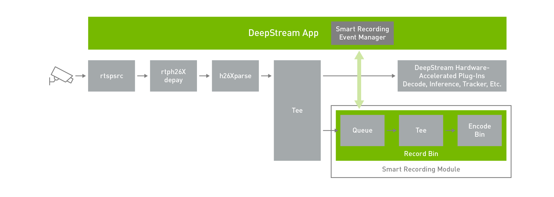

Smart video record is used for event (local or cloud) based recording of original data feed. Only the data feed with events of importance is recorded instead of always saving the whole feed. This recording happens in parallel to the inference pipeline running over the feed. A video cache is maintained so that recorded video has frames both before and after the event is generated. The size of the video cache can be configured per use case.
In smart record, encoded frames are cached to save on CPU memory. Based on the event, these cached frames are encapsulated under the chosen container to generate the recorded video. This means, the recording cannot be started until we have an Iframe. The first frame in the cache may not be an Iframe, so, some frames from the cache are dropped to fulfil this condition. This causes the duration of the generated video to be less than the value specified.
Below diagram shows the smart record architecture:
