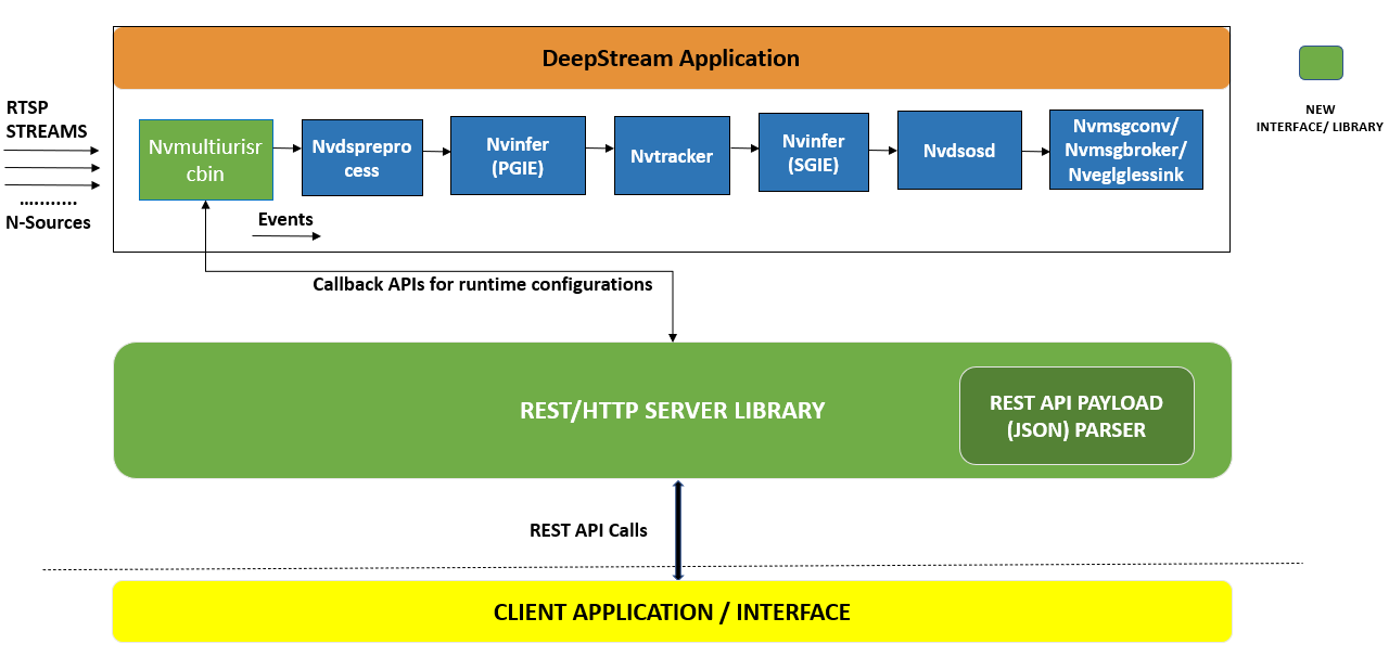

DeepStream With REST API Sever (Alpha)¶
DeepStream application supports runtime parameter configuration for certain components with the help of REST APIs. DeepStream application should run as a server for this feature.
Rest Server support is enabled for both x86 (DeepStream-6.2 release onwards) and Jetson (DeepStream-6.3 release onwards). REST Server library integrates the HTTP server using the “Civetweb” OSS library to process the REST API endpoints. REST Server library implements various component specific endpoints handling. Also, REST API Payload Parser is integrated using the “jsoncpp” OSS library to parse JSON format payload. New nvmultiurisrcbin implements callback APIs for runtime parameter configuration of the supported components in the native DeepStream gstreamer pipeline. Upon receiving the HTTP POST request for the REST API, relevant callbacks implemented with the nvmultiurisrcbin creates new custom gstreamer events which gets injected into the native gstreamer pipeline. Applicable gstreamer component intercepts the custom event to runtime configure the relevant component in the native gstreamer pipeline. A sample app deepstream-server-app is also provided at /opt/nvidia/deepstream/deepstream/sources/apps/sample_apps/deepstream-server for reference. These interfaces sources are available in the DeepStream SDK package. This should provide users with readily available infrastructure to define and implement their own custom REST APIs support for various DeepStream components (Please refer “How to add custom REST API support” section below). REST server is instantiated by default inside nvmultiurisrcbin plugin.
Refer to Gst-nvmultiurisrcbin (Alpha) for “nvmultiurisrcbin” details.
Features¶
The sample deepstream-server application can be used to demonstrate usage of REST APIs to configure DeepStream component parameters at runtime. Currently supported REST APIs to configure the DeepStream pipeline as mentioned below:
The following table summarizes the supported REST APIs:

nvds_rest_server¶
nvds_rest_server is a custom DeepStream library open sourced with DeepStreamSDK package at /opt/nvidia/deepstream/deepstream/sources/libs/nvds_rest_server/. Users are encouraged to use this library as-is or make modifications to support custom use cases. This library could be integrated into a Gstreamer plugin, GStreamer bin, or a DeepStream application. With DS 6.2 release onwards, nvds_rest_server library is integrated with Gst-nvmultiurisrcbin (Alpha) to support runtime sensor addition and removal over REST API.
deepstream-server-app¶
The deepstream-server-app sample application is provided at /opt/nvidia/deepstream/deepstream/sources/apps/sample_apps/deepstream-server.
The reference application demonstrates REST API usage to configure DeepStream plugin parameters at runtime using nvmultiurisrcbin or using low level nvds_rest_server library APIs directly.
Refer to the README at /opt/nvidia/deepstream/deepstream/sources/apps/sample_apps/deepstream-server/README for application usage, payload schema and REST API endpoints details.

How to add custom REST API support¶
Users should follow the below sections. Each section explains detailed steps to implement new custom REST API support.
REST API endpoints implementation
Custom event generation
Callback implementation for REST API endpoints
