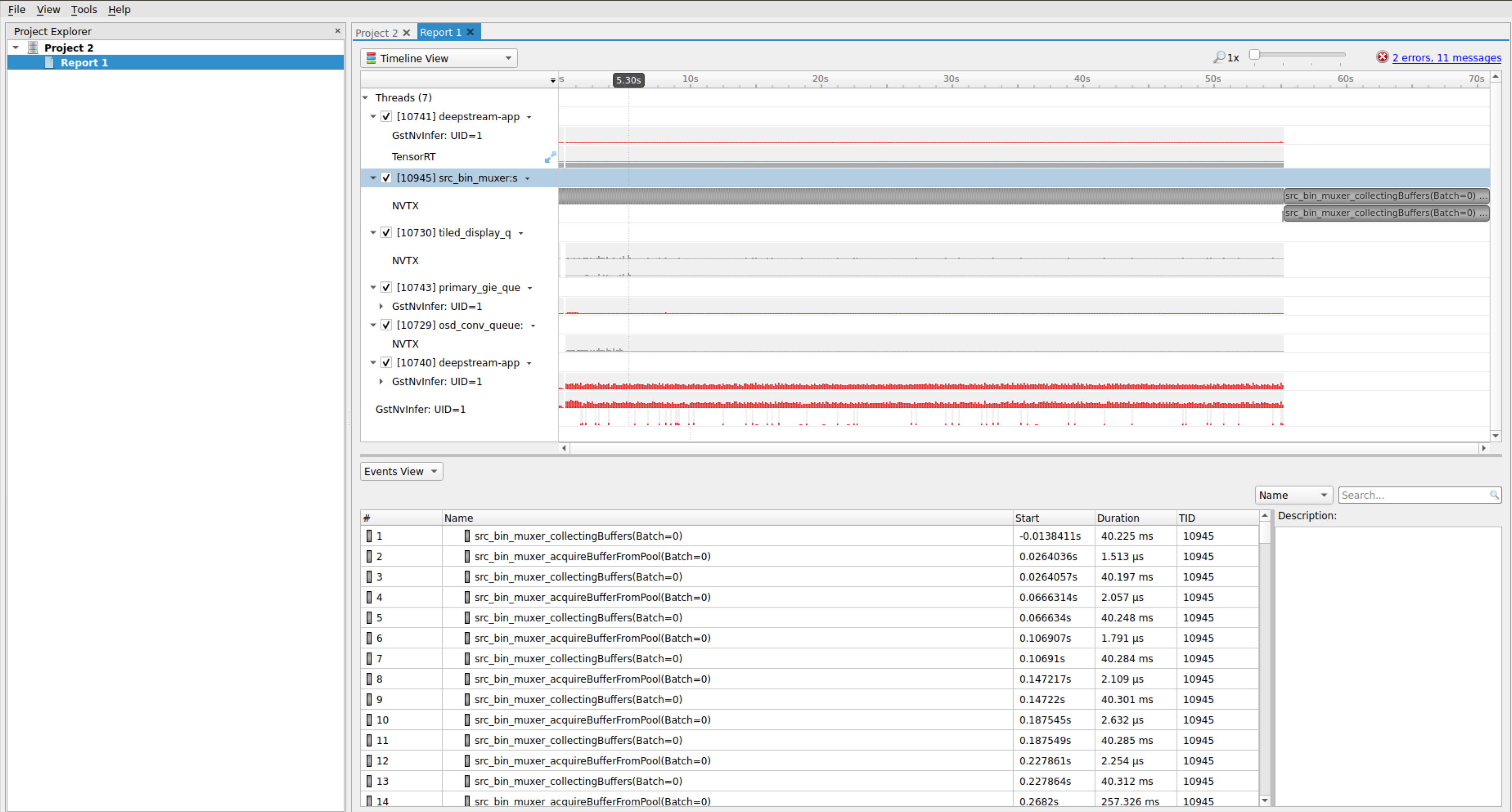

How do I profile DeepStream pipeline?¶
You can use NVIDIA® Nsight™ Systems, a system-wide performance analysis tool. See https://developer.nvidia.com/nsight-systems for more details.

Profiling using NVTX¶
NVIDIA® Tools Extension SDK (NVTX) provides APIs for annotating events, code ranges, and resources in an application. The core GStreamer plugins in DeepStreamSDK have integrated NVTX and the events and ranges can be captured and visualized using NVIDIA Nsight tool, Tegra System Profiler, and Visual Profiler to capture and visualize these events and ranges. For more information on NVTX, visit https://docs.nvidia.com/gameworks/content/gameworkslibrary/nvtx/nvidia_tools_extension_library_nvtx.htm. Following are the instructions on how to capture and visualize these events using deepstream-app with NVIDIA Nsight tool:
Download and install Nsight tool from https://developer.nvidia.com/nsight-systems. Installation can be done using any file (.deb, .run or .rpm).
Run the following command on terminal:
$ nsys-ui
Click on File -> New Project
Select target system as “Target for profiling”.
Now the deepstream-app process needs to be launched by Nsight tool for profiling. In order to do that, add the following command in “Command line with arguments”:
deepstream-app -c /opt/nvidia/deepstream/deepstream/samples/configs/deepstream-app/source30_1080p_dec_infer-resnet_tiled_display_int8.txt
In the tick box options, enable “Collect NVTX trace”. User can select other custom options as per requirement on the tool.
To begin profiling, click on “Start”.
Manually stop collection of traces once application run is completed.
Once collection is stopped, in analytics view, the framewise analysis of each plugin will be shown, which gives an idea of time taken by each plugin.
For more information about performance settings, refer “Performance” section of troubleshooting page.
