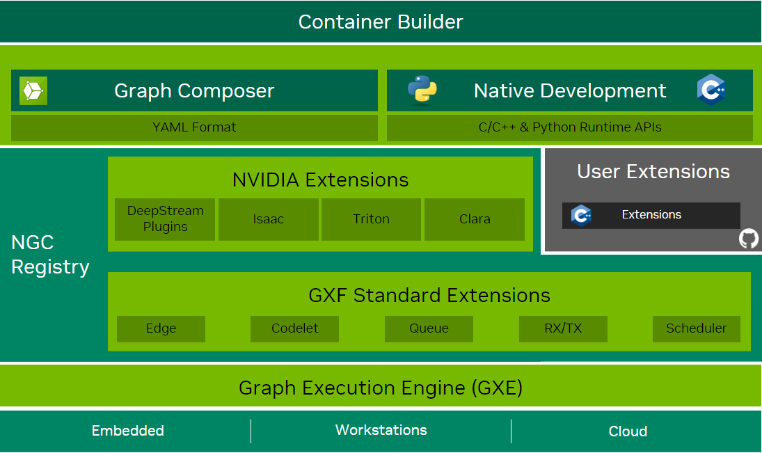

Graph Composer is a tool suite to enable users to build and deploy high-performance AI applications in the form of graph using GUI with minimal (to no) C/C++ coding. These tools built around the core principle of a graph based on GXF_Specification and provide complete ecosystem from extension development to graph deploy as shown in the diagram below
