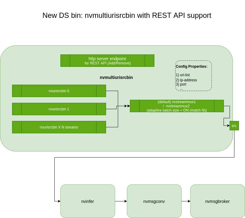

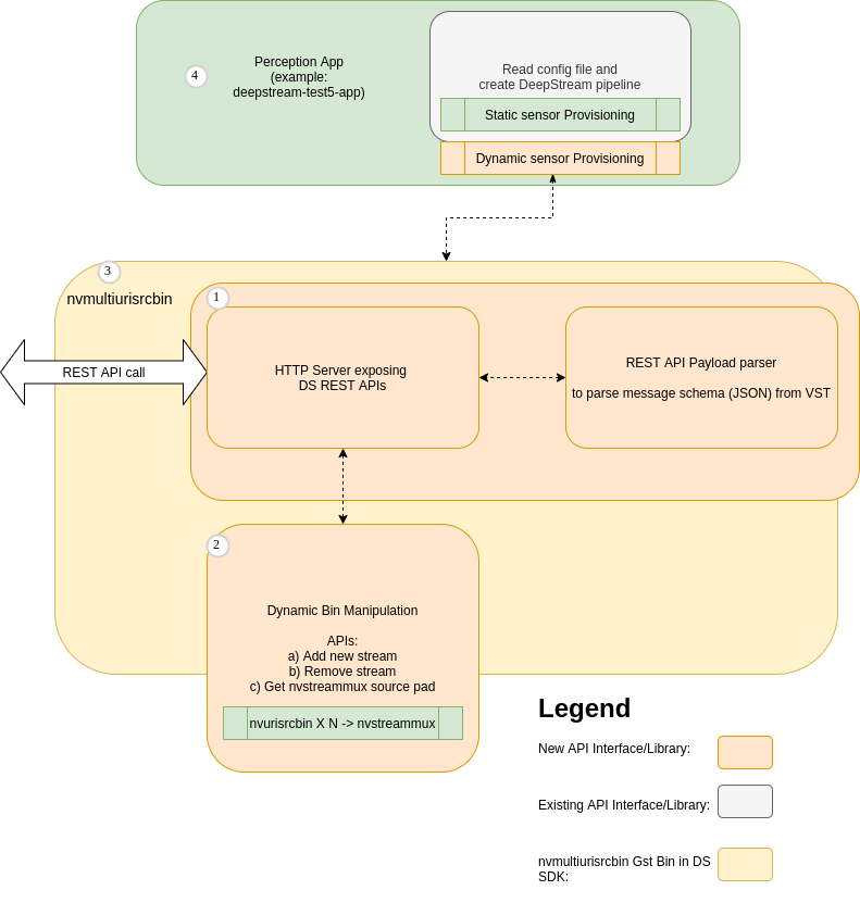

The DeepStream 6.3 introduces nvmultiurisrcbin with REST API support for dynamic sensor add/remove capability. This is an Alpha feature.
This bin integrates three major DeepStream components viz. nvds_rest_server, nvurisrcbin, and nvstreammux (Gst-nvstreammux New / Gst-nvstreammux) into a single GstBin. For more details on nvurisrcbin, please run gst-inspect-1.0 nvurisrcbin on a machine/docker container with DeepStream installed.
The bin allows users to create simple gstreamer pipelines for AI multimedia analytics. Users can add or remove sensors over REST API calls made to a HTTP endpoint. A sensor is defined as a streaming entity with a valid unique Sensor ID, and URI.
The below High Level Overview diagram and table illustrate how nvmultiurisrcbin integrates nvds_rest_server, nvurisrcbin, and nvstreammux.

1. Introduction¶
This GstBin is a GStreamer source bin. The bin exposes only one source pad that provide batched buffers from an nvstreammux instance.
Users can add/remove streams to the bin for batching over the REST APIs defined in the Section REST API Payload definitions.
Users can also provide a static list of streams and their sensor IDs to start the pipeline with. This can be done using the Gst properties uri-list and sensor-id-list described below.
The nvmultiurisrcbin component output batched buffers from an nvstreammux instance.
Users can set environment variable USE_NEW_NVSTREAMMUX=yes to load the Gst-nvstreammux New instead of the default Gst-nvstreammux.

3. How to use nvmultiurisrcbin in a pipeline¶
Below pipeline is a sample gstreamer pipeline which is configured to accept upto 10 input sources and the pipline starts up with two sources:
gst-launch-1.0 nvmultiurisrcbin \
port=9000 ip=localhost \
batched-push-timeout=33333 max-batch-size=10 \
drop-pipeline-eos=1 live-source=1 \
uri-list=file:///opt/nvidia/deepstream/deepstream/samples/streams/sample_1080p_h264.mp4,file:///opt/nvidia/deepstream/deepstream/samples/streams/sample_1080p_h264.mp4 width=1920 height=1080 \
! nvmultistreamtiler ! nveglglessink
Below diagram illustrates a similar pipeline (with different plugins like nvinfer, nvmsgconv, and nvmsgbroker downstream).
