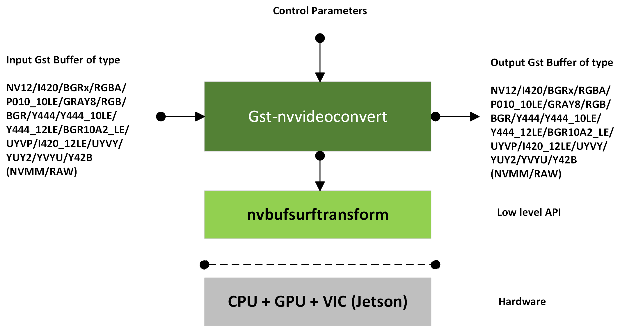

Gst-nvvideoconvert¶
This plugin performs video color format conversion. It accepts NVMM memory as well as RAW (memory allocated using calloc() or malloc() ), and provides NVMM or RAW memory at the output.
Inputs and Outputs¶
Inputs
Gst Buffer batched buffer
NvDsBatchMeta
Format: (NVMM/RAW)
dGPU - NV12, I420, P010_10LE, BGRx, RGBA, GRAY8, RGB, BGR, Y444, Y444_10LE, Y444_12LE, BGR10A2_LE, UYVP, I420_12LE
Jetson - NV12, I420, P010_10LE, BGRx, RGBA, GRAY8, RGB, BGR, BGR10A2_LE, UYVP, UYVY, YUY2, YVYU, Y42B, I420_12LE
Control parameters
gpu-id (dGPU only)
nvbuf-memory-type
src-crop
dst-crop
interpolation-method
compute-hw
flip-method
Output
Gst Buffer
NvDsBatchMeta
Format: (NVMM/RAW)
Note
For 12bit NV12 format, the input/output caps shows I420_12LE. But the data is handled as semiplanar 12 bit data. This is a workaround since gstreamer v1.16 does not have the particular caps for 12 bit NV12. Downstream component should process it considering as 12bit NV12 only.
Only NVMM memory support is added for I420_12LE, Y444_10LE and Y444_12LE formats.
Features¶
This plugin supports scaling and conversion for NVMM to NVMM, RAW to NVMM, and NVMM to RAW and RAW to RAW buffer type conversion. The plugin supports cropping of the input and output frames.
