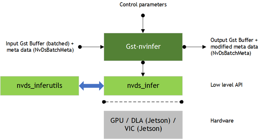

Inputs and Outputs¶
This section summarizes the inputs, outputs, and communication facilities of the Gst-nvinfer plugin.
Inputs
Gst Buffer
NvDsBatchMeta (attaching NvDsFrameMeta)
Caffe Model and Caffe Prototxt
ONNX
UFF file
TAO Encoded Model and Key
Offline: Supports engine files generated by TAO Toolkit SDK Model converters
Layers: Supports all layers supported by TensorRT, see: https://docs.nvidia.com/deeplearning/sdk/tensorrt-developer-guide/index.html.
Control parameters
Gst-nvinfer gets control parameters from a configuration file. You can specify this by setting the property config-file-path. For details, see Gst-nvinfer File Configuration Specifications. Other control parameters that can be set through GObject properties are:
Batch size
Inference interval
Attach inference tensor outputs as buffer metadata
Attach instance mask output as in object metadata
The parameters set through the GObject properties override the parameters in the Gst-nvinfer configuration file.
Outputs
Gst Buffer
Depending on network type and configured parameters, one or more of:
NvDsObjectMeta
NvDsClassifierMeta
NvDsInferSegmentationMeta
NvDsInferTensorMeta
