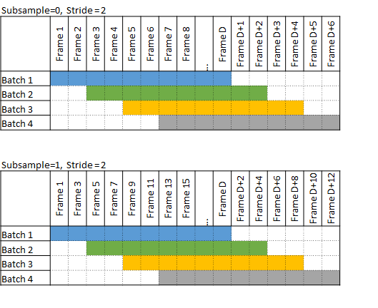

Assume incoming frame numbers are 1, 2, 3, 4, 5, 6, 7, 8, 9, 10, 11, 12, 13, 14, 15… When subsample=1, the preprocessing custom lib will pick up frame numbers: 1,3,5,7,9… to preprocess sequentially and pass it onto inference as a next-step.
Assuming same incoming frame numbers above, For example, when subsample=0, stride=1, the 2 consecutive sliding sequences are:
Batch A: [1,2,3,4,5...] Batch B: [2,3,4,5,6...]
When subsample=0, stride=2, the 2 consecutive sliding sequences are:
Batch A: [1,2,3,4,5...] Batch B: [3,4,5,6,7...]
When subsample=1, stride=2, the subsample is performed first, and sliding sequences are on top of subsample results. The processing frame numbers after subsample are: 1,3,5,7,9,11,13,15,17,19… The consecutive sliding sequences on top of them are:
Batch A: [1,3,5,7,9...] Batch B: [5,7,9,11,13...] # 1st frame sliding from frame 1 of Batch A to frame 5 Batch C: [9,11,13,15,17...] # 1st frame sliding from frame 5 of Batch C to frame 9
The image below shows the frame batches with different subsample and stride settings.
