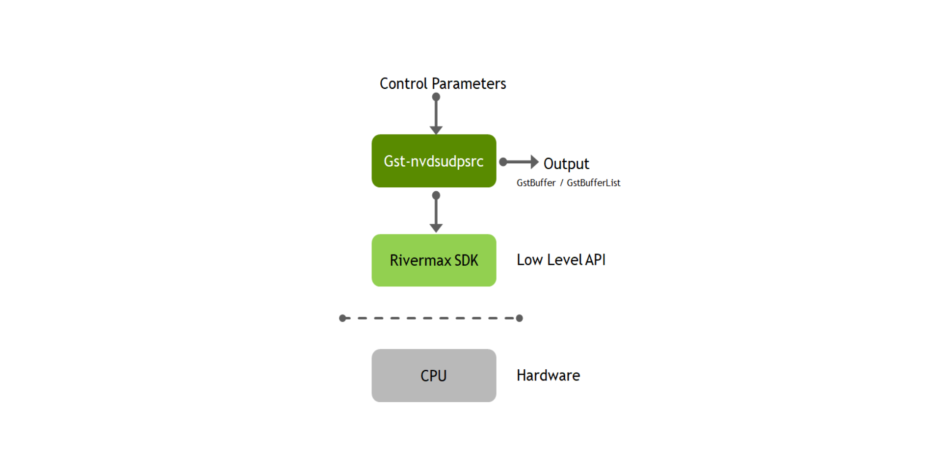

Gst-nvdsudpsrc¶
The Gst-nvdsudpsrc plugin is a source type component which is used to receive the UDP-RTP packets from the network. Internally, the plugin uses Rivermax SDK APIs for network communications. NVIDIA Rivermax® offers a unique IP-based solution for any media and data streaming use case. For more details, see the Rivermax Product Page..
Rivermax utilizes the kernel bypass technology and RDMA capabilities to achieve better CPU performance, low latency, and higher bandwidth. On top of Rivermax based enhancements, some of memory and buffer management optimization have been implemented to further reduce the CPU utilization in case of high packet rate use cases.

Inputs and Outputs¶
Inputs
None
Control parameters
LOCAL_IFACE_IP ENV flag or local-iface-ip property
payload-size
header-size
num-packets
uri
address
port
source-address
caps
gpu-id
payload-multiple
Output
GstBufferList having RTP packets as buffer content.
GstBuffer having uncompressed audio or video frame.
