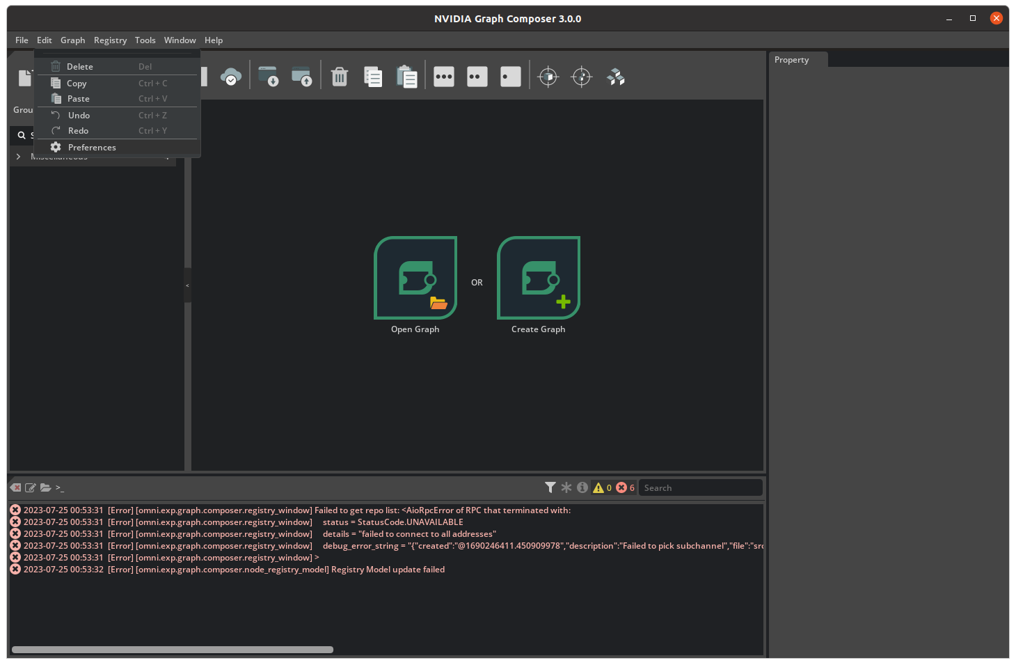

Sync Extensions¶
Before any graph can be executed or container built, extensions from NGC public repo must be synced. Follow the steps below to sync the extensions:

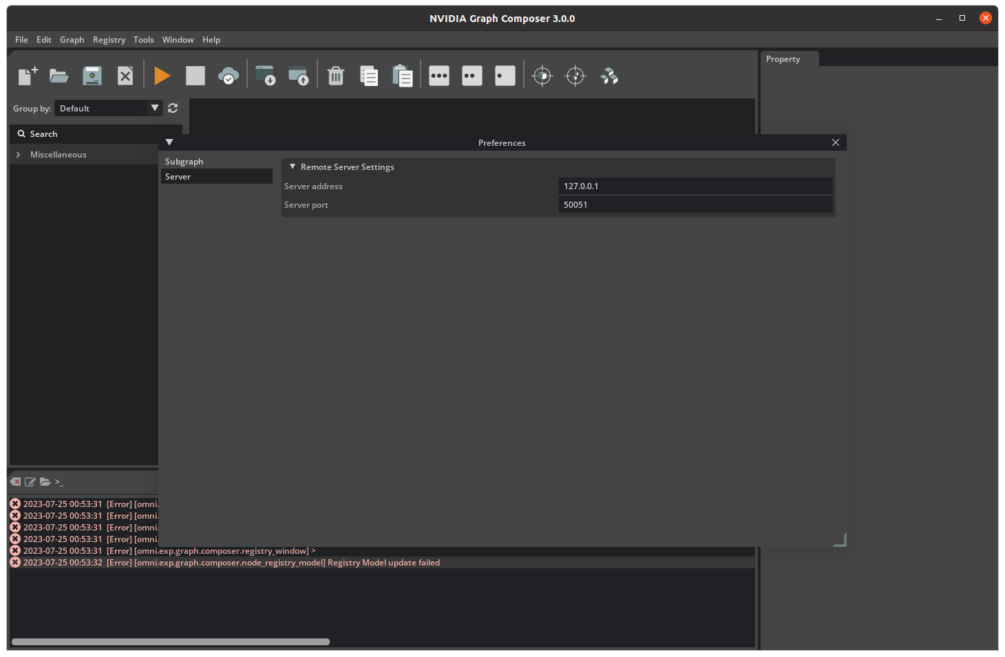

1. Start the gxf_server in a terminal by running the following command:
gxf_server
By default, gxf_server runs on port 50051
. It can be changed by export GXF_SERVER_PORT=<port_number>
Also change the port number in Composer.
- Open the
Preferences
window.![]()
- Change the port number in the server tab.
Be sure no graph is opened. If there is an graph being opened, it must be closed to make the registry menu usable.

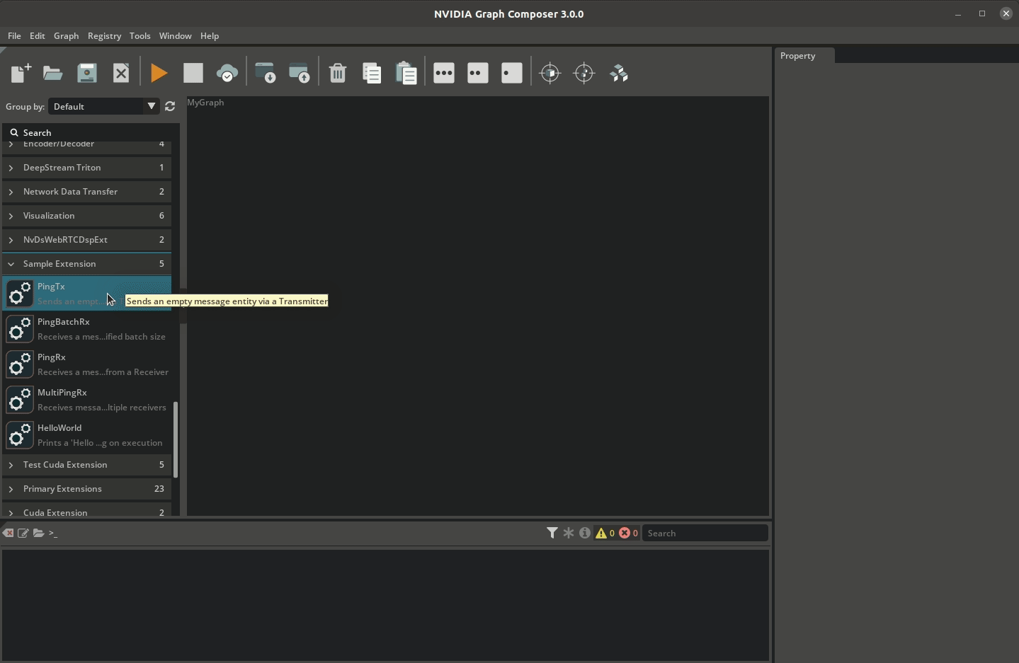

Follow the steps:

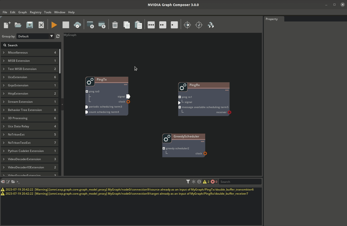

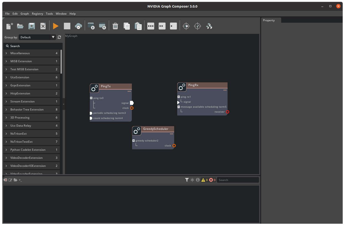

Add PingTx, PingRx and GreedyScheduler by dragging and dropping them from the components panel the graph window.
Add the rest of the components such as CountSchedulingTerm, PeriodicSchedulingTerm and MessageAvailableSchedulingTerm by dragging and dropping into the respective entity node.
Now, right click on the signal in PingTx and click Create DoubleBufferTransmitter. Follow the same steps for PingRx’s signal and GreedyScheduler’s clock.

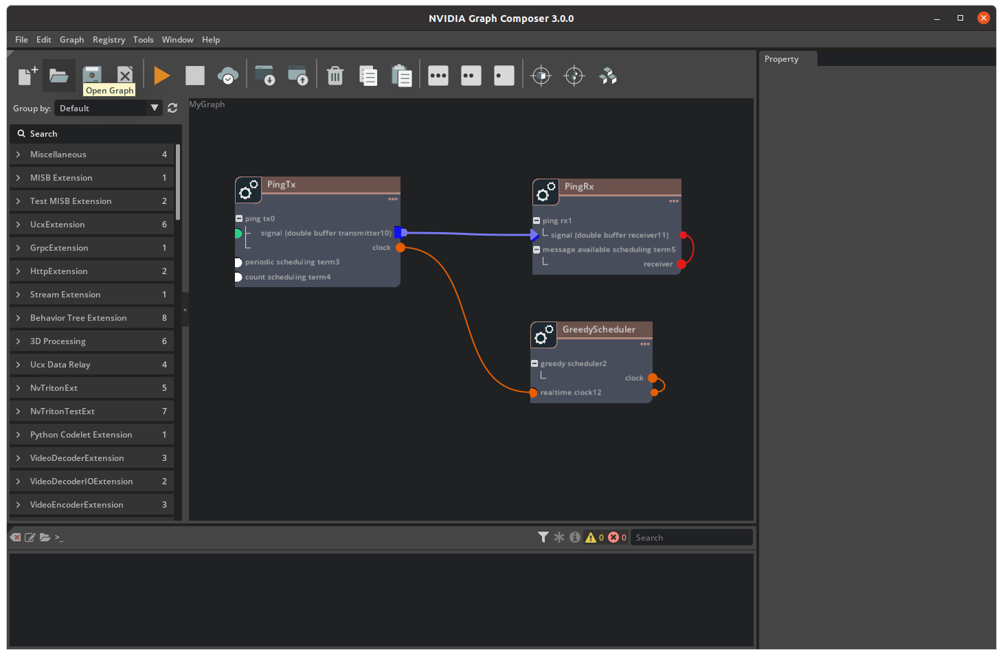

We can create a graph by simply dragging and dropping components from the Component Panel and add more components to it.
After adding the components your graph will look like the image below:

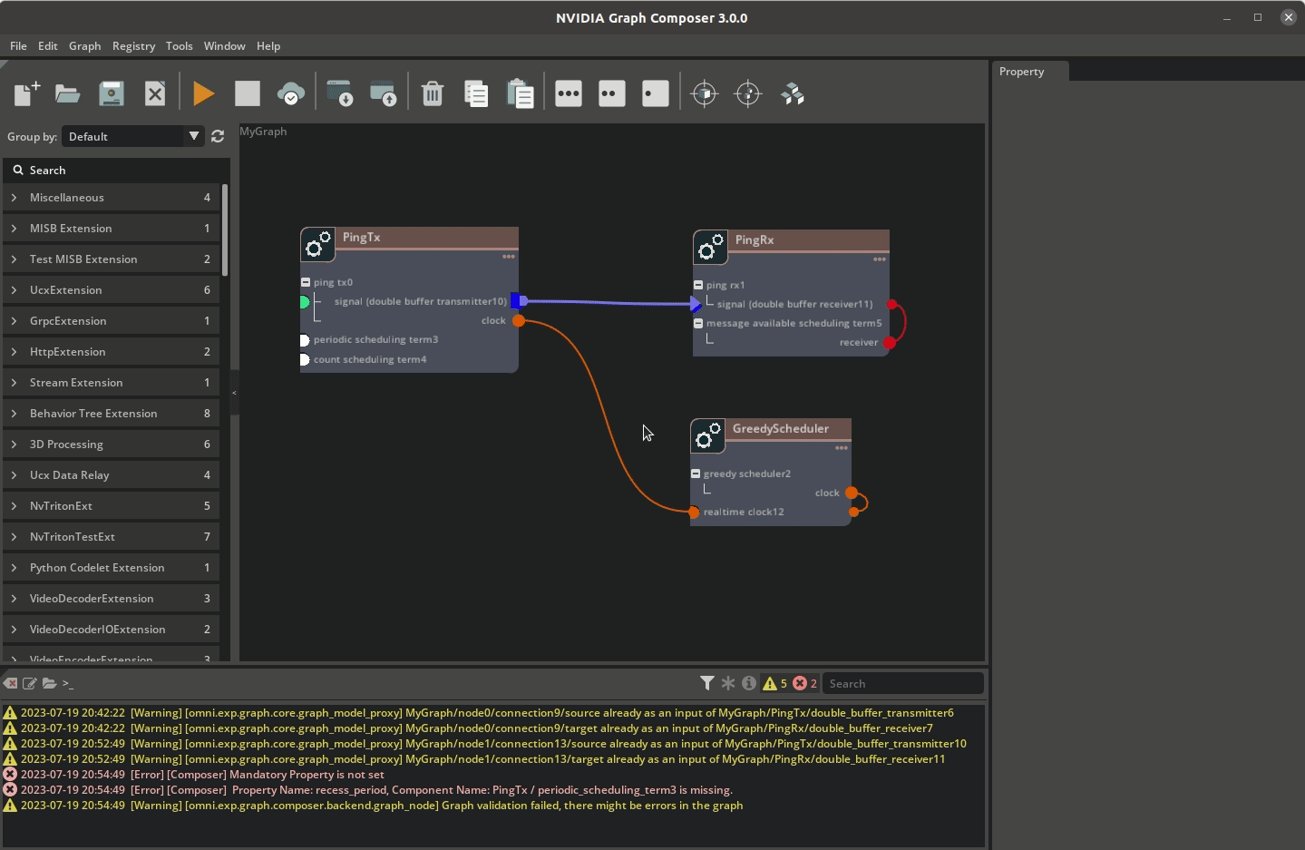

Now we make connections between components. For instance, you will have to connect a DoubleBufferTransmitter
to a DoubleBufferReceiver
to pass messages between them. PingTx/clock
needs to be linked to GreedyScheduler/RealtimeClock
. These connections are made by creating an edge between the components as shown below:
Finally, we have to set the required parameters for the components:
In
PingRx/MessageAvailableSchedulingTerm
: set min_size to1
In
PingTx/CountSchedulingTerm
: set count to5
In
PingTx/PeriodicSchedulingTerm
: set recess_period to5

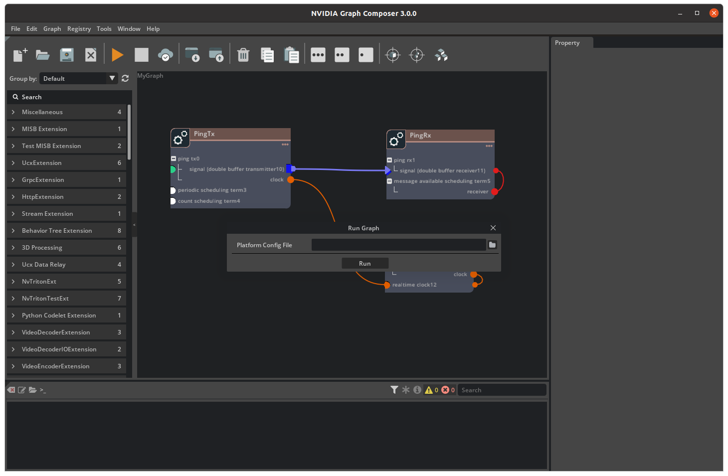

Run Graph from Graph Composer¶
You can deploy the graph using one of the following methods:
To execute the currently open graph, click on the Run Graph
button from the
toolbar on the left. This will open the Run Graph
dialog.
Local System¶
Make sure
gxf_server
is running on the local system and the IP address in the Edit/Preferences is of local host.Select appropriate Platform config file using the file browser.
Click on
Run
. The graph execution progress will be reported via logs in the console window.

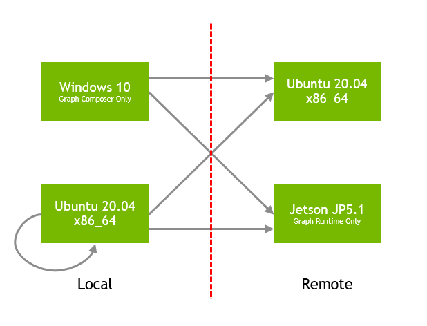

Remote System¶
Execute on Jetson or another remote system
Make sure
gxf_server
is running on the remote system and the IP address in the Edit/Preferences is of remote host.Select appropriate Platform config file (aarch64 or x86_64) based on the remote machine configuration.
Click on
Run
Please note that this requires Graph Composer package be installed on the remote system.
Execute on Jetson or another remote system through Windows
Executing graph through Windows is very similar to executing graph on Jetson or another remote system. Please note that this requires Graph Composer package be installed on the remote system.

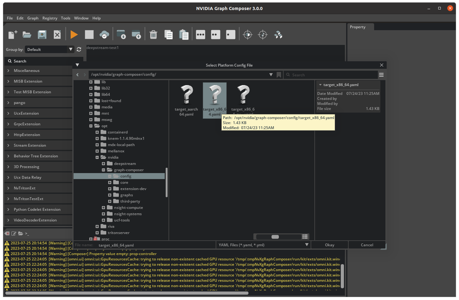

/opt/nvidia/graph-composer/execute_graph.sh <graph-file> -d /opt/nvidia/graph-composer/config/target_x86_64.yaml
To execute on a remote Jetson target, run:
/opt/nvidia/graph-composer/execute_graph.sh <graph-file> -d /opt/nvidia/graph-composer/config/target_aarch64.yaml \

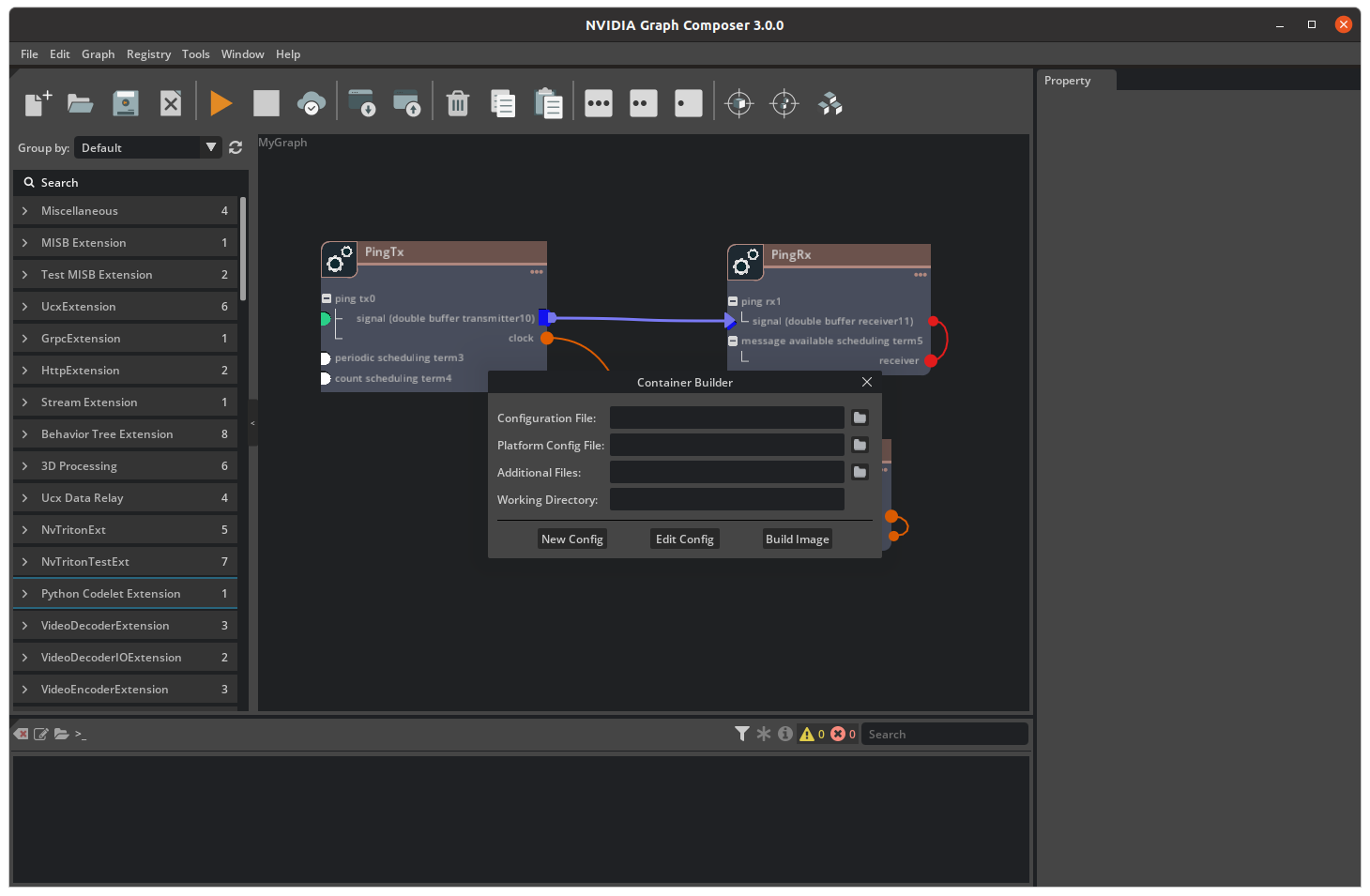

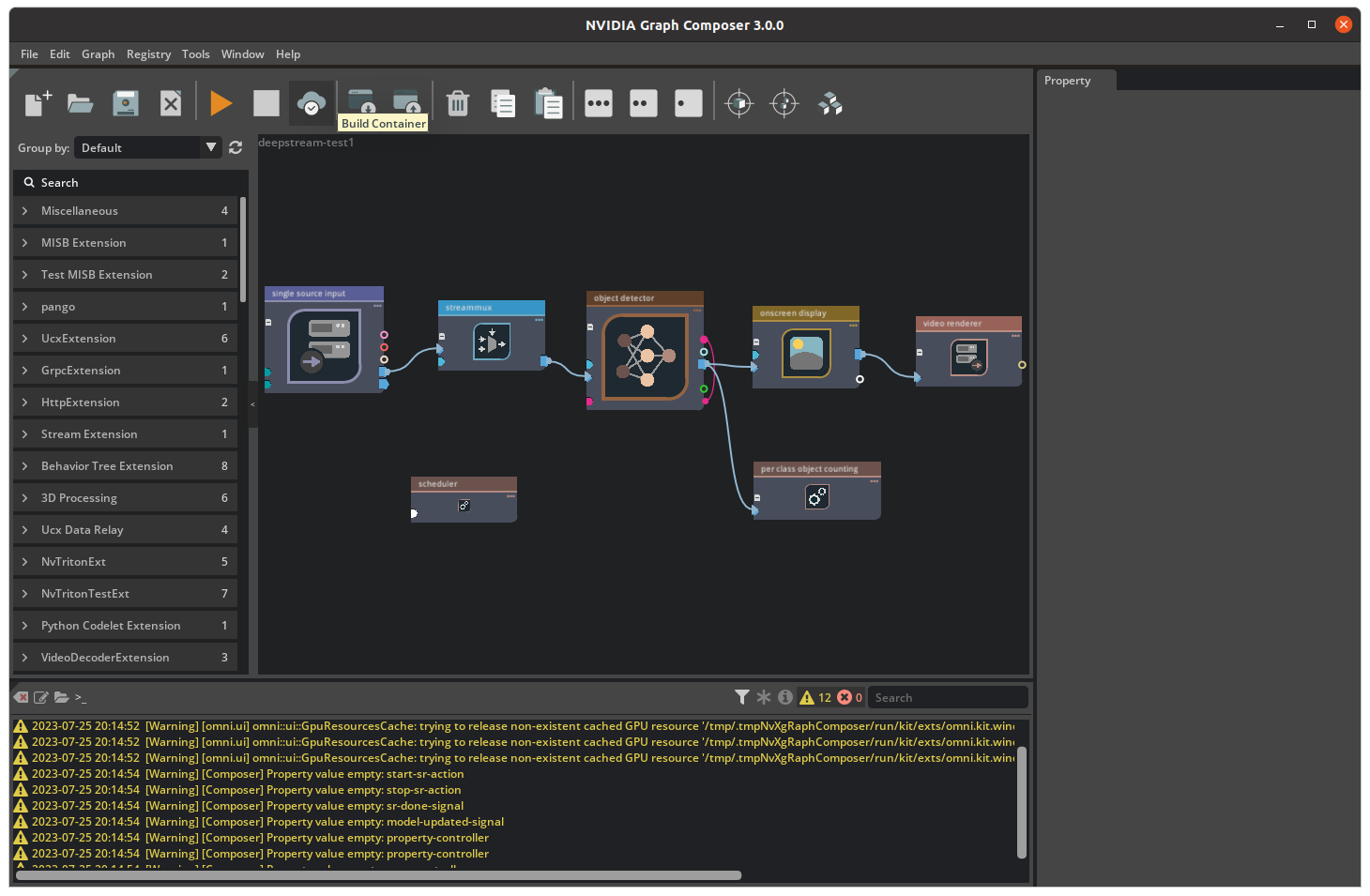

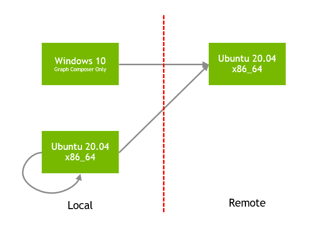

Create Container Image from Graph Composer¶
Container image can be created for Ubuntu 20.04 x86_64 or Jetson but creation is supported only on Ubuntu 20.04 x86_64. Following scenarios are supported for it.
To build a container, first click on the Build Container
button from the
toolbar on the top. This will open the Build Container
window.
Local System¶
For creating a container on the local system,
Make sure
gxf_server
is running on the local system and the IP address in the Edit/Preferences is of local host.Launch the file browser using the button next to the
Configuration File
input.
Select a container builder configuration file and open it.
Click the button next to the
Platform config File
input to launch the file browser. Select a platform config file and open it.
Click on
Build
to start the build process. Composer reports the container build status using a progress bar.
On successful completion, composer will show a success message.
Remote System (Windows)¶
Building container image through Windows is very similar to building container image on linux system.
Add remote system’s IP address and port number in the Server tab in Edit/Preferences window.
For creating a container on the remote system,
Choose the container builder config file and target config file and click on Build Image

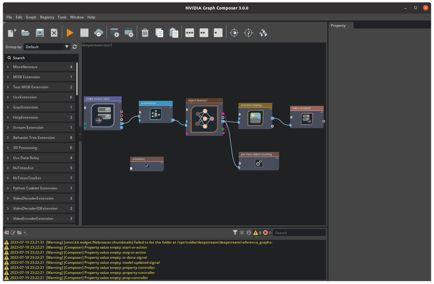

Previous application was simple demonstrating application workflow. Similar workflow can be used to create, load and run DeepStream applications using GXF. It requires that DeepStream 6.3 and reference graphs packages are installed on the system with all the dependencies.

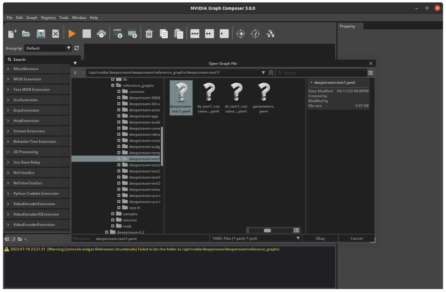

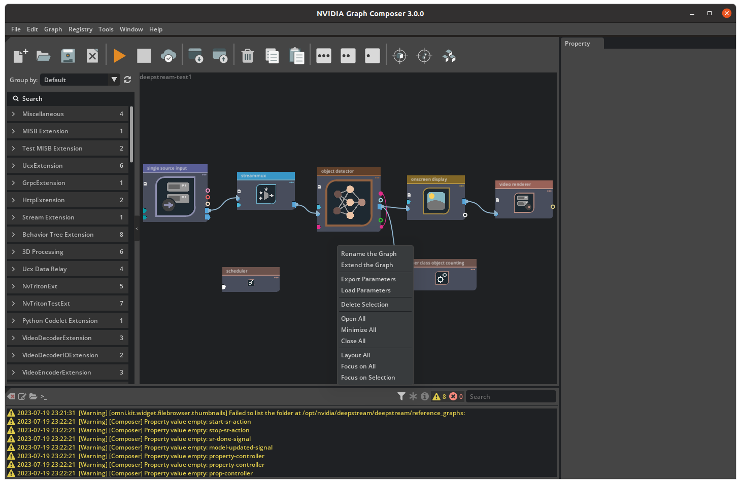

Open the
File
menu from the menubar at the top and click onOpen Graph
to launch the file browser. You may alternatively use theCtrl + O
key combination.
Browse to a valid graph file, select it and click on
Okay
to open the graph.
Composer should now show the application graph.

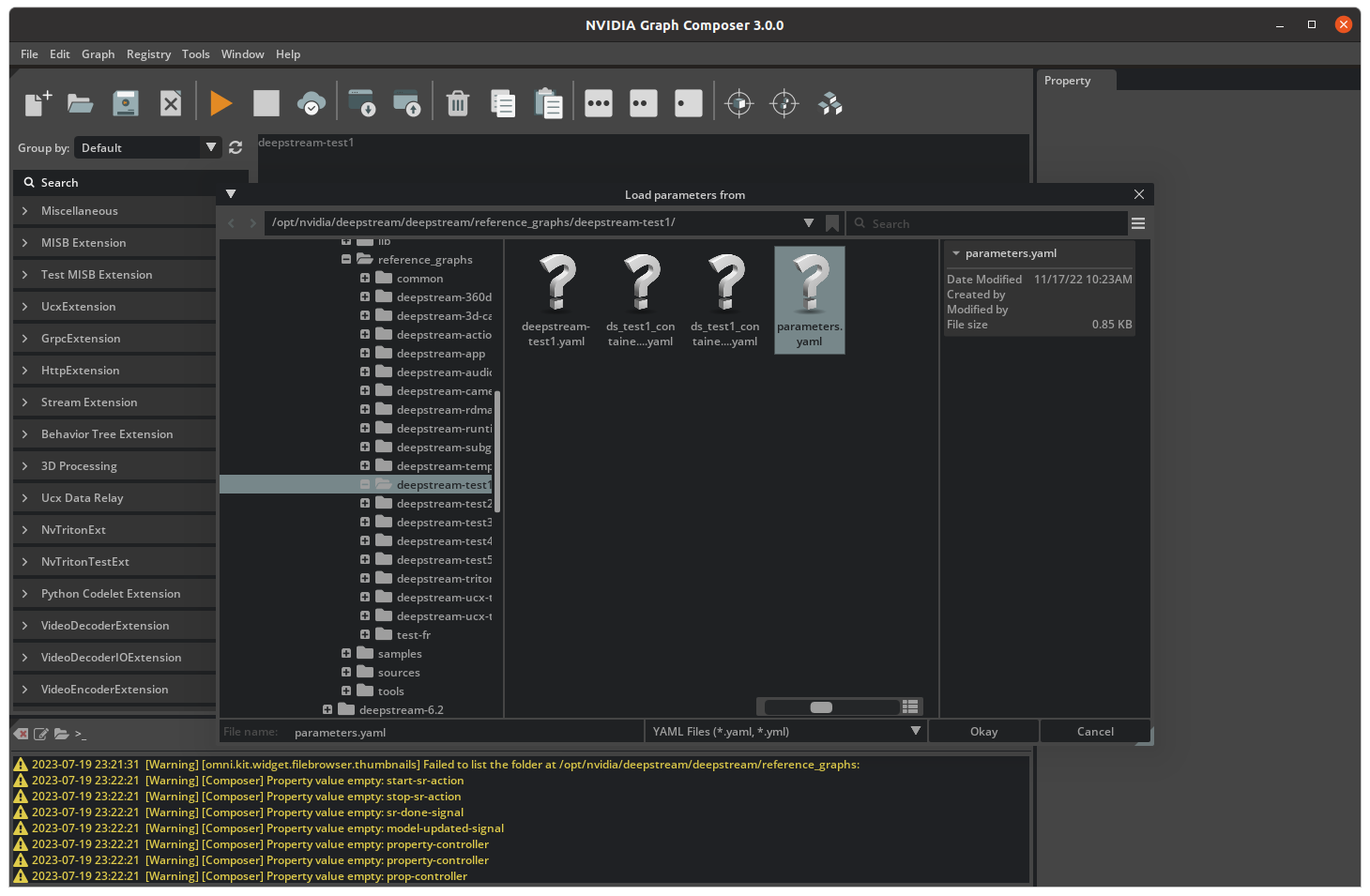

To load component parameters from a separate file, right-click on the graph and select
Load parameters
from the context menu to launch the file browser.
Browse to an appropriate parameters file for the currently open and visible graph, select it and click on
Okay
to load parameter values from the file.
Rest of the steps to run the application or build container image are same as demonstrated earlier.
