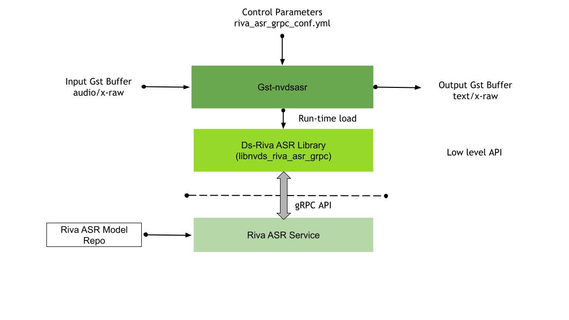

The plugin accepts raw PCM audio GStreamer buffers (GstBuffer
) from upstream component. It transforms audio into generic text GstBuffer
output.
Model needs raw audio data input with S16LE (Signed 16bit Little Endian). Library settings can be configured via YAML format file (by setting a property on Gst-nvdsasr
plugin) which has multi-part settings for plugin.
As shown in the diagram below input S16LE raw audio data is preprocessed and inferred by the Riva ASR service . The final output is available in UTF8 text.
Inputs and Outputs¶
This section summarizes the inputs, outputs, and communication facilities of the Gst-nvdsasr
plugin with the gRPC based ASR library.

DS-Riva ASR Library YAML File Configuration Specifications¶
DS-Riva ASR configuration file uses YAML 1.2 file format: https://yaml.org/spec/1.2/spec.html.
There are multiple parts in the config file. An example for the gRPC
riva_asr_grpc_conf.yml
yml file is located at/opt/nvidia/deepstream/deepstream/sources/apps/audio_apps/deepstream_asr_tts_app/
. Each part has aname
indicating a unique part name and adetail
indicating the setting details.name: riva_server
part configures Riva ASR server settings in its corresponding nodedetail:
.name: riva_model
part configures Riva ASR model entry in its corresponding nodedetail:
.name: riva_asr_stream
part configures Riva low level library supported features in its corresponding nodedetail:
. Each ASR plugin instance will launch a standalone Riva stream. The settings between different plugin instances could be different.name: ds_riva_asr_plugin
part configures DS-Riva ASR settings in its corresponding nodedetail:
.A separator line with
is inserted between the 2 neighbor parts according to YAML specification.
