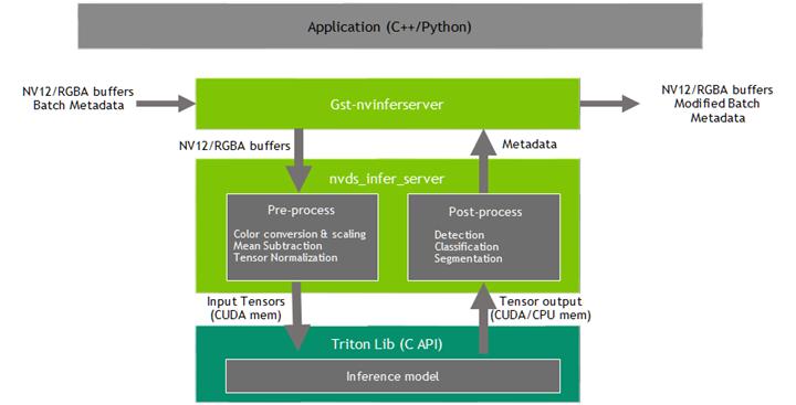

The Gst-nvinferserver plugin does inferencing on input data using NVIDIA® Triton Inference Server (previously called TensorRT Inference Server) Release 2.30.0, NGC Container 23.01 for Jetson and Release 2.26.0, NGC Container 22.09 for dGPU on x86. Refer to the following README https://github.com/triton-inference-server/server/blob/r22.09/README.md
The plugin accepts batched NV12/RGBA buffers from upstream. The NvDsBatchMeta structure must already be attached to the Gst Buffers.
The low-level library (libnvds_infer_server) operates on any of NV12 or RGBA buffers.
The Gst-nvinferserver plugin passes the input batched buffers to the low-level library and waits for the results to be available. Meanwhile, it keeps queuing input buffers to the low-level library as they are received. Once the results are available from the low-level library, the plugin translates and attaches the results back in to Gst-buffer for downstream plugins.
The low-level library preprocesses the transformed frames (performs color conversion and scaling, normalization and mean subtraction) and produces final FP32/FP16/INT8/UINT8/INT16/UINT16/INT32/UINT32 RGB/BGR/GRAY planar/ packed data which is passed to the Triton for inferencing. The output type generated by the low-level library depends on the network type.
The pre-processing function is:
y = netscalefactor * (x - mean)
where:
xis the input pixel value. It is an uint8 with range [0,255].
meanis the corresponding mean value, read either from the mean file or as offsets[c], where c is the channel to which the input pixel belongs, and offsets is the array specified in the configuration file. It is a float.
netscalefactoris the pixel scaling factor specified in the configuration file. It is a float.
yis the corresponding output pixel value. It can be of typefloat / half / int8 / uint8 / int16 / uint16 / int32 / uint32.Take specific example for uint8 to int8 conversion. set
netscalefactor = 1.0andmean = [128, 128, 128]. Then the function looks like:y = (1.0) * (x - 128)
