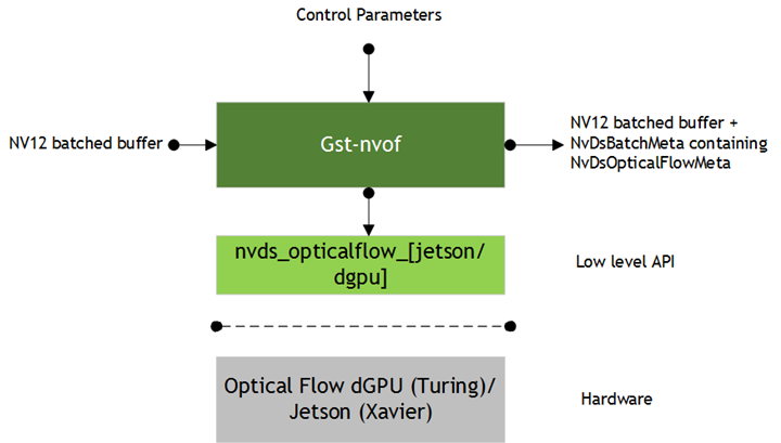

NVIDIA GPUs, starting with the dGPU Turing generation (except TU117 GPU) and Jetson Xavier and Orin generation, contain a hardware accelerator for computing optical flow. Optical flow vectors are useful in various use cases such as object detection and tracking, video frame rate up-conversion, depth estimation, stitching, and so on.
The Gst-nvof plugin collects a pair of NV12 images and passes it to the low-level optical flow library. The low-level library returns a map of flow vectors between the two frames as its output.
The map of flow vectors is encapsulated in the NvDsOpticalFlowMeta structure and is added as a user meta with meta_type set to NVDS_OPTICAL_FLOW_META. The user meta is added to the frame_user_meta_list member of NvDsFrameMeta.

Inputs and Outputs¶
Inputs
GStreamer buffer containing NV12 frame(s)
Control parameters
gpu-id: selects the GPU ID (valid only for dGPU platforms)
dump-of-meta: enables dumping of optical flow map vector into a .bin file
preset-level: sets the preset level
pool-size: sets the pool size
grid-size: sets the grid size
Outputs
NvDsOpticalFlowMeta metadata
