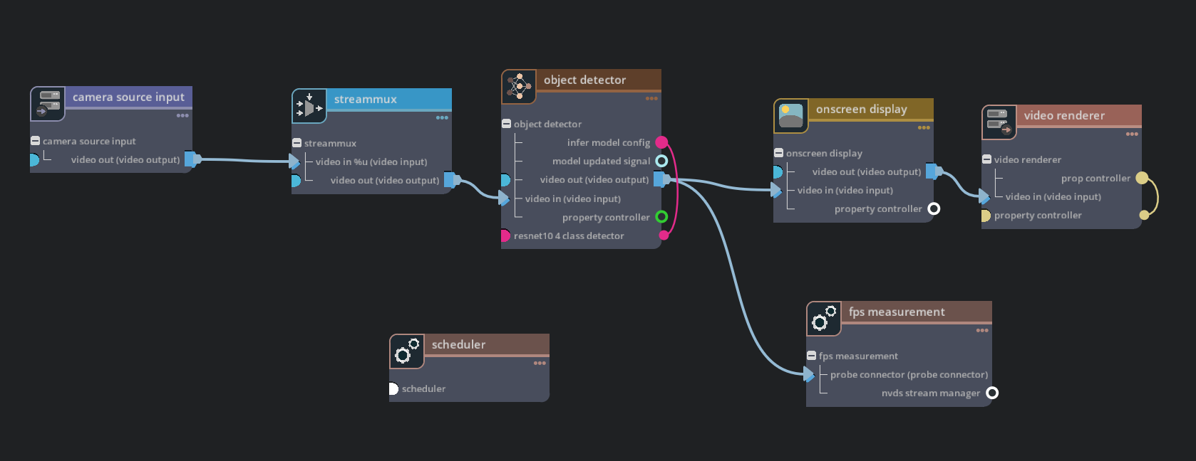

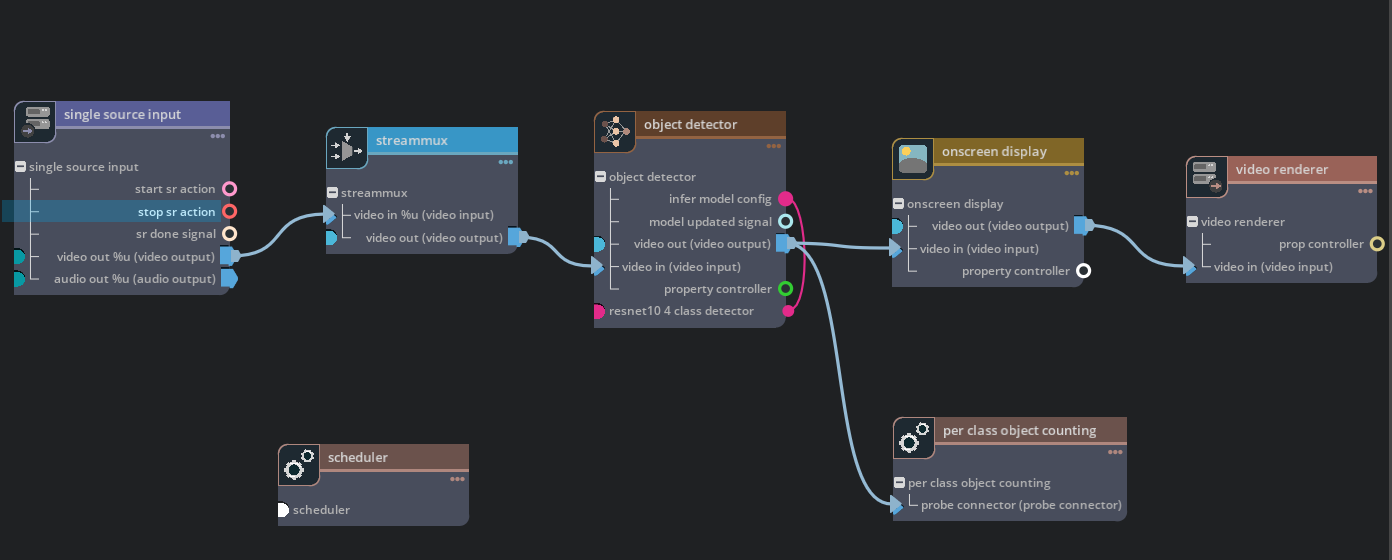

deepstream-test1¶
Simplest example of using DeepStream for object detection. Demonstrates decoding video from a file, performing object detection and overlaying bounding boxes on the frames.
Graph Files¶
deepstream-test1.yaml – The main graph file
parameters.yaml – File containing parameters for the various components in the graph
README - Contains detailed graph description and execution instructions
ds_test1_container_builder_dgpu.yaml - Configuration file for building application specific container for dGPU platform
ds_test1_container_builder_jetson.yaml - Configuration file for building application specific container for Jetson platform
Path - /opt/nvidia/deepstream/deepstream/reference_graphs/deepstream-test1
Sample Commands:
On x86:
$ /opt/nvidia/graph-composer/execute_graph.sh deepstream-test1.yaml \
parameters.yaml -d ../common/target_x86_64.yaml
On Jetson:
parameters.yaml -d ../common/target_aarch64.yaml
Graph¶
Sample Output¶

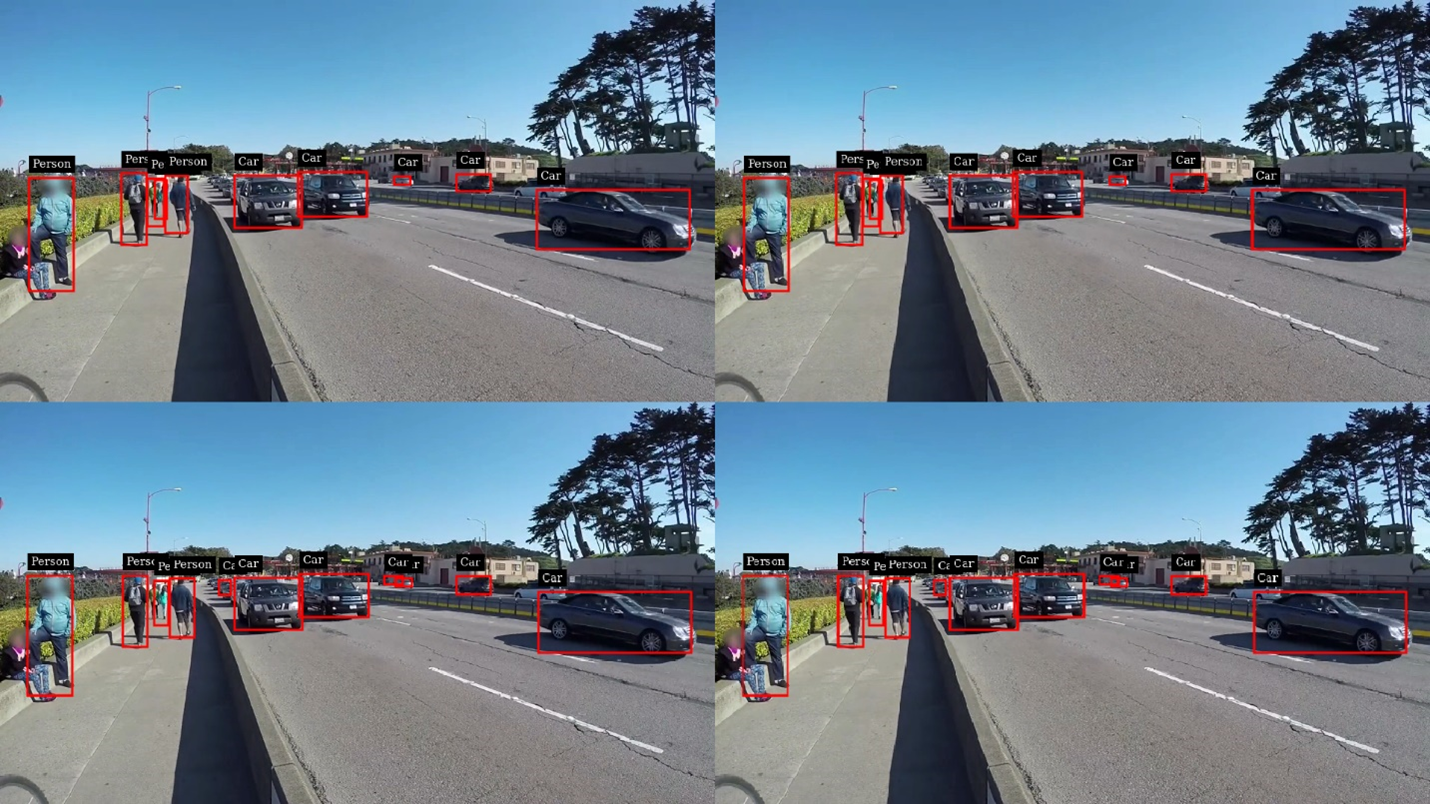

deepstream-test2¶
Builds on top of deepstream-test1 and demonstrates object tracking and cascaded inferencing.
Graph Files¶
deepstream-test2.yaml – The main graph file
ds_test2_container_builder_dgpu.yaml - Configuration file for building application specific container for dGPU platform
ds_test2_container_builder_jetson.yaml - Configuration file for building application specific container for Jetson platform
Path - /opt/nvidia/deepstream/deepstream/reference_graphs/deepstream-test2
Sample Commands:
On x86:
$ /opt/nvidia/graph-composer/execute_graph.sh deepstream-test2.yaml \
On Jetson:
Graph¶
Sample Output¶

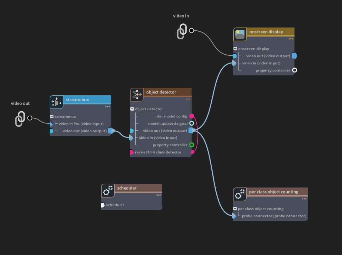

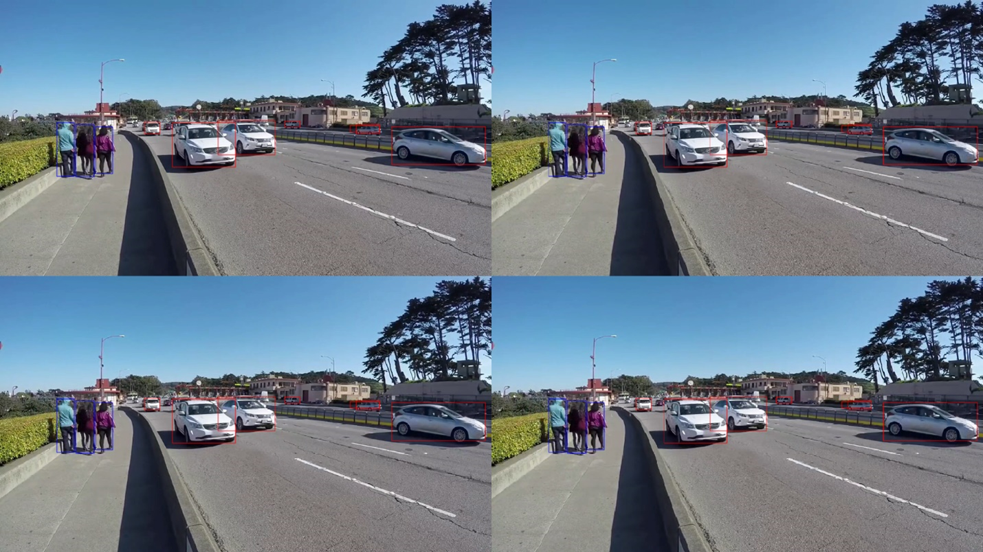

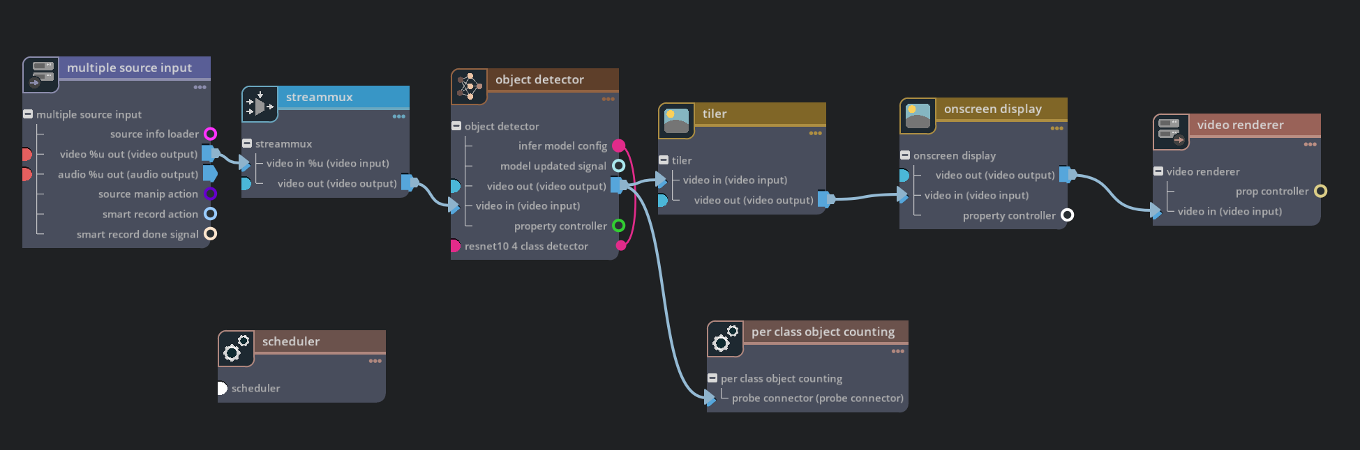

deepstream-test3¶
Builds on top of deepstream-test1 to demonstrate use of multiple sources in the pipeline.
Graph Files¶
deepstream-test3.yaml – The main graph file
ds_test3_container_builder_dgpu.yaml - Configuration file for building application specific container for dGPU platform
ds_test3_container_builder_jetson.yaml - Configuration file for building application specific container for Jetson platform
Path - /opt/nvidia/deepstream/deepstream/reference_graphs/deepstream-test3
Sample Commands:
On x86:
$ /opt/nvidia/graph-composer/execute_graph.sh deepstream-test3.yaml \
On Jetson:
Graph¶
Sample Output¶

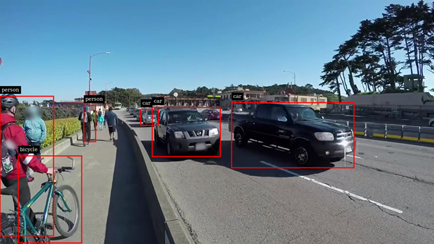

deepstream-test4¶
Builds on top of deepstream-test1 to demonstrate how to send the metadata generated by the DeepStream components to the cloud using messaging components.
Graph Files¶
deepstream-test4.yaml – The main graph file
ds_test4_container_builder_dgpu.yaml - Configuration file for building application specific container for dGPU platform
ds_test4_container_builder_jetson.yaml - Configuration file for building application specific container for Jetson platform
Path - /opt/nvidia/deepstream/deepstream/reference_graphs/deepstream-test4
Sample Commands:
On x86:
$ /opt/nvidia/graph-composer/execute_graph.sh deepstream-test4.yaml \
On Jetson:
Note
A small note on what minimum parameter changes are needed to run the graph on any system
Note
By default the sample is configured to send messages over Kafka and thus needs a Kafka broker running. The graph files assume that the server is running on “localhost:9092”. The server to send messages to along with the topic can be changed by modifying msg-broker-conn-str and topic parameters in the parameters.yaml file.
Graph¶
Sample Output¶
Following is the snapshot from output video. However, the app also sends messages over Kafka which can be viewed using the console consumer utility in the Kafka package or a similar alternative.

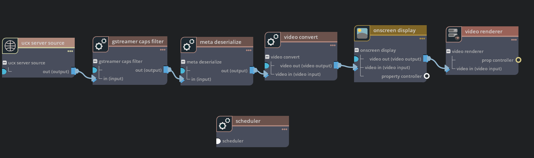

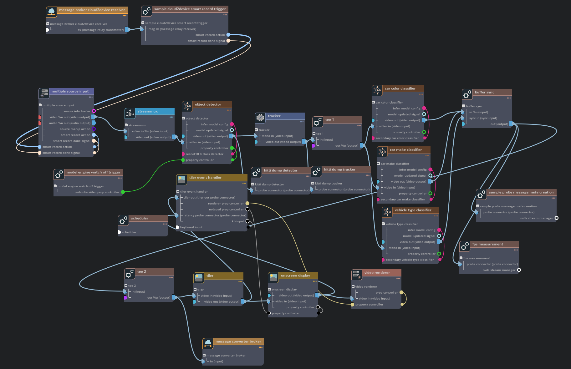

deepstream-test5¶
DeepStream reference application which demonstrates device-to-cloud and cloud-to-device messaging, Smart Record and model on-the-fly update.
Graph¶
Sample Output¶

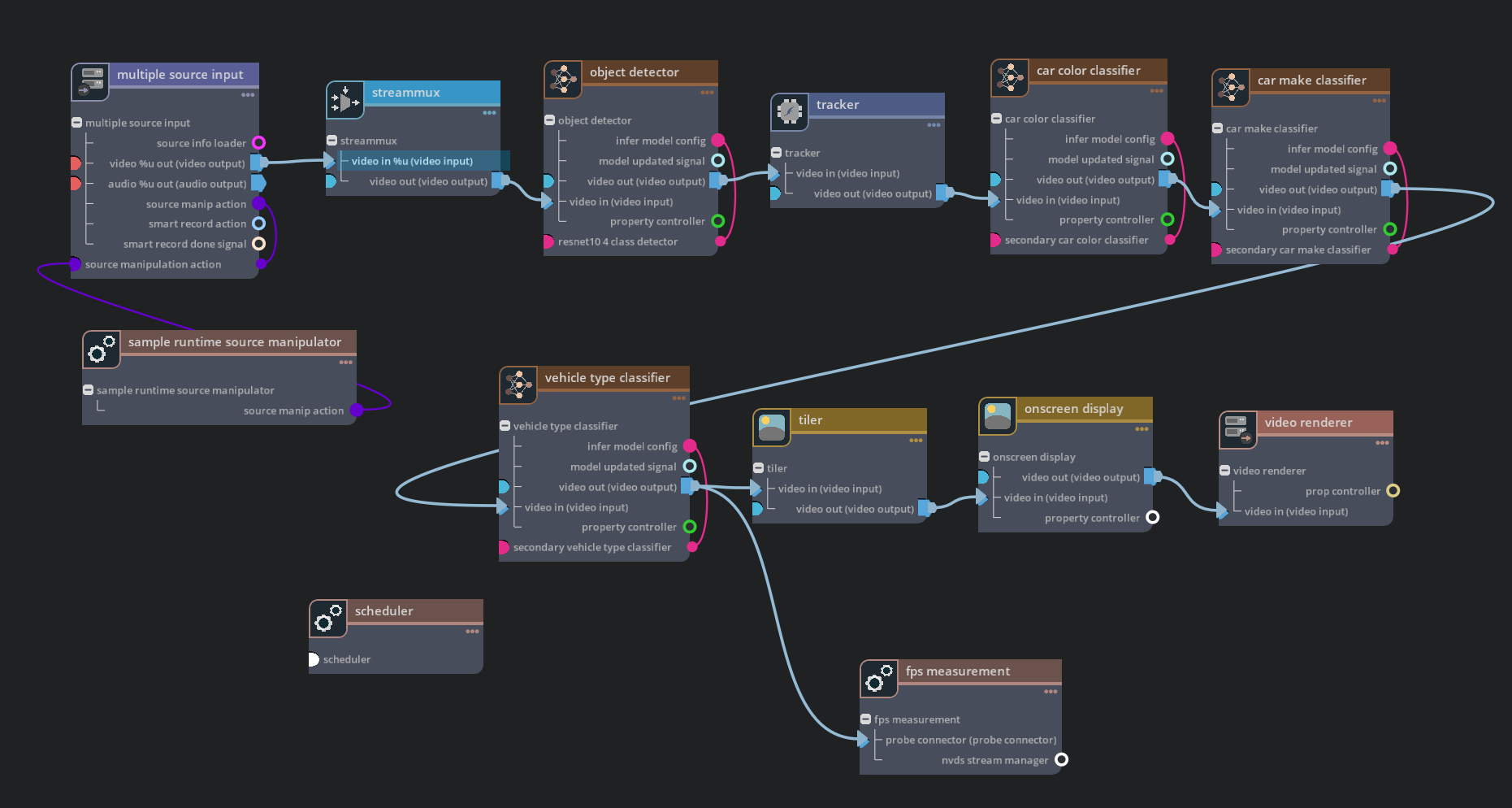

deepstream-runtime-src-add-del¶
Demonstrates how sources can be dynamically added/removed at runtime. Also, demonstrates the use of action/signal components. The “NvDsSourceManipulationAction” of “NvDsMultiSrcInput” component is used to add/remove the sources. This action is triggered by another sample component “NvDsSampleSourceManipulator” every fixed interval which can be configured. Or this action can also be triggered by an Http service “NvDsStreamManager” upon add source or remove source Http request.
Graph Files¶
deepstream-runtime-src-add-del.yaml – The main graph file
deepstream-runtime-src-add-del-as-a-service.yaml – The main graph file with stream manager service
ds_runtime_src_add_del_container_builder_dgpu.yaml - Configuration file for building application specific container for dGPU platform
ds_runtime_src_add_del_container_builder_jetson.yaml - Configuration file for building application specific container for Jetson platform
Path - /opt/nvidia/deepstream/deepstream/reference_graphs/deepstream-runtime-src-add-del
Sample Commands:
On x86:
$ /opt/nvidia/graph-composer/execute_graph.sh deepstream-runtime-src-add-del.yaml \
$ /opt/nvidia/graph-composer/execute_graph.sh deepstream-runtime-src-add-del-as-a-service.yaml \
* To add / remove a stream using a client on the same host
Add stream with id 1:
$ curl -X POST "http://localhost:8082/AddStream/stream" -d "{\"sensor\":{\"id\": \"1\", \"uri\": \"file:///opt/nvidia/deepstream/deepstream/samples/streams/sample_1080p_h265.mp4\"}}"
Add stream with id 2:
$ curl -X POST "http://localhost:8082/AddStream/stream" -d "{\"sensor\":{\"id\": \"2\", \"uri\": \"file:///opt/nvidia/deepstream/deepstream/samples/streams/sample_1080p_h265.mp4\"}}"
Until the max number of streams configured in NvDsStreamManager is reached
Remove stream with id 2:
$ curl -X POST "http://localhost:8082/RemoveStream/stream" -d "{\"sensor\":{\"id\": \"2\"}}"
Remove stream with id 1:
$ curl -X POST "http://localhost:8082/RemoveStream/stream" -d "{\"sensor\":{\"id\": \"1\"}}"
Until all streams are removed
On Jetson:
Graph¶
Sample Output¶

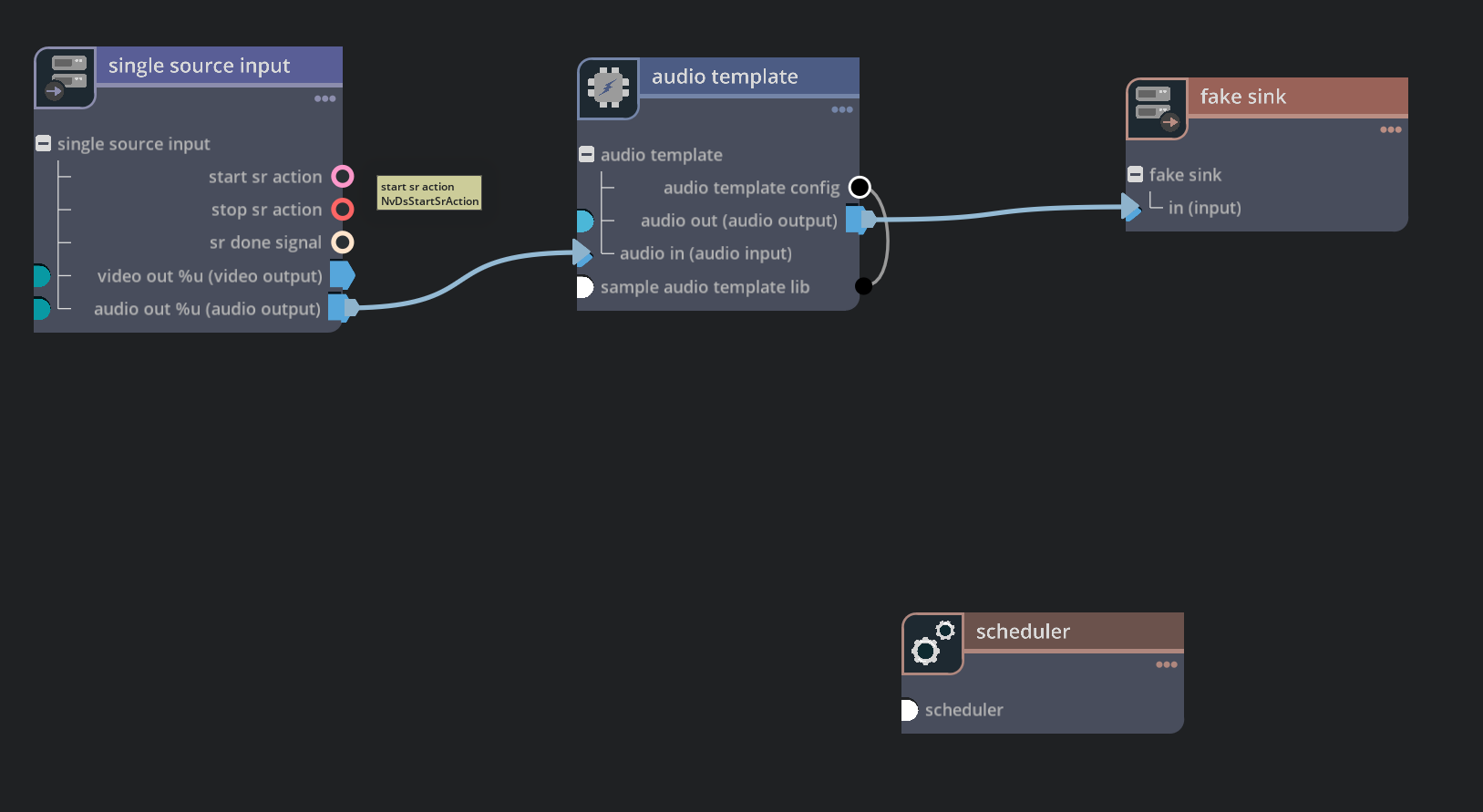

deepstream-template-plugin¶
Demonstrates the usage of configuration components used as configuration providers for other components. These graphs are meant to run only on DGPU platforms since the DeepStream template plugins are available only on DGPU platforms.
Graph Files¶
deepstream-videotemplate.yaml – Graph demonstrating usage of DS video template plugin and a configuration provider for the plugin
deepstream-audiotemplate.yaml – Graph demonstrating usage of DS audio template plugin and a configuration provider for the plugin
ds_audiotemplate_plugin_container_builder_dgpu.yaml, ds_videotemplate_plugin_container_builder_dgpu.yaml - Configuration file for building application specific container for dGPU platform
ds_audiotemplate_plugin_container_builder_jetson.yaml, ds_audiotemplate_plugin_container_builder_jetson.yaml - Configuration file for building application specific container for Jetson platform
Path - /opt/nvidia/deepstream/deepstream/reference_graphs/deepstream-template-plugin

$ /opt/nvidia/graph-composer/execute_graph.sh deepstream-audiotemplate.yaml \
$ /opt/nvidia/graph-composer/execute_graph.sh deepstream-videotemplate.yaml \
On Jetson:
Sample Output¶
The sample output consists of the input video scaled by “scale-factor” mentioned in parameters of NvDsSampleVideoTemplateLib component in the graph.
The sample output consists of the addition of noise specified by “noise-factor” mentioned in parameters of NvDsSampleAudioTemplateLib component in the graph to the input audio.
