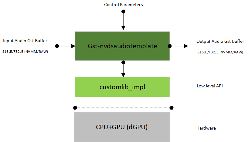

Gst-nvdsaudiotemplate¶
The OSS Gst-nvdsaudiotemplate plugin is a template plugin which provides a custom library hooking interface for single/batched audio frame(s) processing. Custom lib implementation may have algorithms to transform or process input buffers depending upon the use case. It can support S16LE and F32LE inputs. The plugin accepts batched NVMM HW and RAW SW buffers, and outputs batched HW and SW buffers.
Inputs and Outputs¶
Inputs
NVMM or RAW Gst Buffers. Supported formats are S16LE and F32LE
Control parameters
customlib-name
gpu-id
customlib-props
Output
Transformed Gst Buffer
