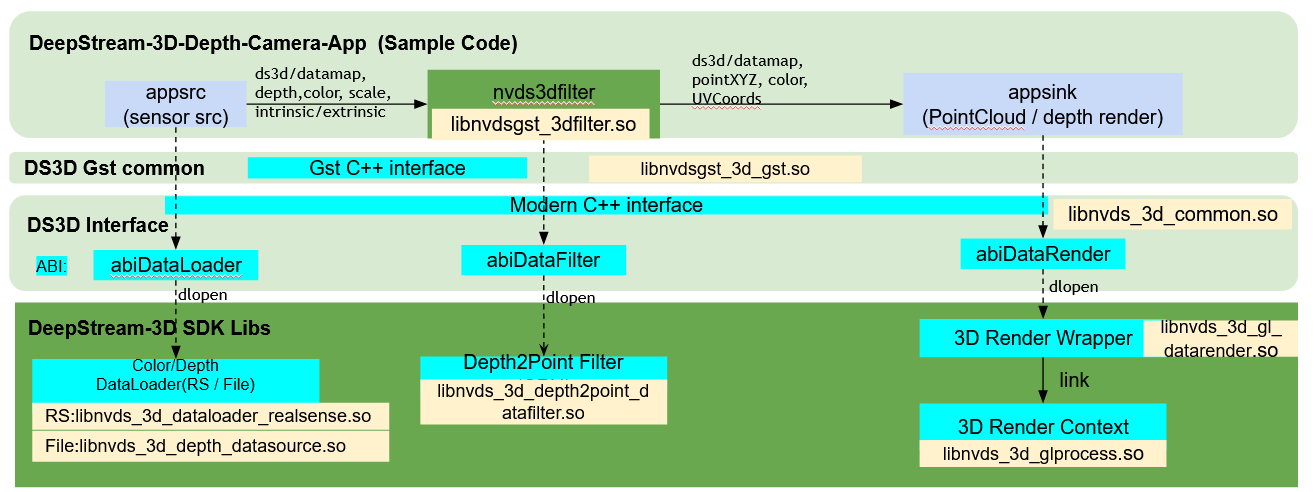

deepstream-3d-depth-camerais another example for ds3d pipeline.
The image below shows the overview of depth to 3D point processing pipeline in
deepstream-3d-depth-camera.![]()
See more details in the DeepStream 3D Depth Camera App.
