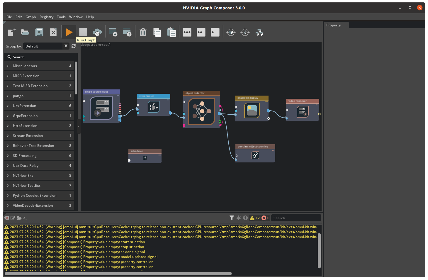

To execute the currently open graph, click on the Run Graph
button from the
toolbar on the left. This will open the Run Graph
dialog.
To execute on the same host system,
Make sure
gxf_server
is running on the local system and the IP address in the Edit/Preferences is of local host.Select appropriate Platform config file using the file browser.
Click on
Run
. The graph execution progress will be reported via logs in the console window.

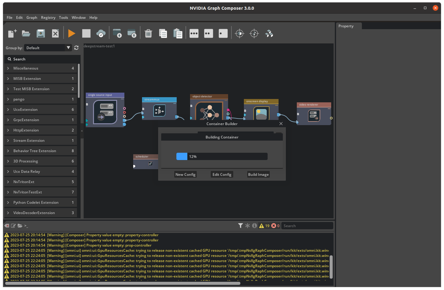

Build Container Image
1. To build a container, first click on the Build Container
button from the
toolbar on the top.
This will open the
Build Container

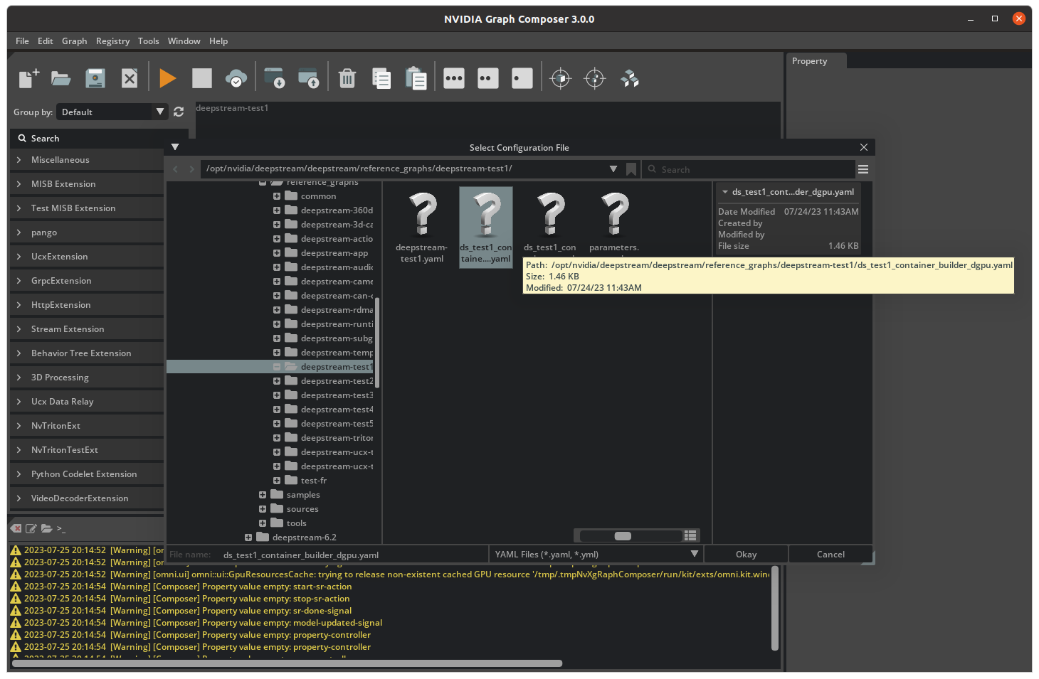

dialog. Launch the file browser using the button next to theConfiguration File
input.
Select a container builder configuration file and open it.
Click the button next to the
Platform config File
input to launch the file browser. Select a platform config file and open it.
Click on
Build

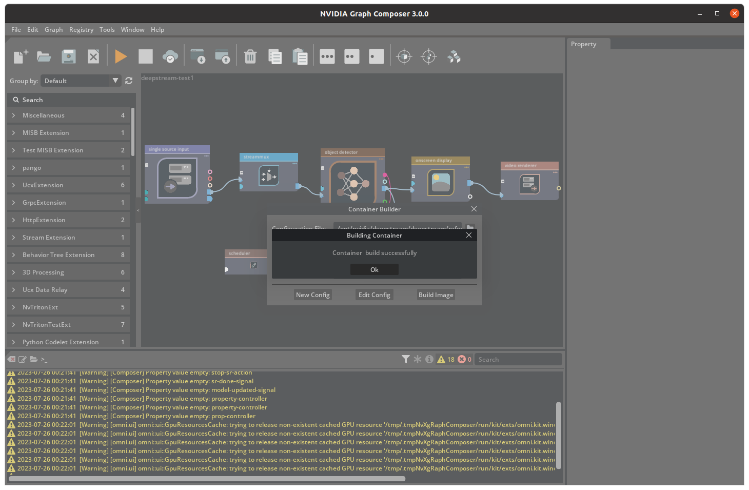

to start the build process. Composer reports the container build status using a progress bar.
On successful completion, composer will show a success message.
