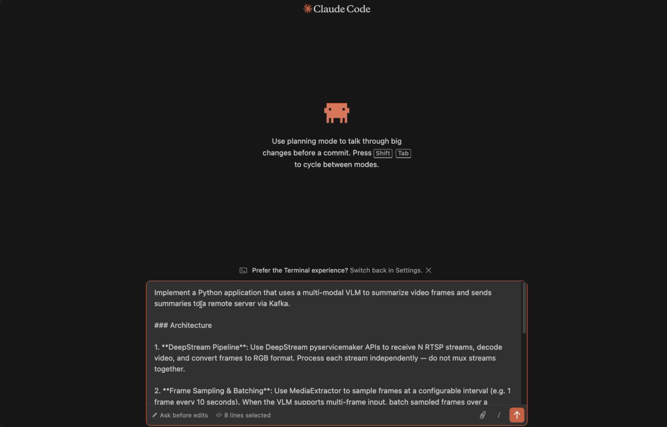

Prompt 4 — RTVI VLM Core App (rtvi_vlm_core_app.md), scalable multi-stream RTSP application with VLM-based video summarization and Kafka output:
Implement a Python application that uses a multi-modal VLM to summarize video frames and sends summaries to a remote server via Kafka.
### Architecture
1. **DeepStream Pipeline**: Use DeepStream pyservicemaker APIs to receive N RTSP streams, decode video, and convert frames to RGB format. Process each stream independently — do not mux streams together.
2. **Frame Sampling & Batching**: Use MediaExtractor to sample frames at a configurable interval (e.g. 1 frame every 10 seconds). When the VLM supports multi-frame input, batch sampled frames over a configurable duration (e.g. 1 minute) before sending to the model. Each batch must contain frames from a single stream only.
3. **vLLM Backend**: Implement a module that receives a batch of decoded video frames and returns a text summary from the multi-modal VLM.
4. **Kafka Output**: Send each text summary to a remote server using Kafka.
### Constraints
- Scalable to hundreds of RTSP streams across multiple GPUs on a single node. Distribute processing load across all available GPUs.
- Never mix frames from different RTSP streams in a single batch.
Store output in the `rtvi_app` directory.
Also generate a README.md with instructions to setup kafka server, vLLM, and how to run the application.

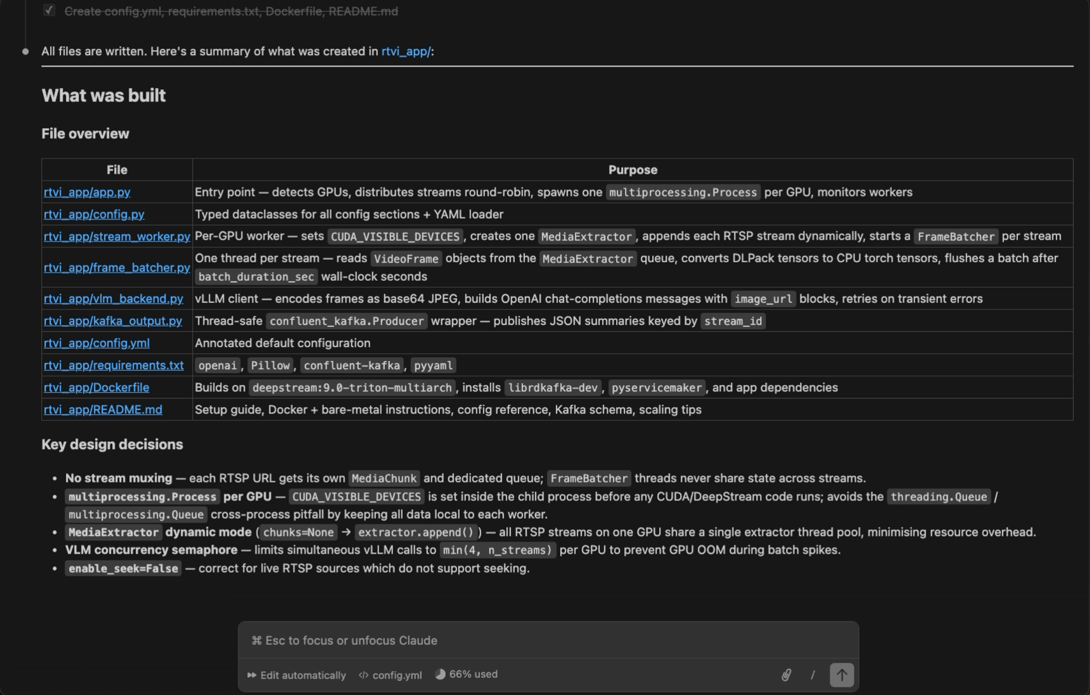

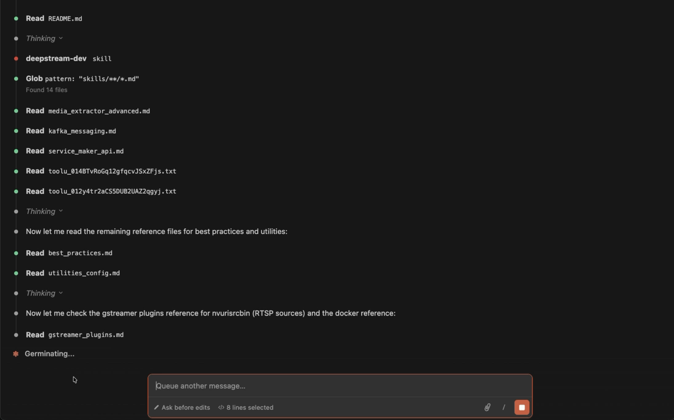

Expected Output#
When you paste one of the above prompts into the AI agent chat, the agent will:
  1. Automatically activate the deepstream-dev skill and consult the bundled reference documents.
    Skill Activation
  2. Generate a complete Python application using the DeepStream pyservicemaker API.
    Generating Application
  3. Save the generated code in the directory specified by the prompt.
    Generated Code
Each prompt produces a self-contained project directory with the following structure:
Prompt
Output Directory
Key Generated Files
Video Inference App
video_infer_app/
Main application script, inference config file
Video Object Count App
video_object_count_app/
Main application script, inference config file, probe callback for counting
Multi-Stream Tracker App
multi_stream_tracker_app/
Main application script, inference config file, tracker config file
RTVI VLM Core App
rtvi_app/
Main application script, inference config file, vLLM backend module, Kafka producer module
The generated application is ready to run on a system with DeepStream SDK installed. For complex prompts (e.g., RTVI VLM Core App), the agent may take several iterations to produce all the required modules. Review the generated code in the diff view, accept or reject changes, and ask follow-up questions for refinements.
