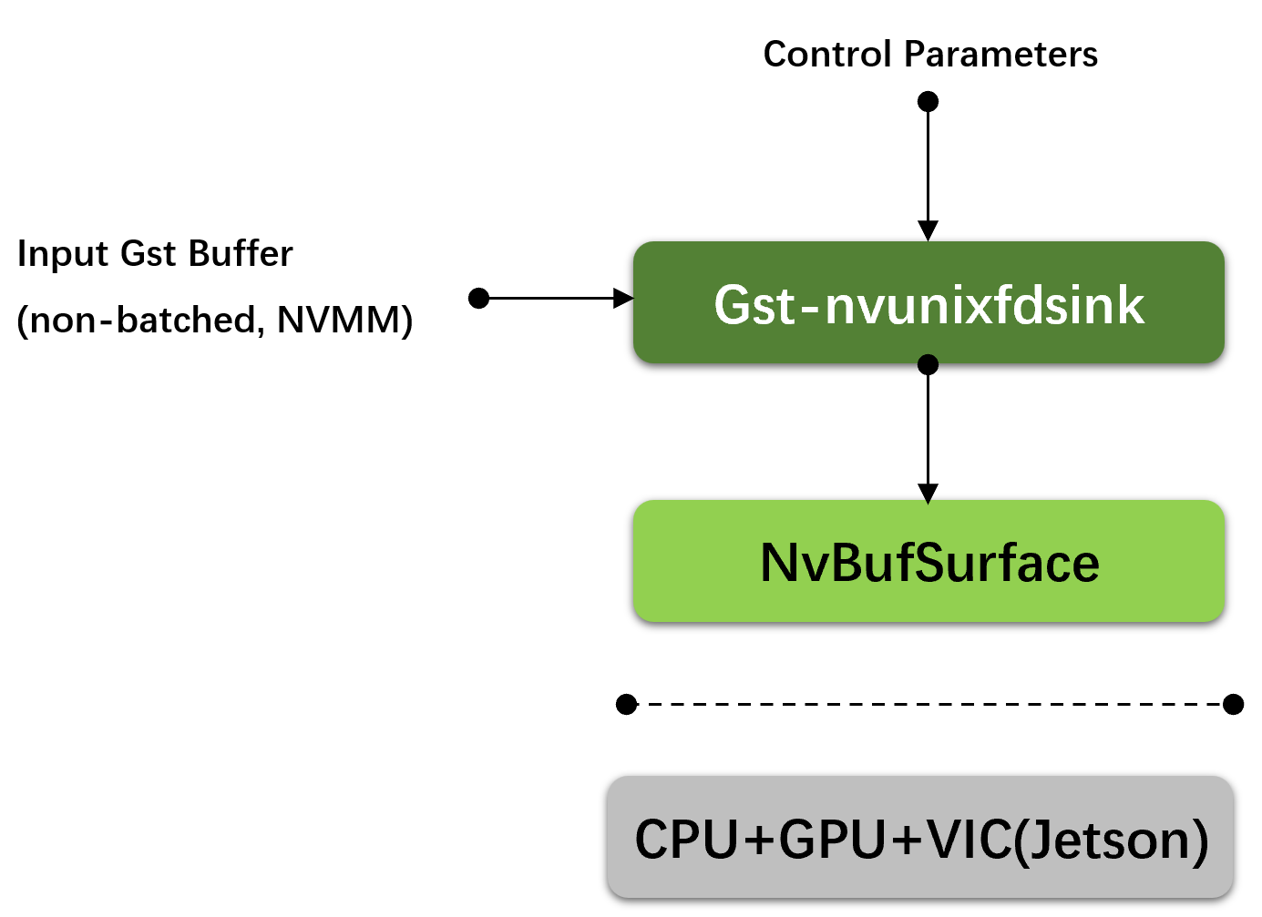

Gst-nvunixfdsink#
Gst-nvunixfdsink is a Unix file descriptor sink derived from OSS unixfdsink element, which is used on server side.
Inputs and Outputs#
Inputs
Gst no-batched buffer
Control parameters
gpu-id: selects the GPU ID
buffer-copy: copy buffer for every client
buffer-timestamp-copy: copy timestamp of the received Gst buffers
compute-hw: Compute HW for copy operation
meta-serialization-lib: Set meta serialization library name to be used
socket-type: The type of underlying socket
socket-path: The path to the control socket used to control the shared memory
Output
After client connects, server passes the NvBufSurface handle, timestamp and other data to client through IPC.

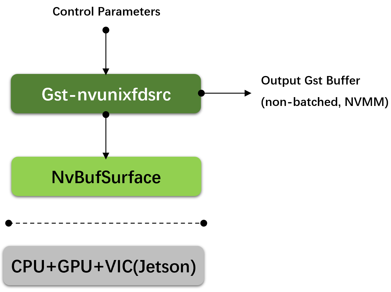

Gst-nvunixfdsrc#
Gst-nvunixfdsrc is a Unix file descriptor source derived from OSS unixfdsrc element, which is used on client side.
Inputs and Outputs#
Inputs
The NvBufSurface handle, timestamp and other data received from server.
Control parameters
buffer-timestamp-copy: copy timestamp of received buffer
meta-deserialization-lib: Set meta deserialization library name to be used
connection-attempts: Max number of attempts for connection (-1 = unlimited)
connection-interval: Connection interval between connection attempts in micro seconds
Output
Features#
